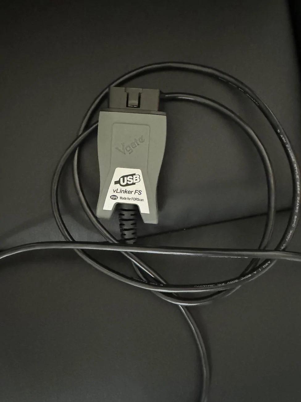

A friend of mine is a mechanic and has FDRS and some type of adapter(I don’t know if it’s a mongoose or not, never paid that close of attention) that I have used before! I purchased this adapter to use forscan to reprogram a back up camera on my expedition-I don’t know if it would work with FDRS-I just hate to bug him about things that I can do myself with the right equipment!
That is the same adapter I have for FORScan, but that will not work for FDRS module updates.
That is kind of what I thought. Thank you for the info. I will look into getting a mongoose! any good deals you know of?

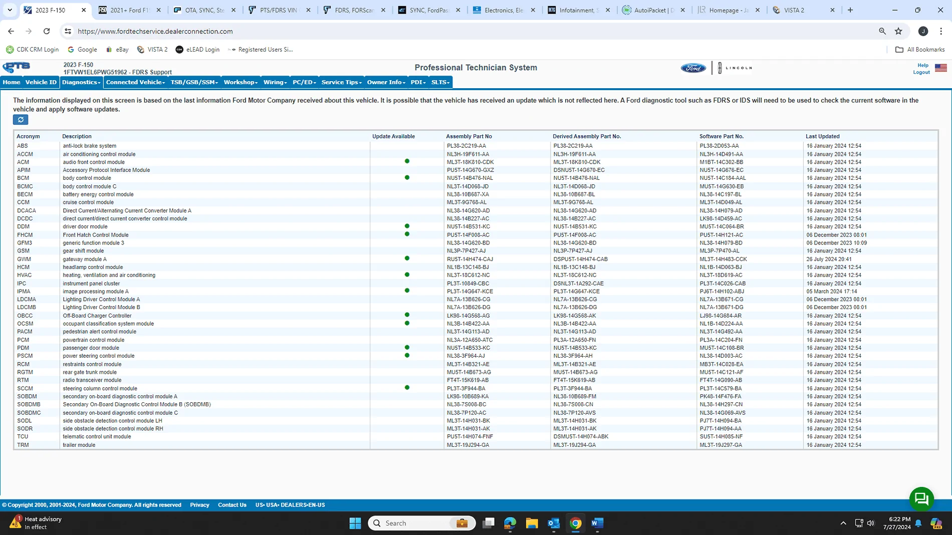

Just bought this 2023 so wondering how behind it is 1FTVW1EL6PWG51962
It's on Sync 23159 which is one version behind the latest one. Modules pending updates are below. Once that GWM you see there is updated, it will release more updates for other modules that are not showing an update pending now since some updates are installed sequentially.
Thanks for the info. Assume FDRS for the Lightning is the same as my Mach-E. Does all the last updated 16 January 2024 dates mean that's the date the truck was assembled? From the window sticker I can see the blend date was 12/7/2023.
No, that was the last time those modules reported their current status to the server.
