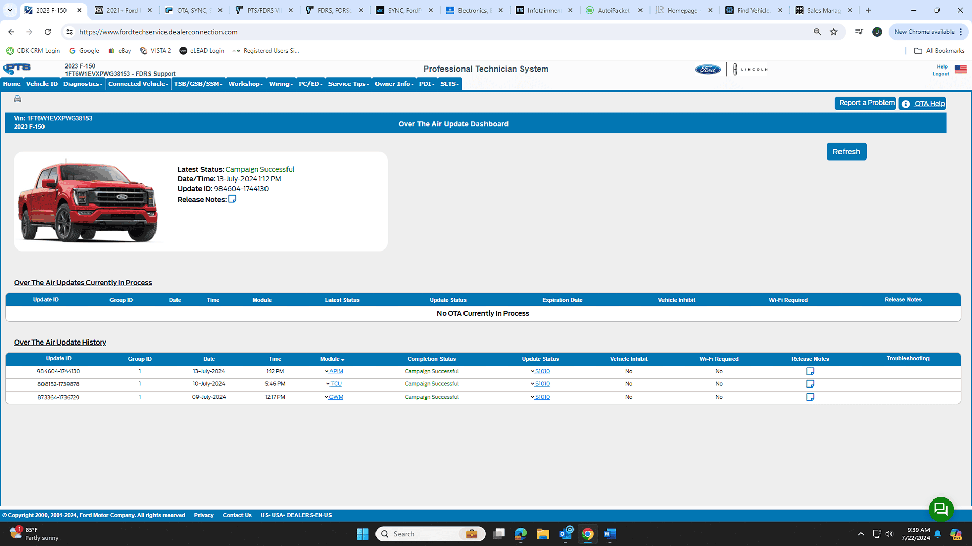

Can you check 1FT6W1EVXPWG38153 ?
I got 4.2.1.1, 4.2.1.2, then digital owner's manual OTA on consecutive days about a month after purchase. No other updates since.
Trying to figure out if anything is else has been queued but isn't downloading / installing.
Thanks!
Nothing else has been sent. Three updates in 4 days is more than normal. I would consider myself lucky and not get used to that

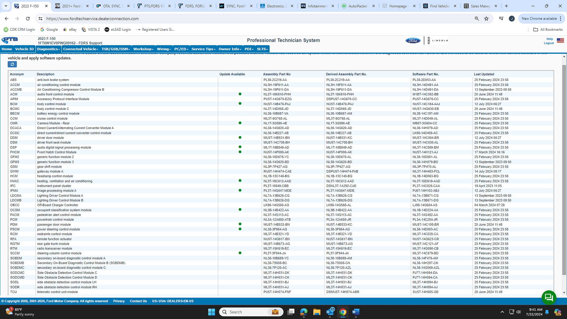

Truck is on the latest Sync version, but is pending updates to many ancillary modules. Modem is working fine and the truck is talking to the cloud. Last OTA was ECG-24.2.4.9 on 6/20.

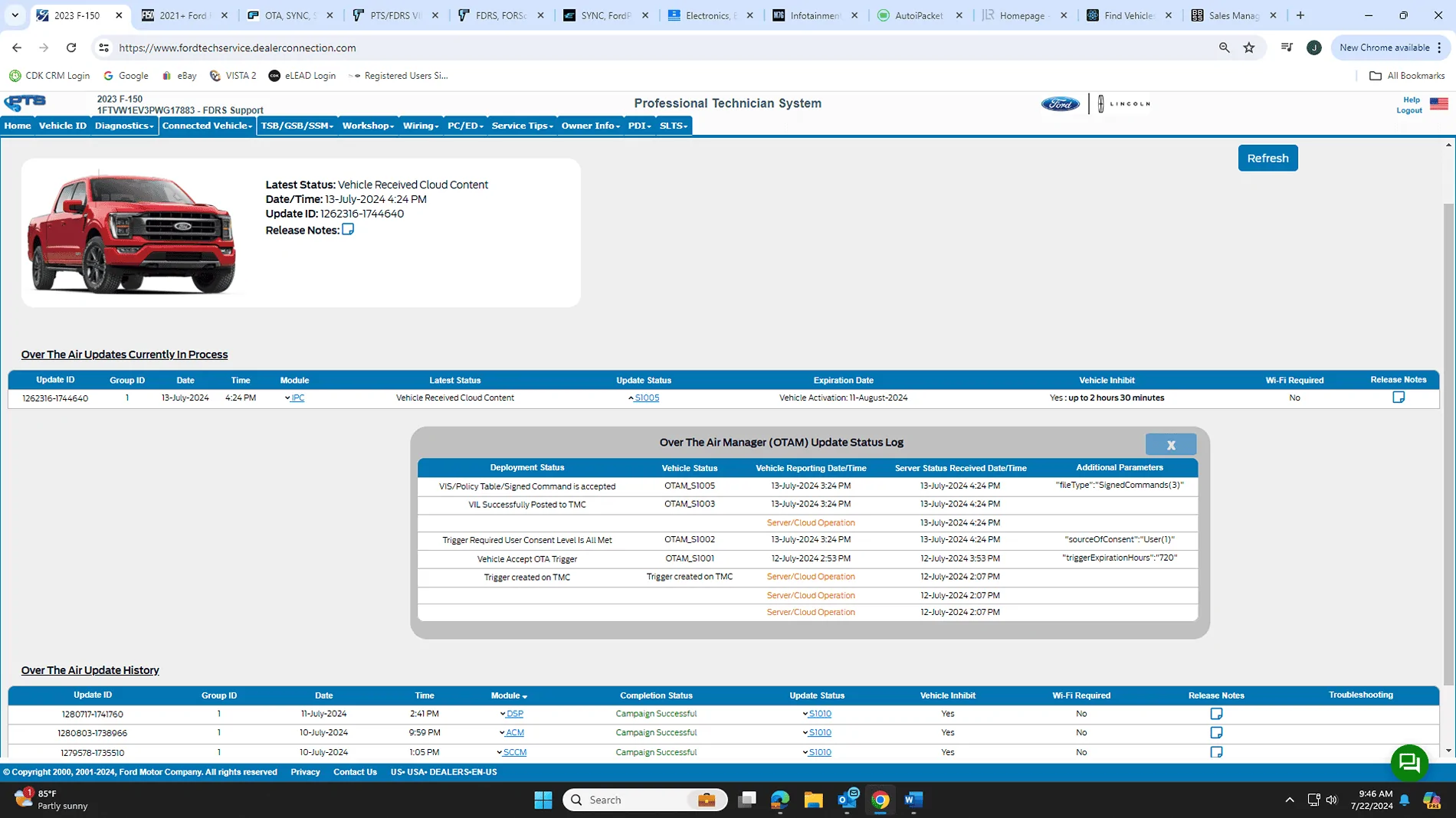

Thank you for offering this.
If you get time....
I have message of"
"Ford Power-Up 6.8.0
Not Completed"
This has been there for about 10-14 days.
Up until now I have had updates go through without a problem, in fact for the 3 weeks leading up to this I had about 4 or more updates with 2 in one day.
VIN:1FTVW1EV3PWG17883
Thanks,
"Not Completed" usually means the OTA failed for some reason. However, in your case, it appears the OTA trigger is still active. If when you try to install it manually, it does not let you, then something happened between the handshake between your truck and the mothership where your truck thinks the OTA failed. I'm afraid you aren't going to be able to do anything but wait for the OTA to expire on the server side and then wait some more for it to be resent.

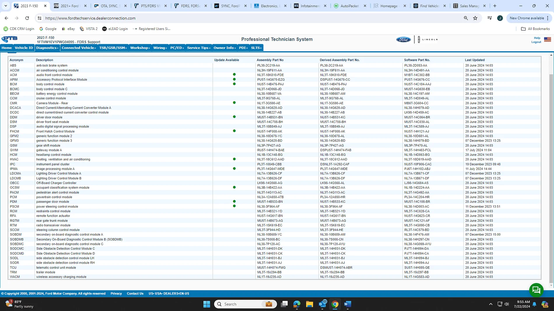

A check for 1FTVW1EV1PWG04095 is much appreciated. Got the battery sensor csp done and I got a few minor updates no power up for months. Thanks in advance.
Truck is on the latest Sync version and last OTA was ECG-24.2.4.9 on 6/21. Modules with pending updates are:

So, because I’m not as savvy in understanding these things, what do “pending module updates” mean? Will those be updated automatically the next time an OTA happens? Do I need to ask for this at my service appointment? Thanks for the assistance!
rugedraw
rugedraw
Javier
Dec 14, 2021
1,480
1,683
Miami
2021 Ford F150 Platinum FX4 EcoBoost; 1990 Ford Mustang LX 5.0 coupe
Auto Sales
With the exception of the WACM, all the other modules with the green dots that have pending updates can be updated via the OTA process and eventually will. It will not be one update, though....it will be many and you can go days, weeks or months without getting one.
The dealer will not help. Ford does not pay them labor hours to update modules just because they aren't up to date. The dealer will only do updates if they are tied to a recall or if they fix an issue.

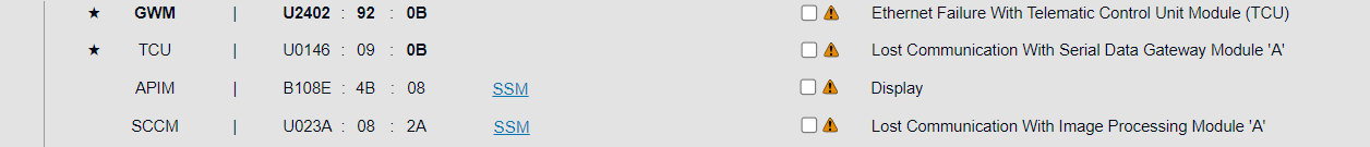

Your truck is on Sync 22326 which is pretty old at this point. Also, your truck is reporting some codes of concern. These lost comm and ethernet failure codes between the TCU and GWM are not normal. Not getting an update for almost a year and a half is also not normal. I think a dealer visit may be warranted in your case. I can't say for certain this is why you haven't gotten any updates, but these codes are a red flag to me.
The APIM code being reported below is tied to an SSM that says if you are having issues with your touchscreen blacking out, the entire screen needs to be replaced.

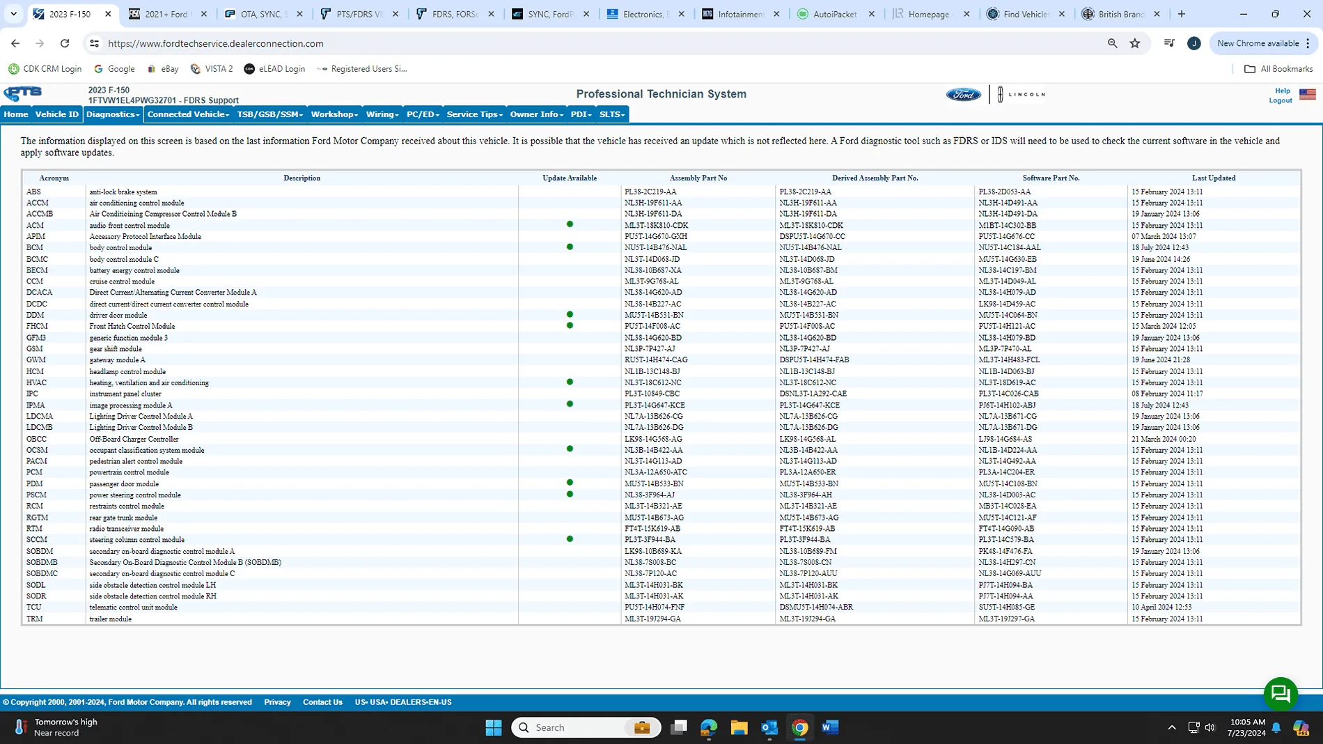

Hi Rugedraw,
My last update was June 20th, something about a connectivity improvement, which to honest wasn't much of an improvement, can you see if there was one after that? I have no idea if i had the latest update.
VIN: 1FTVW1EL4PWG32701
Thanks.
rugedraw
rugedraw
Javier
Dec 14, 2021
1,480
1,683
Miami
Auto Sales
Hi Rugedraw,
Thanks.
Last OTA was ECG-24.2.4.9 on 6/19. Your truck is on the latest sync version and modules still pending updates are below:
