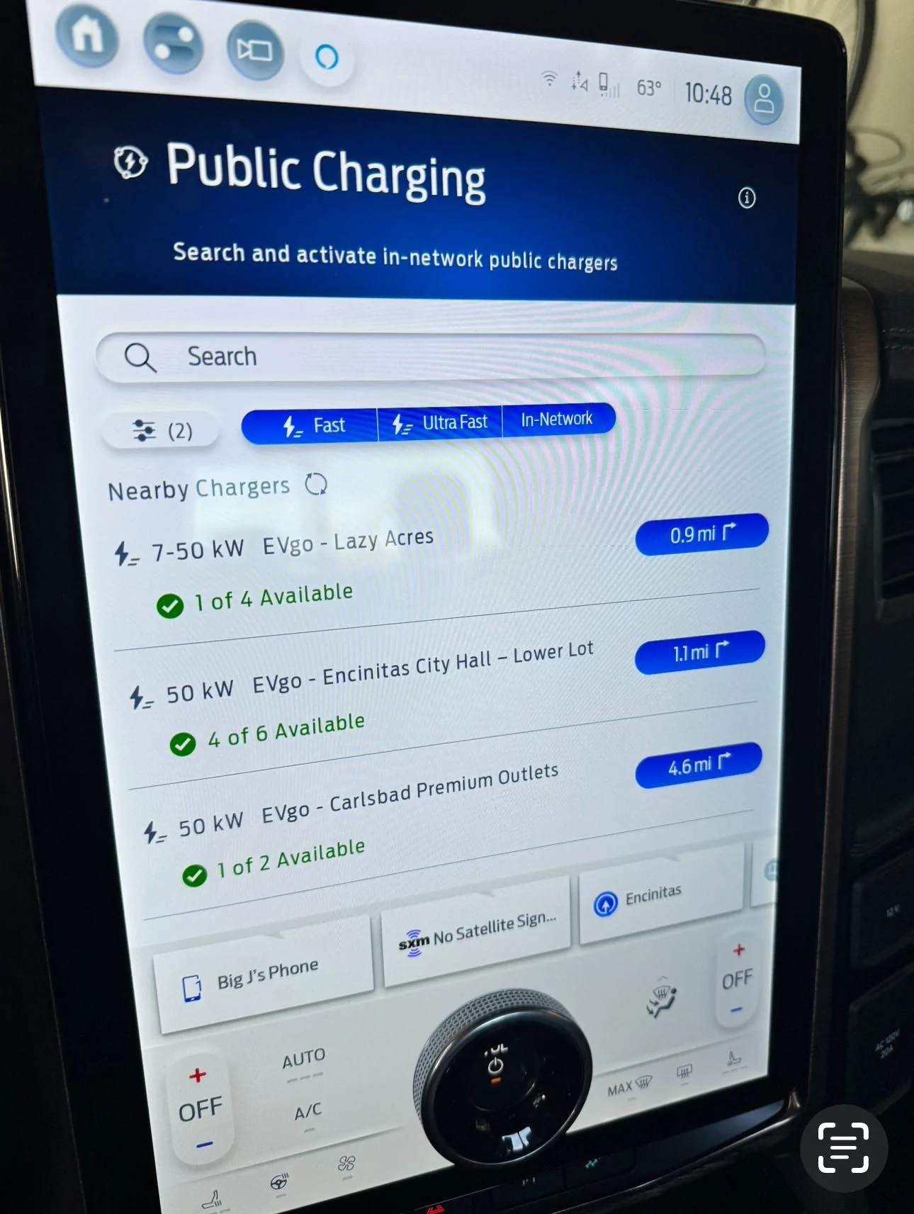

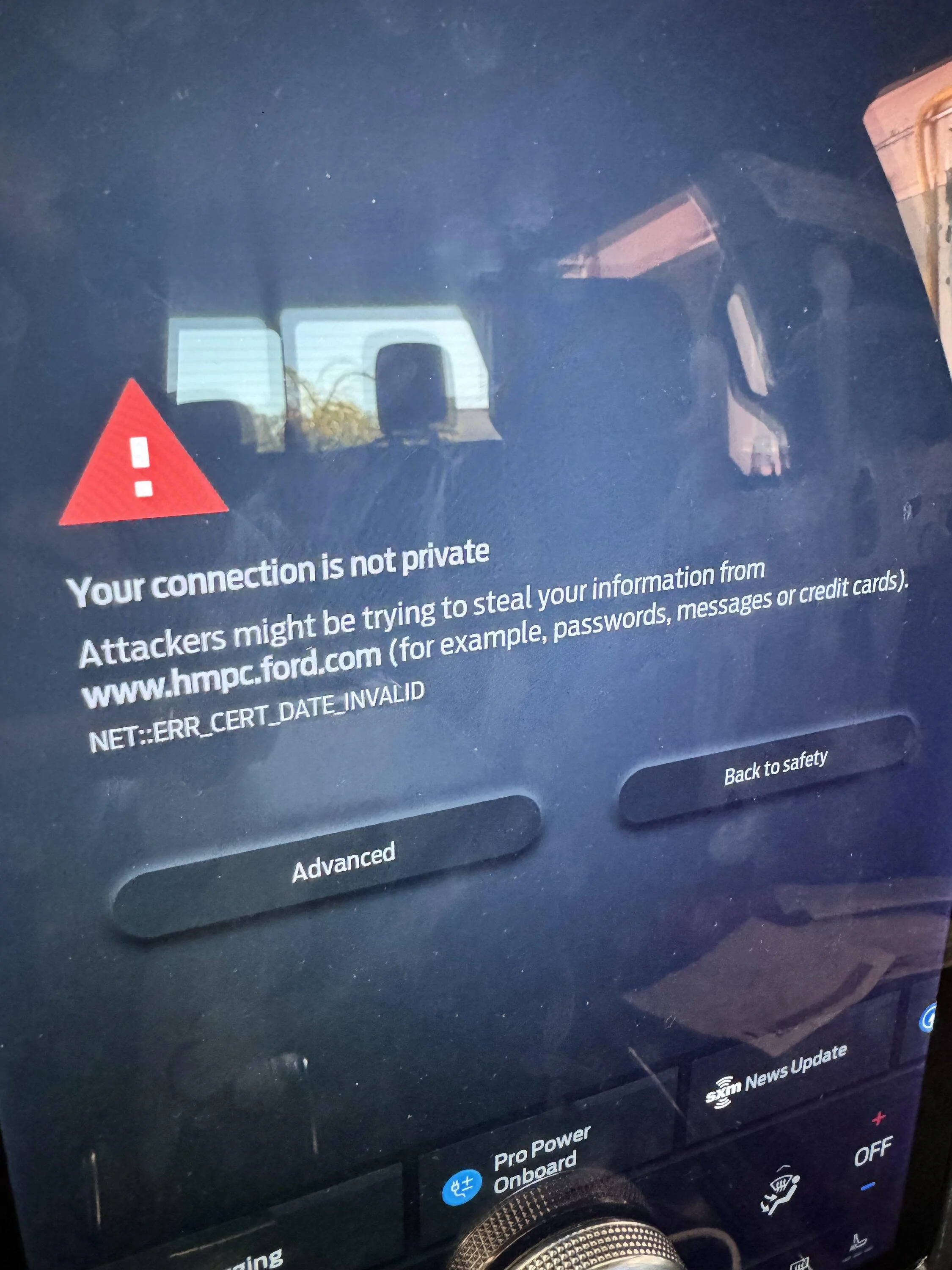

Ok. Here is the update..
1. I spent time with Ford today to troubleshoot the SW issue I was having with my charge assist app button not working.
2. Did soft reboot of vehicle and it did not immediately fix the SW error issue
3. As I was pulling into the garage it worked for a second see attached.
4. the. I got same error again after
5. Electrician came over and checked the circuit breakers and amp flow pulling from the vehicle (was pulling little over 30) so all good and didn’t trip the breaker
6. So now the hypothesis, did the sw soft reboot to fix the charge assist app actually fix something else that was causing my vehicle to pull more amps (like it was thinking it was still at a DC fast charger (like ev go) and the SW rest “reset” to acknowledge it was now only pulling from the Ford Mobile charger on 240v
7. Will we ever know without any vehicle logs?
8 and yes to the previous post I was smart enough not to have any other appliances or high amp things running. 🙏
9. So now have to call Fors again to see if they can still fix my other issue which is the error message and charge assist app not working. It’s now blank with no error.
The two charging rates are not connected. Level 2 AC charging is done with the truck's onboard AC to DC charger. DC fast charging is controlled by the external DC fast charger regulating the rate. It's impossible for to have anything to do with the other.
That being said, if the truck's level 2 onboard AC charger was confused about something (super technical explanation), and was attempting to pull more than it should through your mobile charging cable, that would explain a great many things.
If rebooting the truck made the problem go away, and the electrician confirmed everything appears secure and working as intended, sounds like problem solved.
