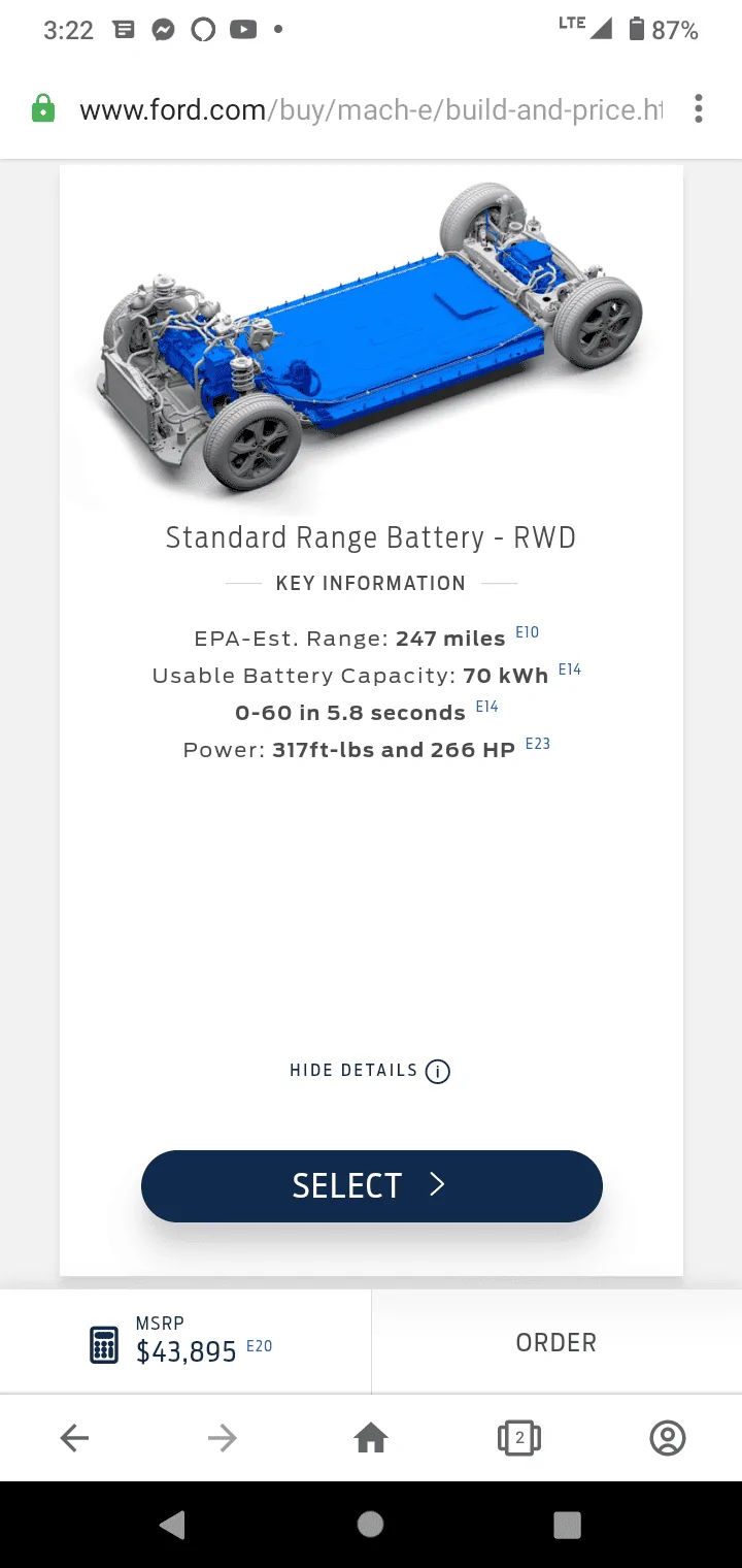

I can't speak to cold weather but a SR MachE can make that commute with over 20% to spare starting out a 90%. We do those types of trips once or twice a week without blinking.
In the winter I imagine if you precondition before unhooking in the morning you would be good. As for doing it in an F150 we just do not know but overall power used is sure to be higher.

Cold weather will take up to 40 percent of your range, so using your numbers you wouldn't make it.
Garbone
Gary
Nov 20, 2021
92
126
FL
21 MachE, 22 MachE, 1962 C10 long bed
A 22 SR RWD would.
Sadly Ford will not be unlocking more buffer on my 21.
I would go to 100% in the winter months. To be safe.
