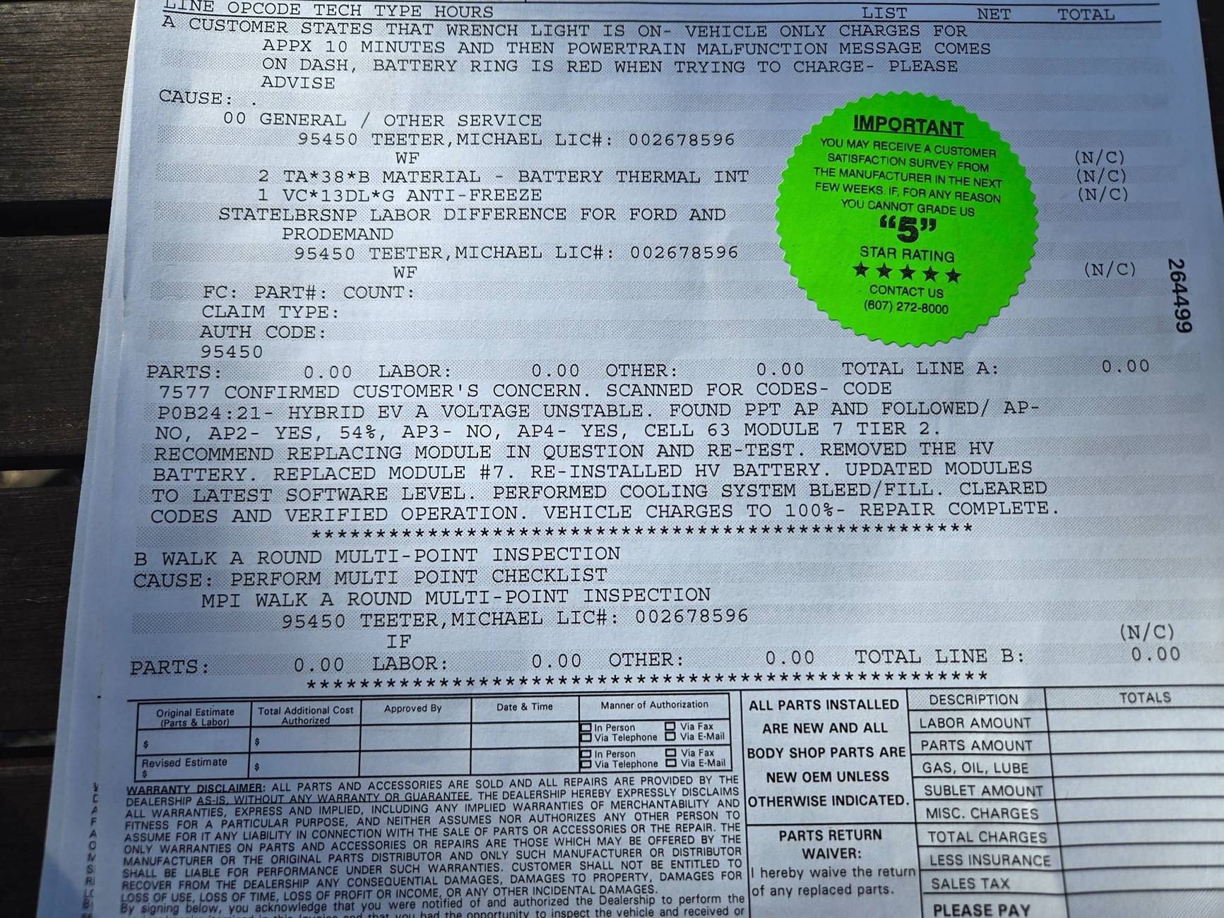

Update. Just picked up my truck. Was at the shop for 3 weeks exactly....above pic is the service performed.
If they didn't L2 charge your truck for you for at least a few hours, when you plug it in, you're likely to have a ton of air in the coolant loops. Keep an eye on it and bring it back in for a top up. You'll hear it about 90s-2min after plugging it in when the pumps run the first time.
I had my battery out 3x... each time, the truck had to go back within weeks after drinking the reservoir dry.
