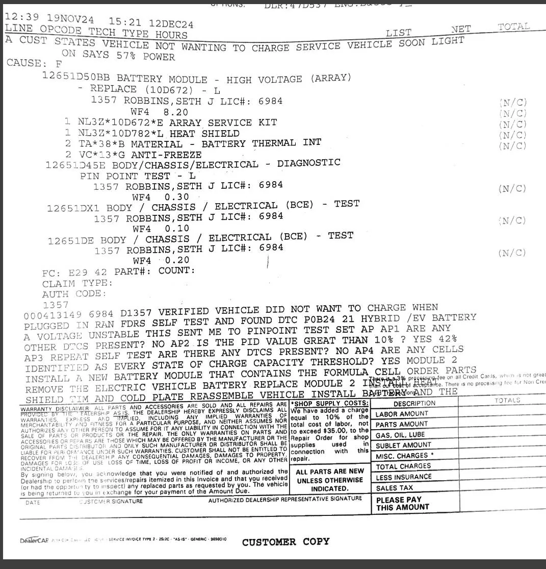

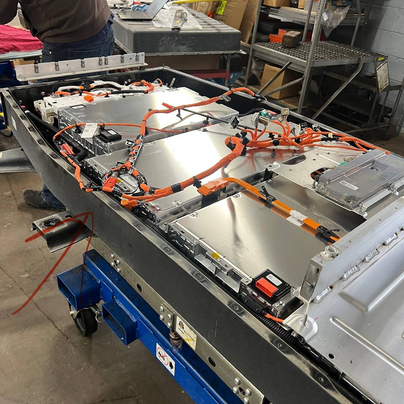

They did give me some pictures of the truck tore apart. The big one in the middle is what was replaced. I can't tell if the paperwork specifies which one it is.
Well I did pull your list this morning and that's why I mentioned the stuff they didn't do. I know you can do most of that stuff yourself but getting them to do the BCM so you'd have walk-away-locking would be a plus. You can't do that one.
I'm sure this was the first battery replacement they have done and it was time consuming. They weren't going to do anything more than they had too. That would have been nice though.

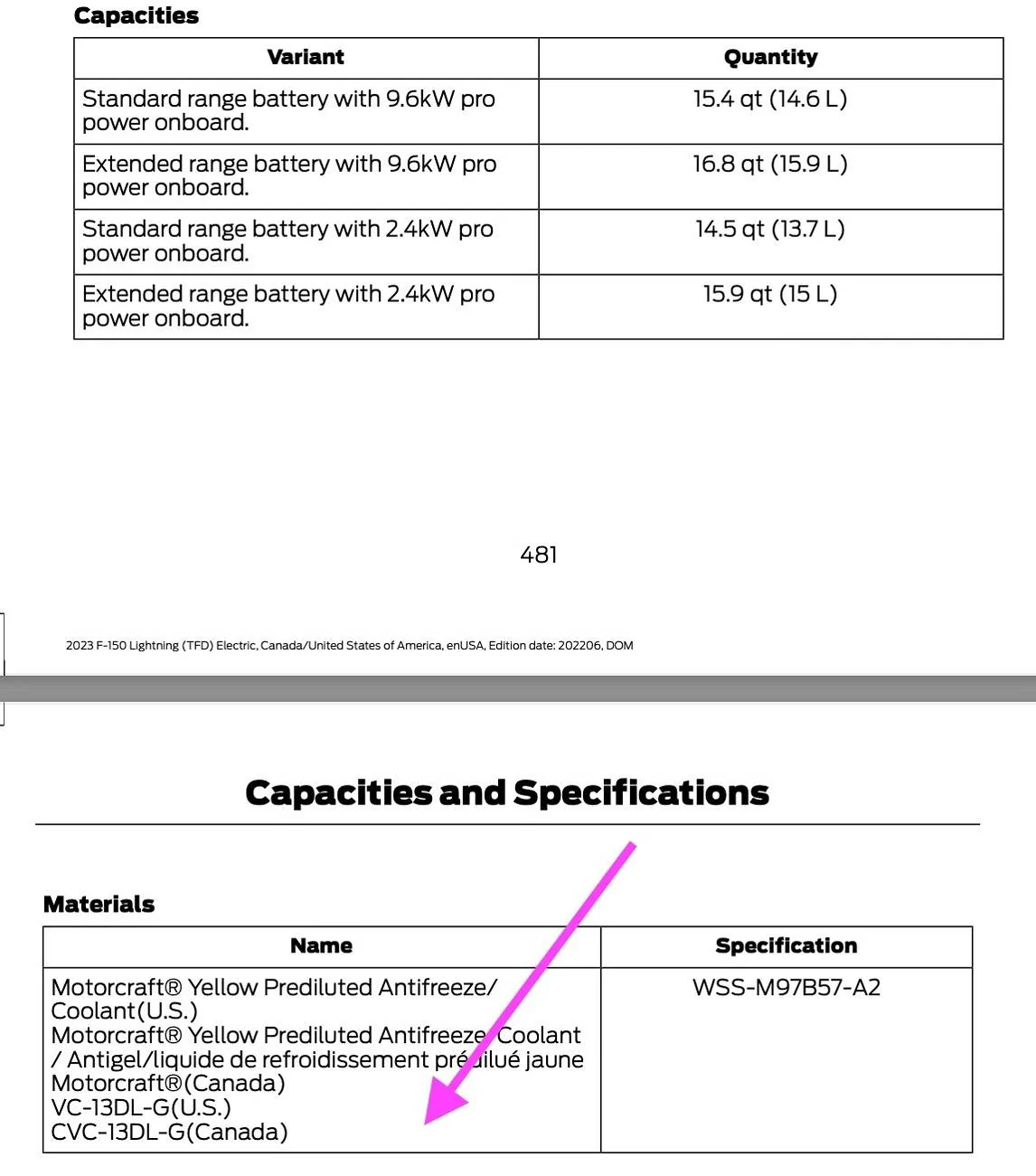

Well, I went out to the truck this AM (just got it back from the dealership Wednesday after a module 8 replacement) and it’s showing a power level maximum of 91. Checked the coolant reservoir, and it’s virtually empty. Is that specially formulated? Dealership service closed until Monday, and probably 2 week wait to get an appointment to put coolant in it…
Grumpy2
Nov 23, 2022
1,039
1,113
Central Oregon Coast
23 F150 Pro SR
Retired Hvy Construction
The proper coolant can be bought at most auto supply stores.
Motorcraft Gold Prediluted Antifreeze/Coolant VC-7DIL-B
Grumpy2
Nov 23, 2022
1,039
1,113
23 F150 Pro SR
As you top off the reservoir, it is good to leave it midway between the two marks to allow for expansion when it warms up. It may take several days for all of the air to work out of the system.
Srh9
Nov 15, 2022
SC
F150 Lightning on Order

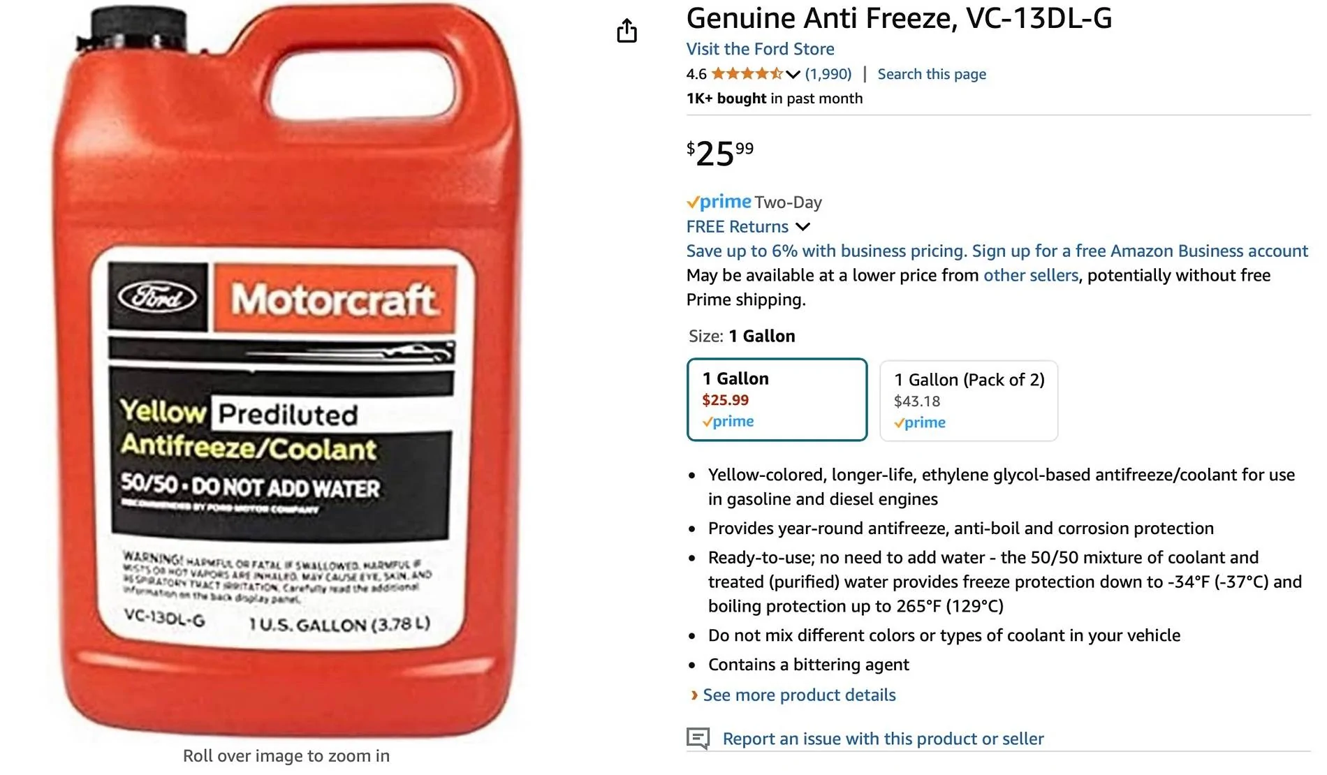

Looks like no one around here carries it in stock.
mrau
Feb 2, 2024
392
543
23 Lariat⚡ER
@Srh9 , Amazon does sell it as well.
The owners manual list part # VC-13DL-G
