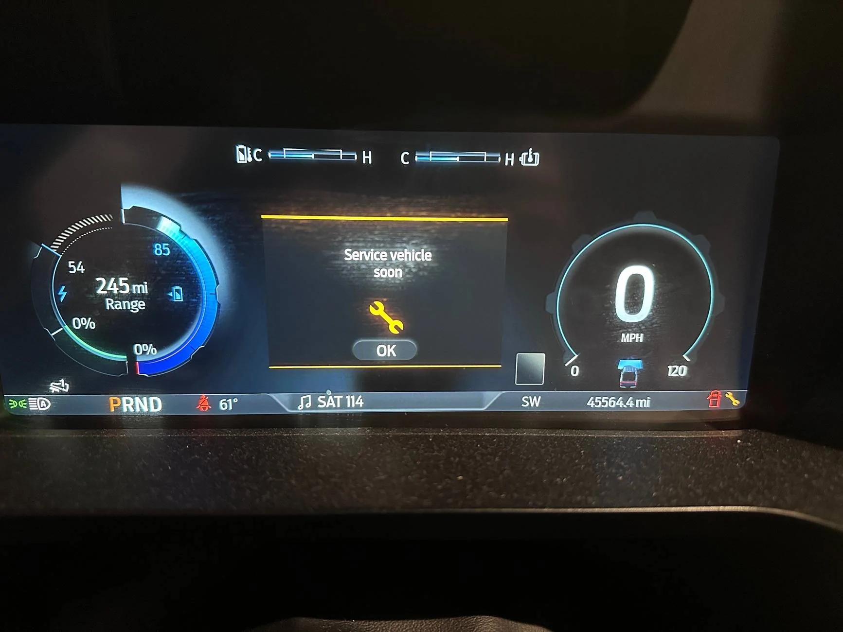

I’m at 43,111 miles and received the service soon. Battery won’t charge above 63%. Appointment with dealership scheduled. 🤷‍♂️

I got my truck back on the 17th. After it sat at the dealer with nothing happening for weeks, and after getting a new specialist assigned because the first one went on leave, it finally got escalated to Ford for repair. From what I'm told, what they did was.... re-seat the connectors. So.... they unplugged it and plugged it back in again.
At this point I'm just happy to have my truck again. I've put ~1500 miles on it since and everything seems OK. Except that I've had to fill the coolant a few times and it still gurgles like crazy when it's charging - so I assume I'll have to fill it a few more times until all the air comes out.

Some modules need replacing but as of 1/11/25, the dealership has no idea when they will be available. Reduced power error showed up yesterday as well. I asked for loaner since the truck now won’t charge above 54% (previously could charge to 67%).
They said at 47k miles a loaner is not covered but they escalated my request.

Kindly remind them that the battery is under warranty for 100k miles/8 years. Hopefully the BEV team will help nudge the dealer to cooperate.

Naturally I just got the "service vehicle soon" and went looking. I'm at ~32,200 miles and I know it'll be covered, but still a bummer. Local dealer can't get me in for 2 weeks, but seem to think they'll have it done in a day... After reading this, I can't say I'm too hopeful.
I noticed a few posts here with codes being read, is that using an off the shelf OBD2 reader? Phone app? Is there a forum favorite?
I trust my local dealer, but I'd like to be able to verify what they say and if think a code ready is a good first step...
