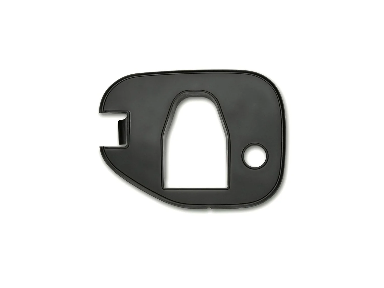

Another Update here:
I Drove to a dealer with 3 miles to spare….
Diagnosis:
Door needs replacement.
@ 8,500 miles.
Not Good.
Is it a ticking time bomb design? Only a matter of time until it fails, and then hopefully you’re not stranded with no way to charge up the truck ? Until then you can feel safe and sound and unaffected…..until it happens.
Maybe I just got a fluke bad door, but it seems that I’m far from alone on this site in having issues with this charge port door.
Seems Way too complex for such a basic but critical function.
Does make we wonder why Ford wouldn’t go With a Simple Tesla style hinge close that would never fail like this locking plunger mechanism doohickey.
so the part is on order, maybe a week, and until then I’m back up and running with a fully chargeable truck,
albeit with a charge port door popped open until a new one can be installed.
Sort of feels like the truck is driving around with it’s fly down
(and it’s caught the attention of more than one driver passing by pointing it out🤭 )
Diagnosis:
@ 8,500 miles.
Not Good.
Lightning 1.0

If they went the Tesla route then you would be complaining about the same thing:ROFLMAO:
https://teslamotorsclub.com/tmc/threads/frozen-charger-door.288941/
thanks for the link.
interesting read, especially the part where they discuss the solutions Tesla has offered up:
1.The charge port is now heated, just turn on vehicle defrost or max windshield defrost (press twice for windshield defogger/defroster icon to change from blue to red.) The vehicle displayed within the Tesla app will indicate when the charge port heater is active.
2. A simple credit card trick will pop open their charge port door!
I do love the simplicity of solution # 2. Their door design is so simple, a hinge with a spring, that even if it does freeze, something as common as a credit card can open it up. That’s a pretty small tool kit to need 😁.
the locking plunger doohickey could not be nudged open with a credit card for sure.
It “locks” shut, so it’s not a matter of nudging it free of ice with a CC.
In my predicament, over a hundred miles from home on a stormy Sunday night, I was tempted to take a screwdriver or crowbar to it, but figured that would move it out of a warranty repair, into a “me damaging my truck” and paying to fix it.
Gotta love the heated solution of #1 also.
More involved there, but it shows that the critical function of charging an EV made the list of improvements eventually, right up there with seeing out the front windshield 😉.
Hopefully Ford is thinking about doing something similar.
And maybe also simplifying the door to give us a better shot at opening it ourselves when Mother Nature strikes.
