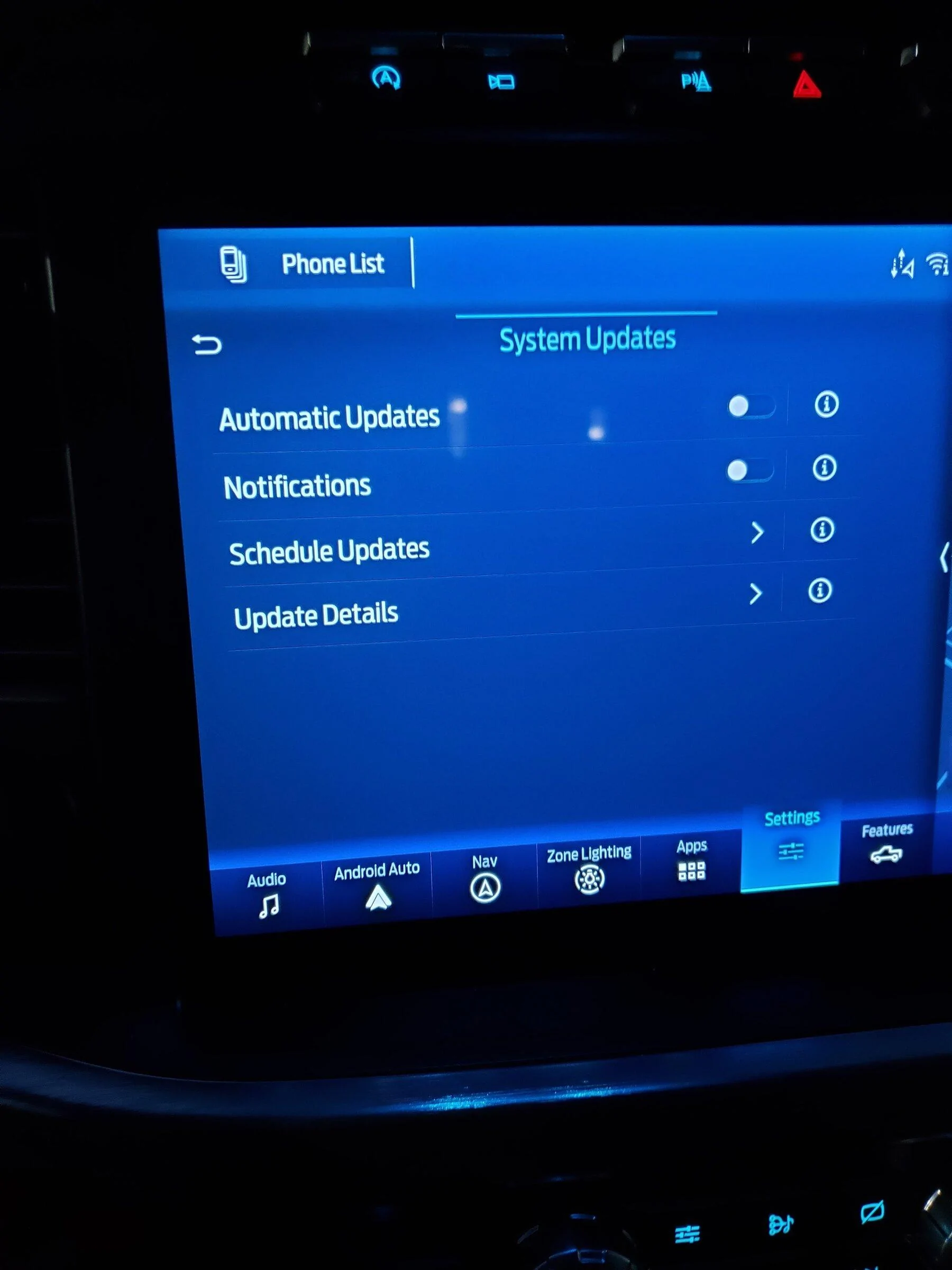

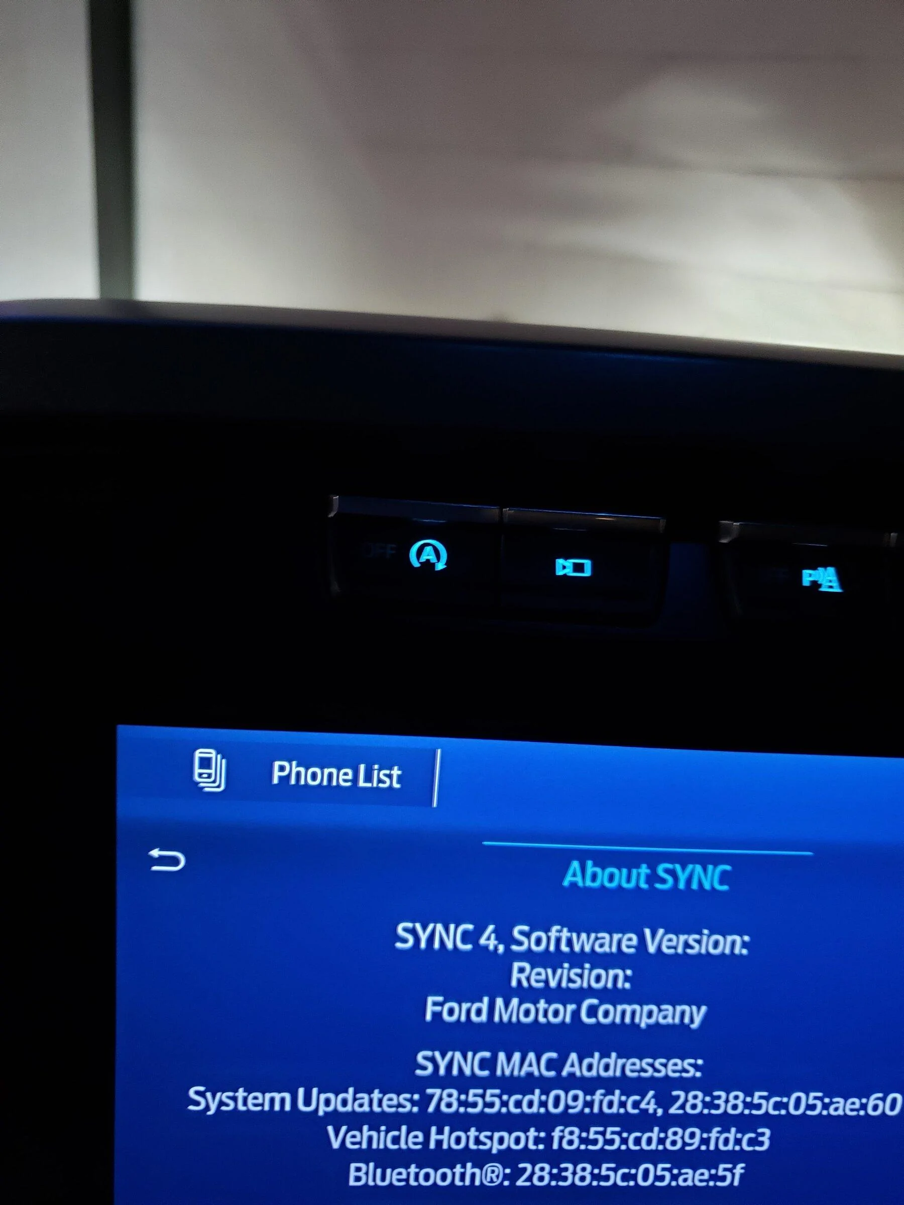

Same thing here.
Toggles changed to "off" and grayed out, scheduling locked. No SYNC Version number and no revision number. I can't believe that Ford doesn't send any messaging thru Fordpass or email. Why don't they advise us as to what's going on. Instead they treat us like know nothing customers who might be to stupid to understand the situation. Can't they say, we're about to send an update this may be a slow process. Or sorry an update failed we are working to resolve the problem. Instead you just bought our 70k truck and we'll leave you in the dark about it. The dealers also seem to be left in the dark about "Ford technology " if you can call it that.
