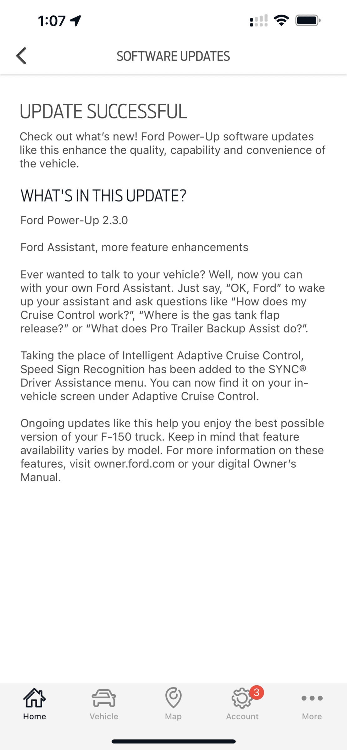

got this late last week build 1 truck made Jan 2021

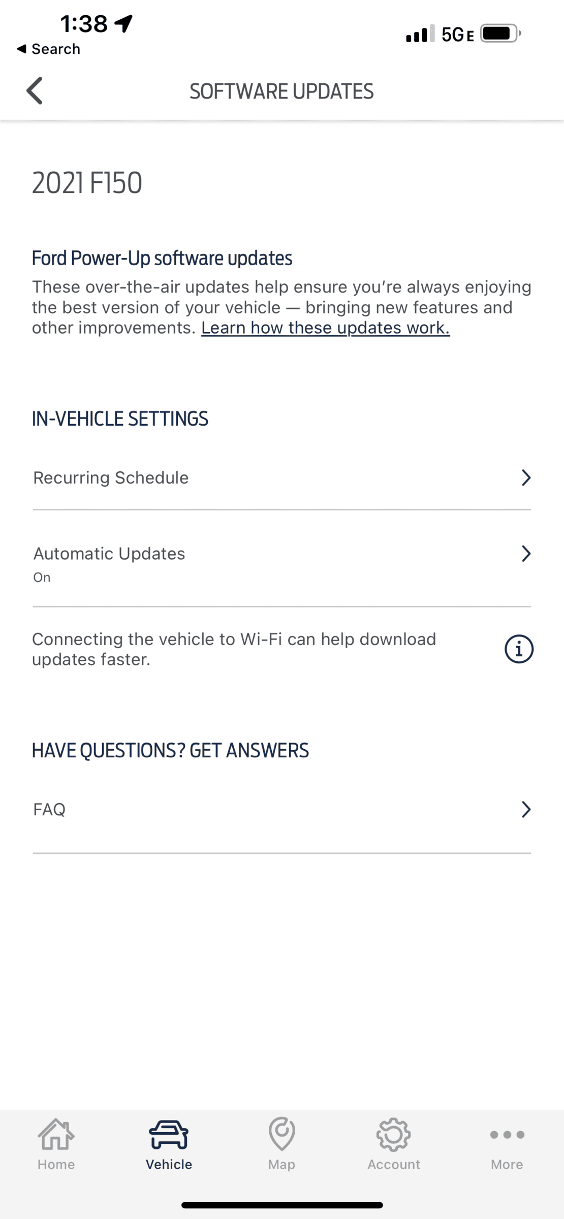

My toggles are all still in the off position, but ford pass shows that auto updates are still set to on, so that hopefully means it will still receive an update automatically when available.
Where in Fordpass do you look to see that automatic updates are on? I'm looking all over and don't see that.
When I click on (Vehicle | Features & Settings | Software Updates) It shows (in-vehicle settings) and how to enable automatic updates. But I don't see anything about them being "on" or enabled.
Same place. Mine shows on here.
Wow! The whole time I've owned my truck the app has not shown that even when updates were on. I think I'm going to clear the cache, unload the app, restart and reinstall. I was always wondering why the app did not show the automatic update settings status on my phone, but, I guess it does.
Thanks!
Did you get this fixed? I'm in the same boat where it doesn't show it's on. Have tried re-installing the app already though.
