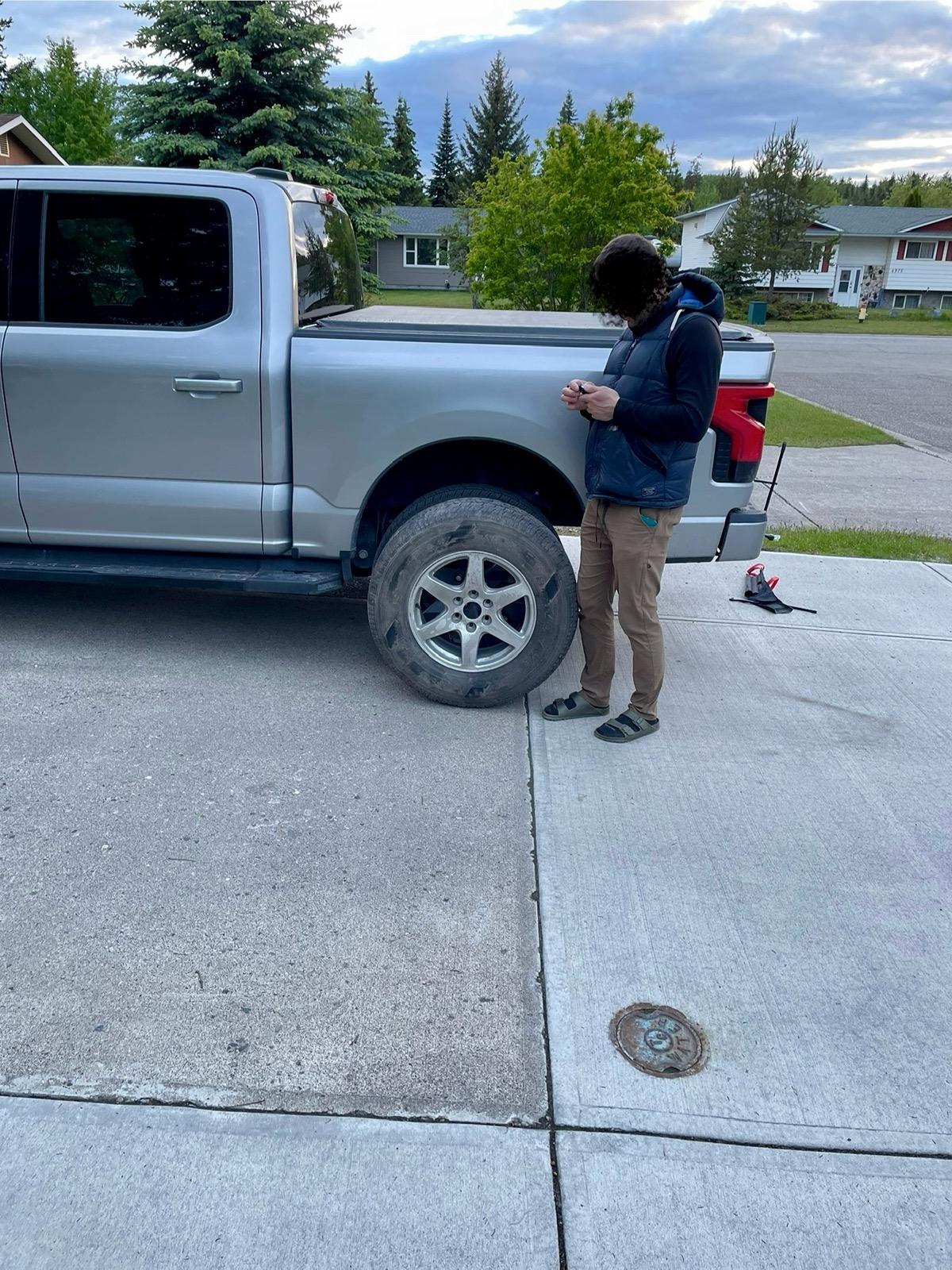

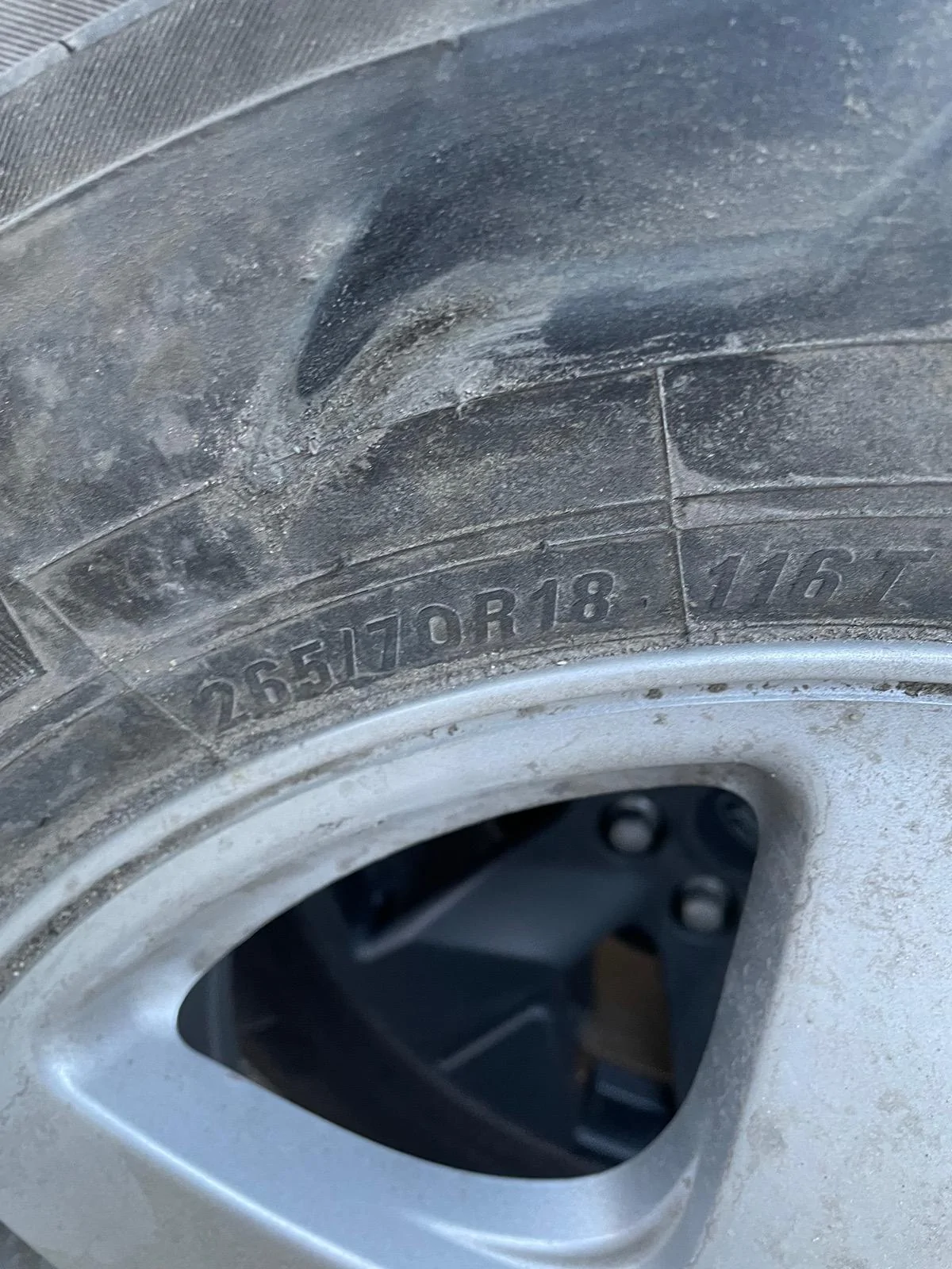

I took my spare off last night to check it. This is what it looks like.
Ford F-150 Lightning Spare tire for  23 Platinum. IMG_4401
Ford F-150 Lightning Spare tire for  23 Platinum. IMG_4400

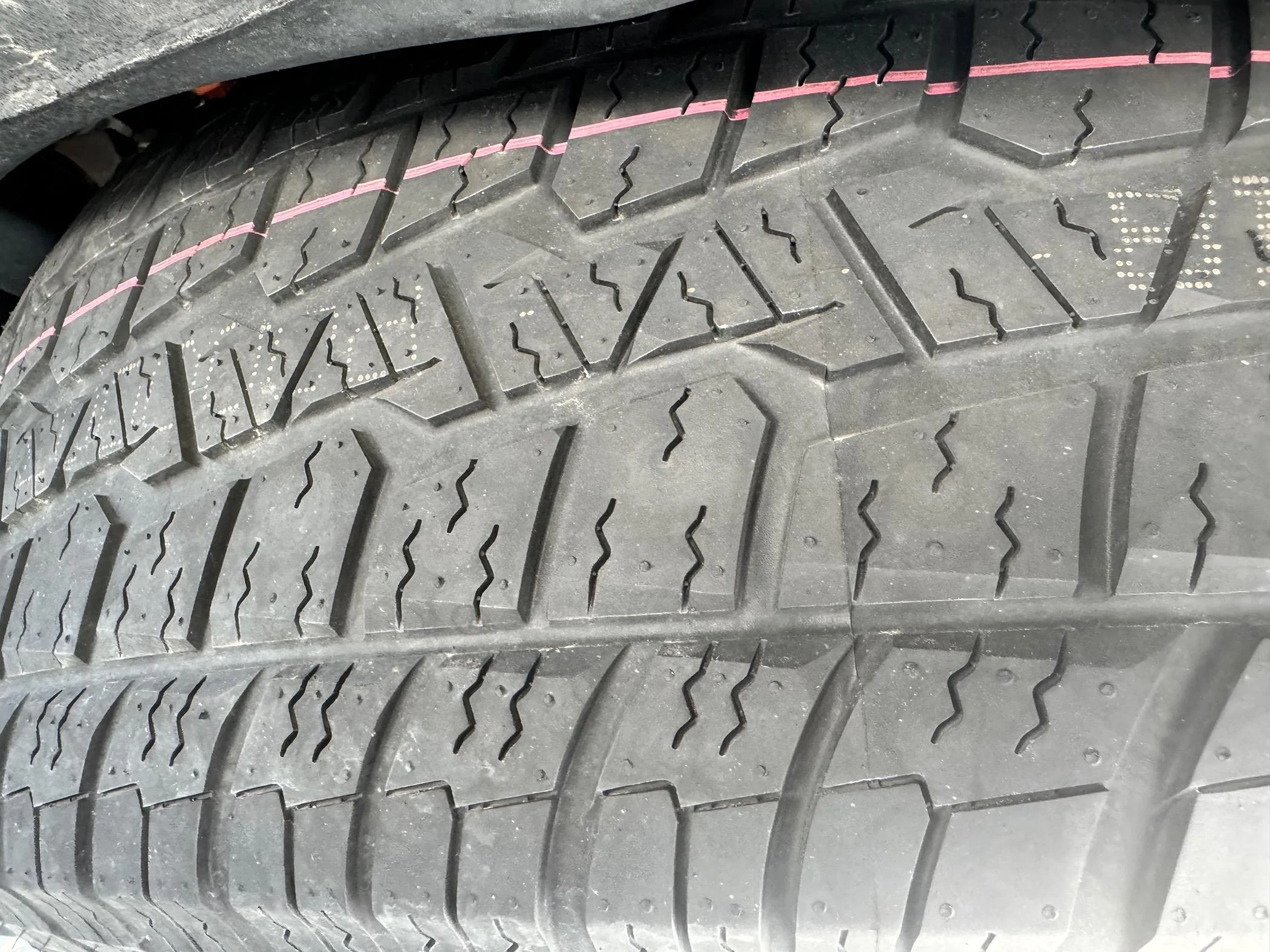

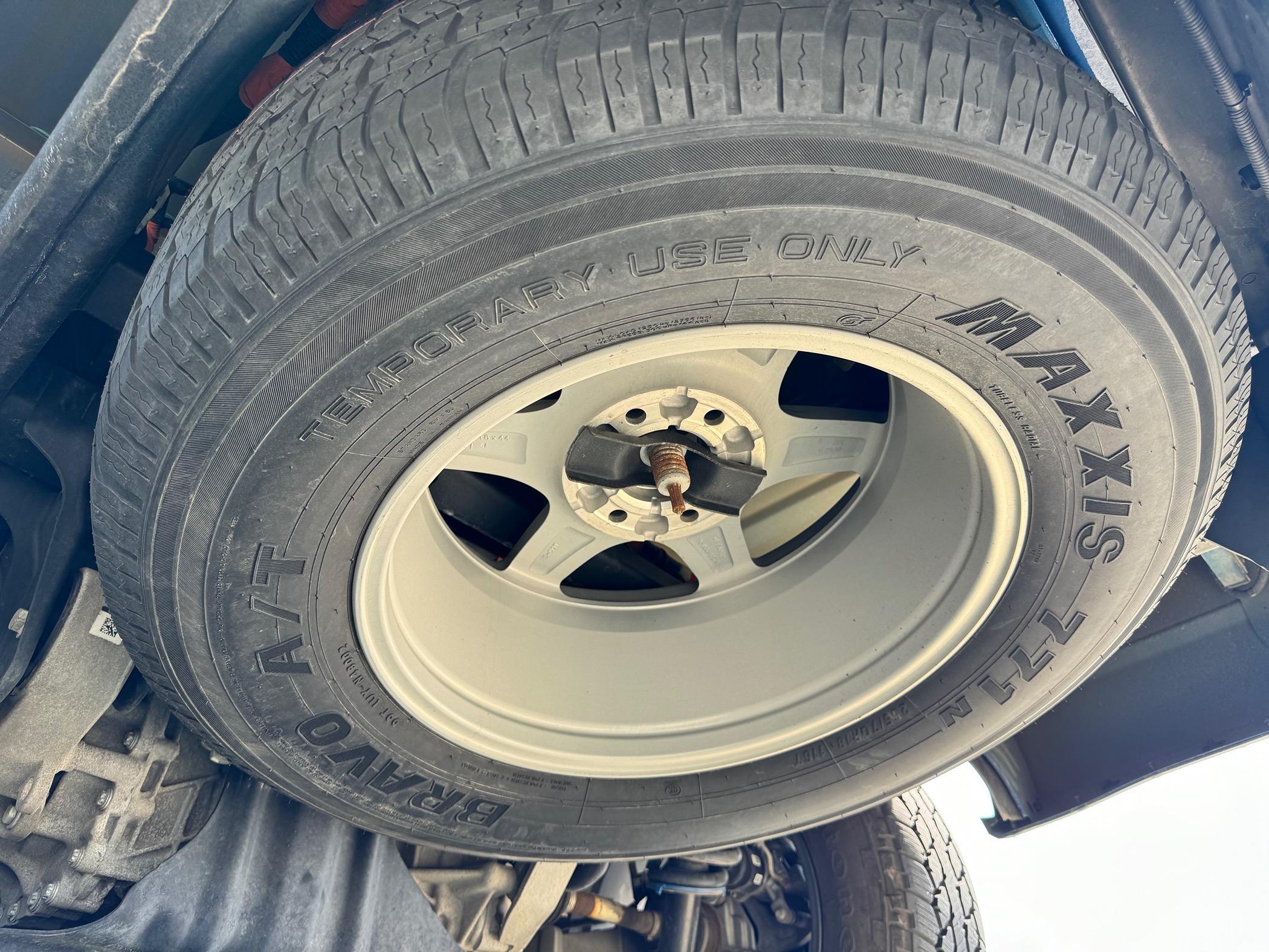

This is what comes to mind when I think of something that’s not a full-size spare.
Ford F-150 Lightning Spare tire for  23 Platinum. 1718595806278-1
The spare tire on our Lightnings is the strangest thing I’ve seen…a full-size truck tire that’s marked for temporary use only. It has much less tread and a strange tapered tread design, but it’s a far cry from the donut found in the truck of most cars and CUVs. I’d love to know how much cheaper this is than a regular tire in that size.

According to this thread it is an 18" wheel on all Lightning trims (tire size not specified).
