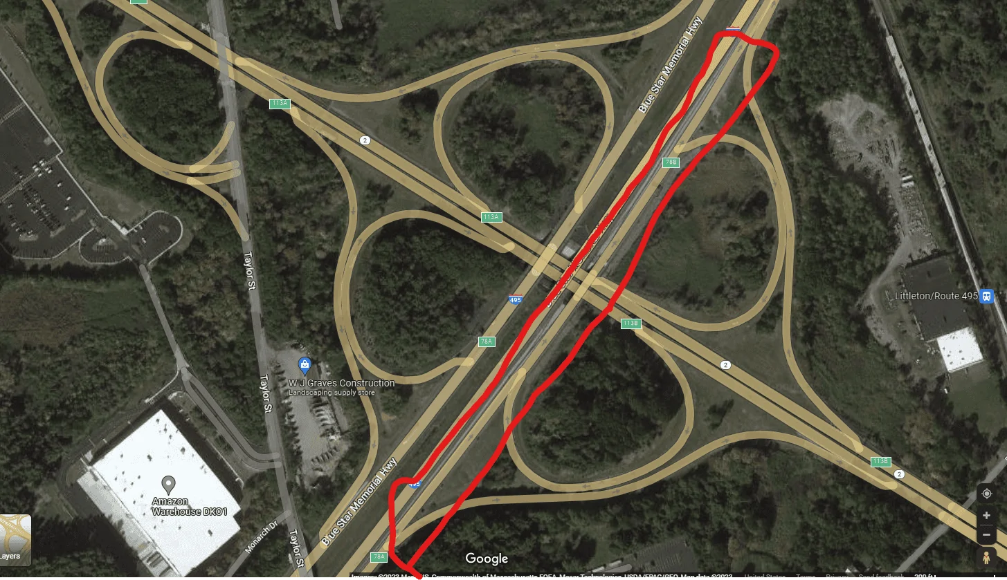

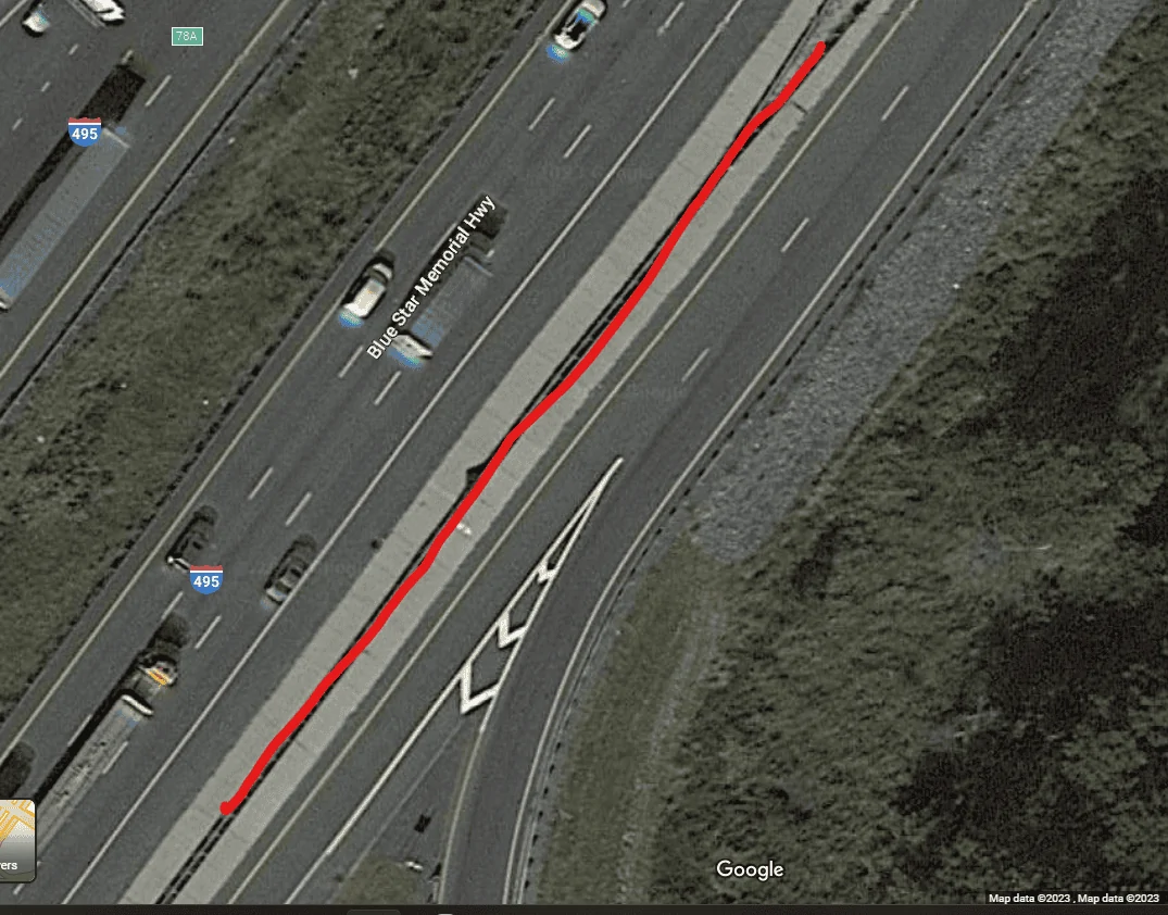

After a few incidents of the system miss reading signs, I turned the feature off.
The worst event was i495 north as I'm passing over the RT-2 underpass, at this location the road is 5 lanes wide with the rightmost two lanes being an isolated "SLIP" ramp as they are called here, this compartmentalizes the merging traffic of RT-2 east & west on & off ramps away from the i495 through lanes.
The problem seems to be that the slip ramp zone speed is slower that the through lanes and Blue Cruise / Hands Free doesn't know the distinction of where I'm at in the through lanes vs the slip ramp lanes.
Ford F-150 Lightning Speed Limit Recognition Dangerous Behavior? 1679758193530
Ford F-150 Lightning Speed Limit Recognition Dangerous Behavior? 1679758082603
