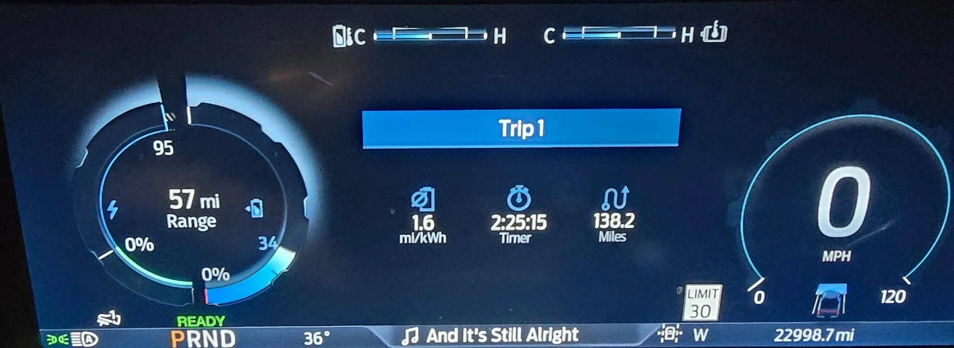

Just got back from a night out with the boys, spirited driving, mostly limited access highways and about 18 miles of 45 MPH country roads, on the way home I noted the available power slightly reduced when the SOC was at 42%, arrived home with this 95% on a SOC of 34%. The afternoon trip started at 100% and fully conditioned on the plug.

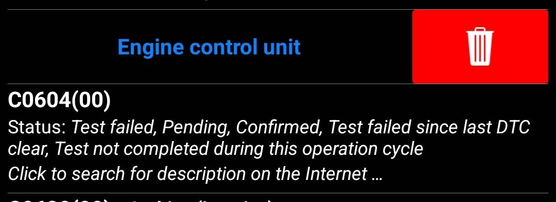

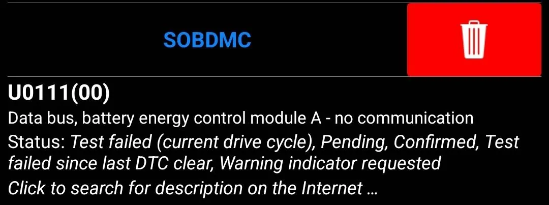

So I just had this warning pop up while driving. Only going 30mph, still showed full 100% power available. After parking, I plugged in OBD and it found these codes

So, did it restart?
2,507
2,670
So, did it restart?
Yes, I gave it 15min while gathering my stuff and logging hours for the day. Error did not come back on my commute home. I'm sending the screenshots to my service advisor, I've got an appt for Apr 4th to do my 40k service. Hopefully just a random glitch. I've double checked that my 12v jump starter is charged and in the truck just to be safe.
