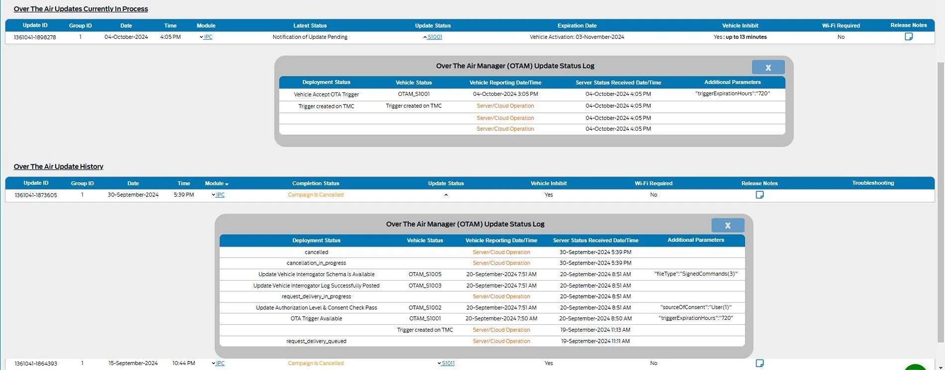

@Keanen Got your message. 6.8.0 has been sent to you three times. The first two times, it was canceled by the server. It was resent again on 10/4. You being in software, this should make sense to you. If you see the course of the previous OTA trigger, your truck completed the handshake with the mothership in terms of giving "consent" for the OTA trigger to proceed. Interrogator posted the log, but the manifest was not verified to download any files before the update was canceled.
This time around, your truck is failing to ping the server back to allow the OTA process to go on to the next step. I would try rebooting the GWM and TCU with FORScan. If you don't have FORScan, then I would try to unplug the negative battery terminal for 15 minutes or so to reboot everything. Once you do that, take the truck for a 10-15 minute drive to see if it phones home and allows the OTA to proceed.
