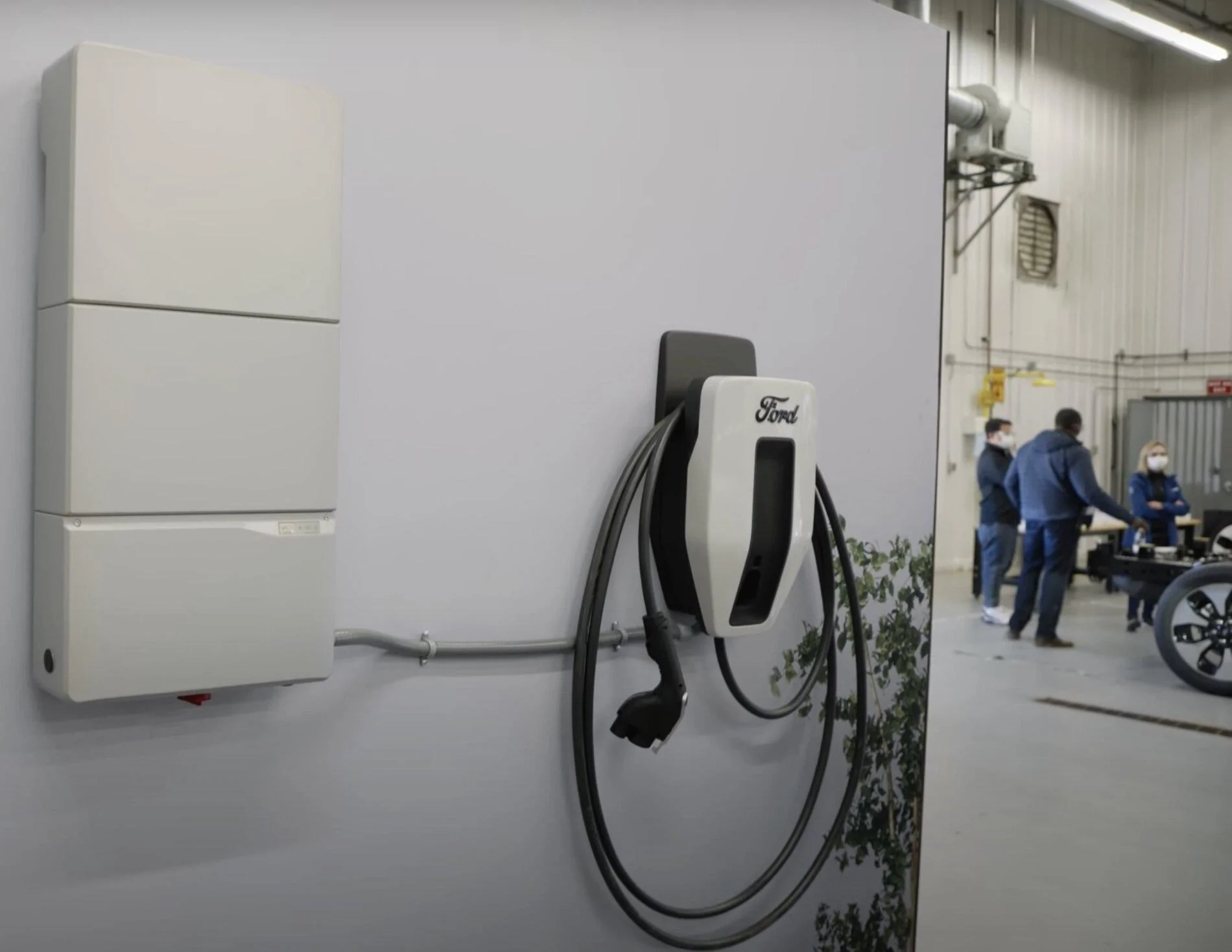

That said, one that seemed to me to be the most knowledgeable at the Denver event insisted back-up will occur via the AC pins of the charge port, using the inverters of the vehicle. He insisted Lighting inverter hardware was capable of this, versus MME and Transit chargers/rectifiers that are not. He also said they were told Ford would have their own transfer switch product sku and that it is being supplied with the 80A EVSE.
All the conjecture about using the DC pins of a CCS format connector on the 80A EVSE are based on the factory photo that seemed to show a CCS connection and an external inverter on the wall. It is possible that was just an R&D setup and not the final configuration.
Car & Driver didn't just invent these technical details…

Ford's 80-amp Charge Station Pro with Intelligent Backup Power features a CCS charging plug, which is the type found at Level 3 fast chargers. When connected to the Charge Station Pro, optional with the Standard Range battery but standard with the Extended Range pack, the F-150 Lightning can feed 9.6 kilowatts of power through the CCS plug's larger bottom ports, through the Charge Station Pro, and back into a home's power panel.
Couldn't be more clearly stated.

That's nice and interesting, but they may be guessing from a photo like the rest of us. No Ford rep is on record saying what you bolded. Also the bolded connection sequence does not reference an external inverter (I don't believe could be built into the 80A EVSE due to size) and makes no reference to the required grid isolation device, so is already suspect. I'm confident they didn't know more than any given Ford rep back in May.

Ford F-150 Lightning SunRun Require PV (Photovoltaic) system with F150 Lightning use as home back-up power e3afvuyx0aml1ks-format-jpg-name-4096x4096-
from this thread of mine:
https://www.f150gen14.com/forum/threads/ford-80a-charge-station-pro.4139/
in turn from footage from within Ford's facilities while the videographer in question was on tour.
That's a CCS connector. Home charging is clearly via AC and the J1772 pins supplied by the standard EVSE side of things—no one is claiming 480V DC in garages is a thing. The other pins aren't there just for fun.

Ford rep says production 80A EVSE will not have a CCS connector. As I stated, this may be some kind of R&D setup. They don't even have a holster for it.
