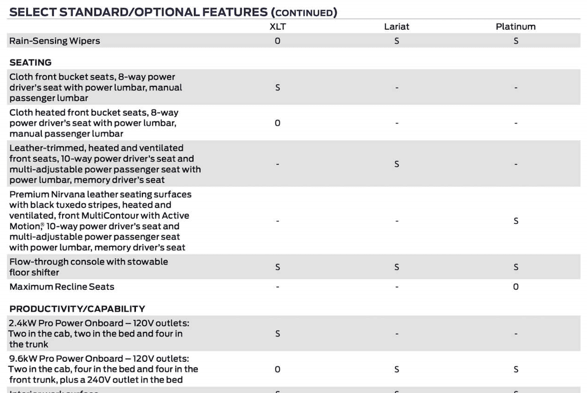

From what I’ve seen so far it looks like the 240V outlet is 7.2 kW. With the 2.4 kW total from the various 120V outlets *added* to the 7.2, we get a grand total of 9.6. I’d much prefer a 240V/9.6 kW outlet as well, but it doesn’t look like that’s the plan.
Where have you seen that the 9.6kW is a split of 7.2kW to 240V outlet plus 2.4kW to 120V outlets? When I look at the spec sheet, it appears to show options of "2.4kW for all plugs" or "9.6kW" for all plugs" in the productivity section of the pages. It is true that they would have to incorporate a 50A 240V plug instead of the 30A that covers the 7.2kW of the current hybrid.
I’ve seen the 7.2 outlet in the bed in several walk around videos of the lightning. So I just guessed that that’s the 240V outlet we’ll get; plus the 2.4 total on the standard 120V outlets would equal 9.6. Still hoping I’ll be proven wrong though!

Yes, but note there is a 9.6kW truck AC outlet on the Platinum that is optional for most or all of the other configurations I believe. The upgrade output is 7.2kW on the hybrid so another potential benefit of the full EV.

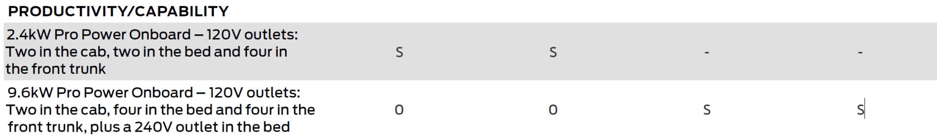

Yes they have:
It is optional on PRO and XLT.

Is the the 9.6kW pro power option just a set of extra plugs? Why would this be any sort of substitute for the ER battery? I am thinking that there’s some thing I don’t understand!
It's not a substitute. You can have it with and without larger battery.
