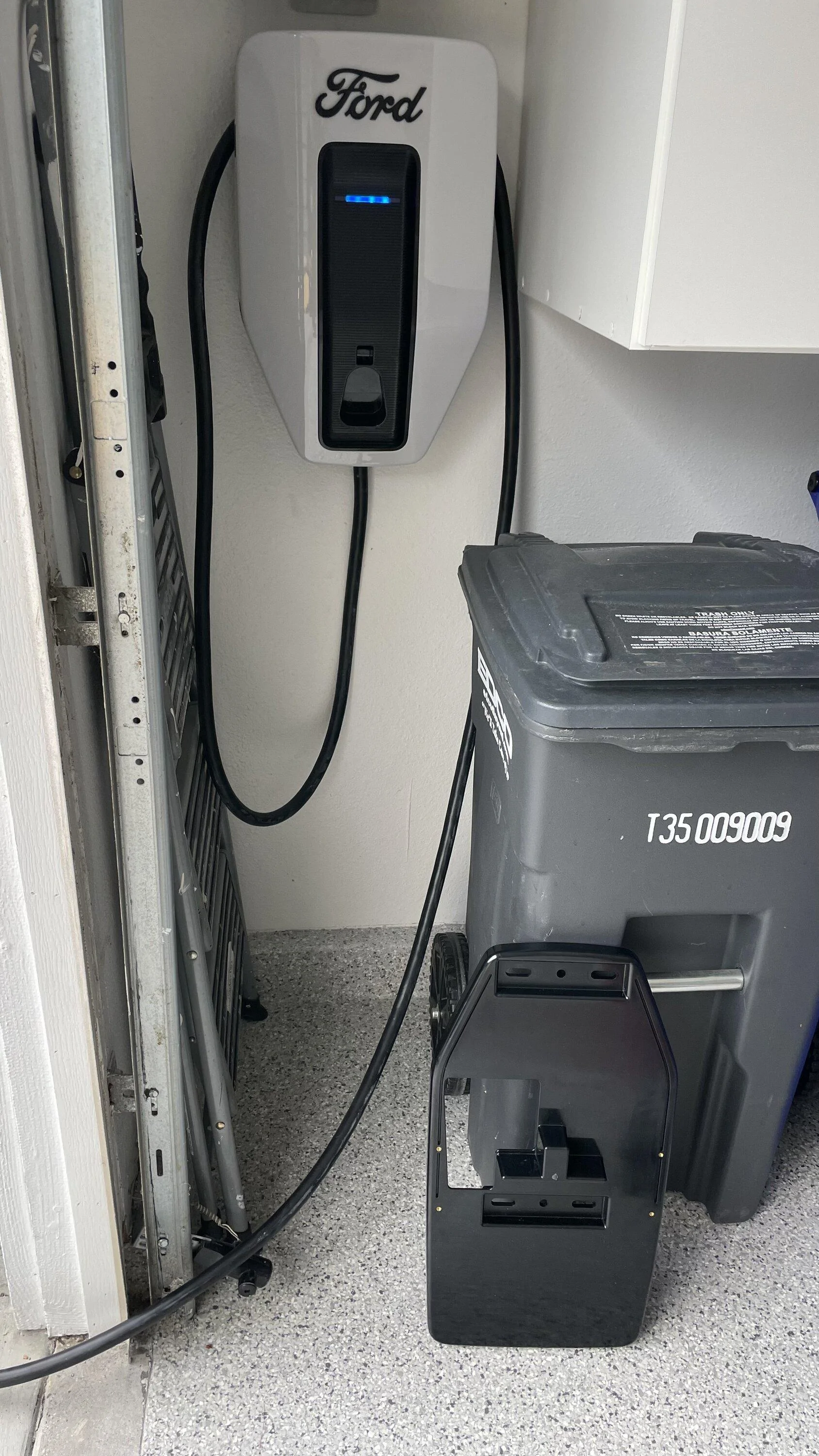

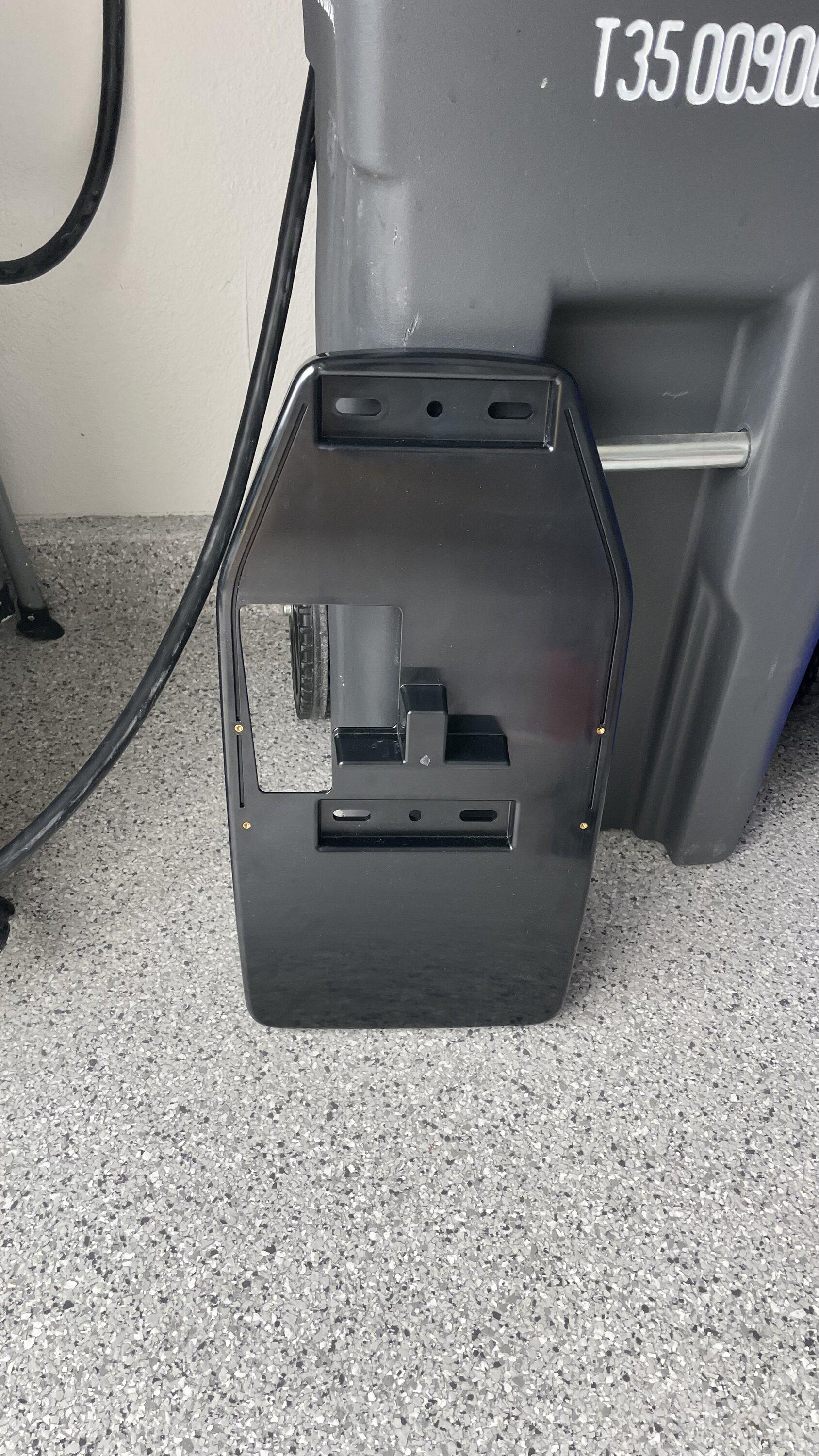

Is this a problem? (see explanation and photos below)
My CSP was installed yesterday and it works great and looks great. It's a 60 amp breaker with 48 (#5) setting. I have charged it twice and it feels sturdy and fits the wall.
The electrician didn't use the base (I think it is called the base or mounting bracket). I am not sure he even saw it.
Should I have him come back out to fix it or is this okay?

You’d have to take the cover off and see how he secured it to the wall. It definitely wasn’t designed to be mounted this way.
Yeah, I sent him a text to see what his explanation is.
Based on the pic, it could be that position of the electrical outlet box, the mounting location of the black plastic charger base, and the cabinet on the wall that prevented the electrician from mounting the black base.
Yeah, I am waiting to hear back from him, but I might just be okay with how it is, especially if everything is done right (it works well) and it is going to last.
