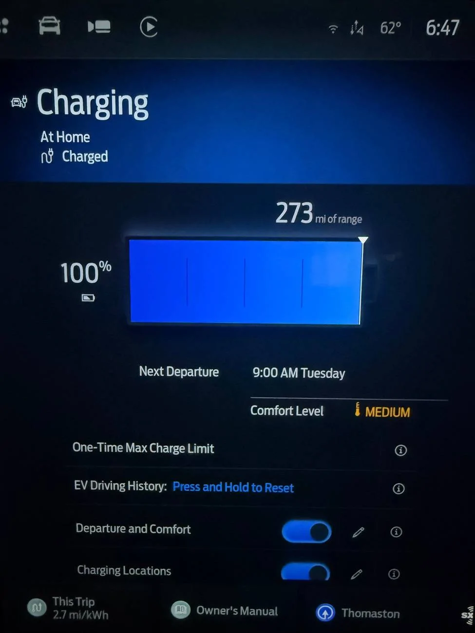

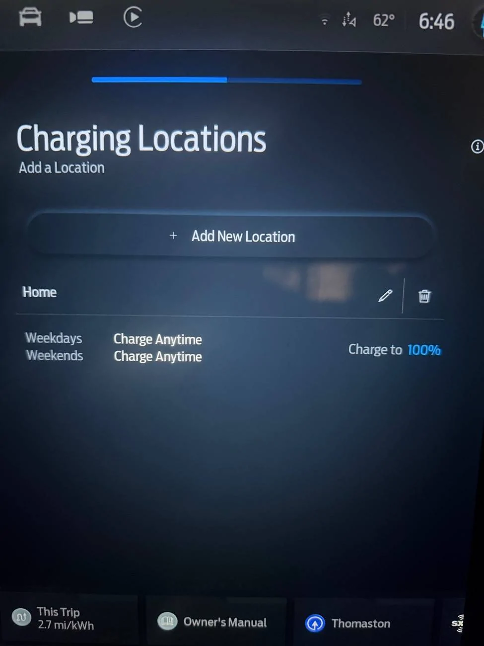

In the main Charge menu item in the car add location
There should be a list of locations where you’ve charged. You can set home charge preference to 80%

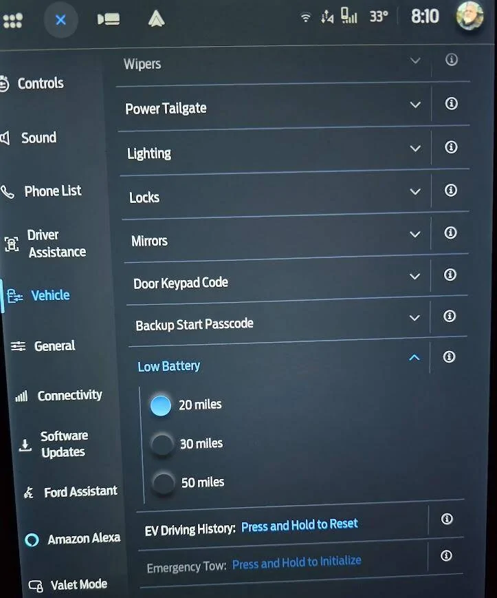

The problem you're describing has been observed early on by model year 2022 members, IIRC we can't force the NAV system to honor our home location as a qualified charging point for "PLANNING" purposes.
The work around alluded to above, is to lower the warning setting for when you'll be alerted that your range is low and that a charging stop is needed, the lowest you can select is 20 miles, if you're cutting that close and you know you can make it just ignore the offers to navigate to an alternate charging station listed in the navigation system.

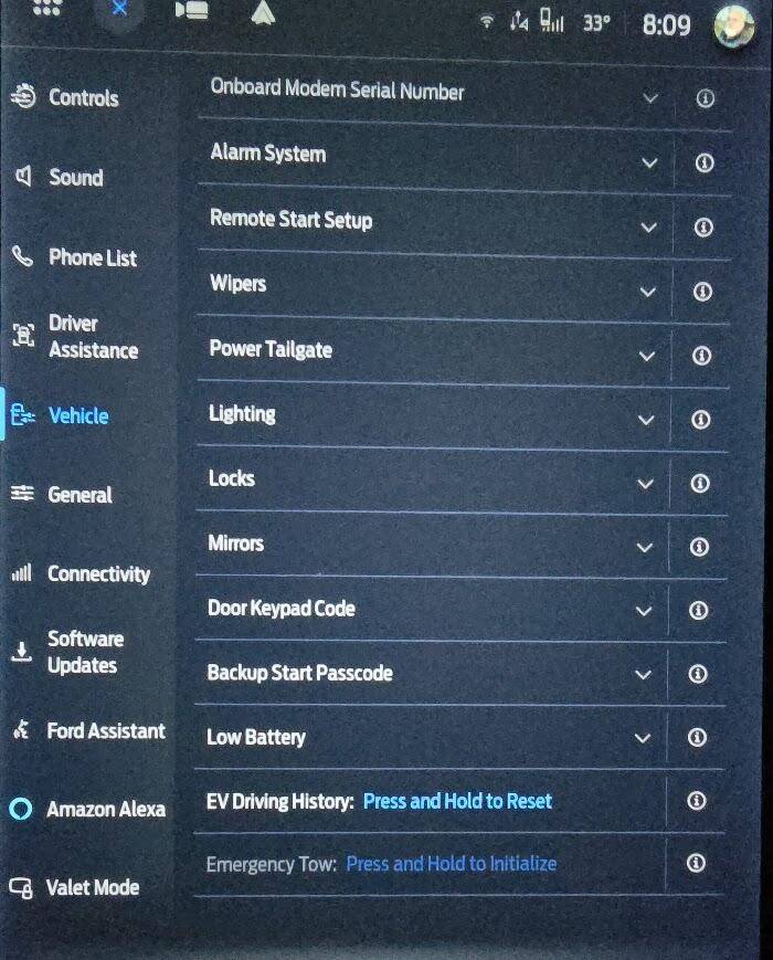

Goto Settings, Vehicle, Low Battery, adjust warning level, but note this does not resolve your navigation route planning if it thinks you can't make the destination. But you can minimize the warnings

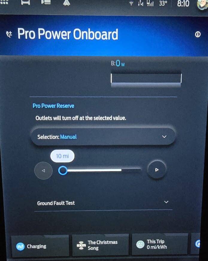

Pro Power On board also has a reserve setting, that you can lower to 10 miles if you want to suppress extraneous warnings
