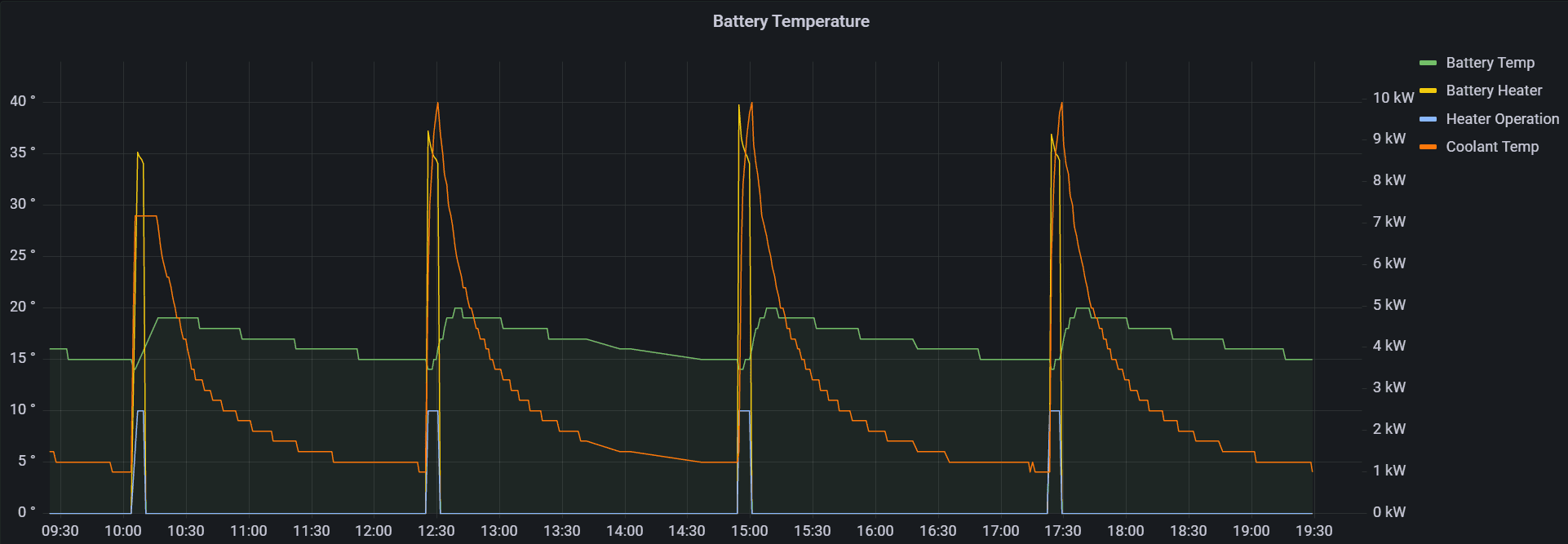

You again assume incorrectly. The F-150 will not precondition the battery on 120v, it can't supply enough juice. And it won't use the battery to do so. It will warm the cabin only. You can again verify this with an OBDII adapter and an app - but it's been done dozens of times on the Mach-E.
Ford F-150 Lightning Am I crazy - L1 at home is adequate? 1673320784986
I don't know about pre-conditioning, but the truck does heat the battery while "running" and plugged in to a 120V charger, so perhaps "remote start" is your workaround.
I'm just getting my logging capabilities set up so I don't have enough data to draw a definitive conclusion, but this is something I observed over the weekend.
Granted, using battery power to heat your battery is.. well... counter productive and will reduce range overall.
I'm not sure that looks like a battery pre-conditioning, just seems to keep battery temp above a minimum needed to take some charger (an apparently not enough charge to keep the battery from re-cooling off). The power used looks well above L1 maximum, so must be using some battery power to provide a bit of heat to itself. However, this seems to just demonstrate L1's inability to heat the battery by itself.
