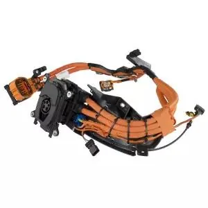

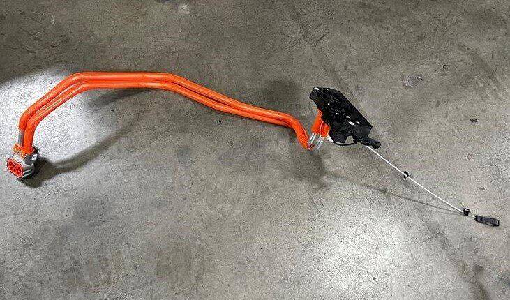

There are LOTS of engineers on this planet (who don't work for Tesla) who could engineer a safe solution that meets all the NACS requirements and safety codes and get it certified, and bring it to be manufactured in the moderate volumes one would anticipate. Getting the costs down low enough to get the price under $1000 is the main challenge.
Consider the charging port to battery cable inside the fender of the F150 Lightning. Its just plastic and cables. Does not appear to have any liquid cooling Its only about 2' long, but you you can buy the OEM part for $656 retail.
Ford F-150 Lightning Tesla engineer warns against using extension cords at Superchargers 1726961139779-rd
The Cybertruck uses what appear to be solid bars inside aluminum tubes.
