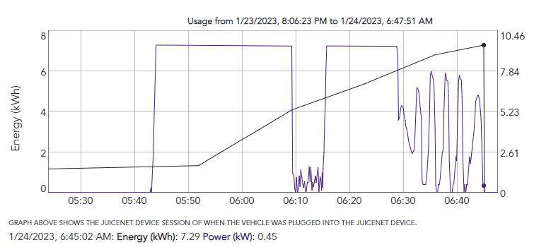

I recently started testing pre-conditioning to see how much energy it would consume. I have a JuiceBox which has some good data logging that I'm taking advantage of and thought I'd review what a pre-conditioning session looks like consumption and timewise on an F150.
This morning was good because it offers a baseline at 0C/32F.
It looks like there was a little over 7kW of Energy used to precondition the truck outdoors. I had my time set to 7am and it started drawing electricity from my charger at ~5:43am. See graph below:
Ford F-150 Lightning To Pre-Condition or not to?   Usage and analysis - 7kw @0C/32F 1674564465463
Now looking at this, its quite a bit of Energy and my commute to work is short, 4km/~2 miles. IMO I'm better off jumping in the truck and just driving with some gloves (Ford, heated steering activation any time now :D) in this scenario - seems wasteful for 4 minutes of mild discomfort. But you can see why lots of small trips from a cold and dark start can easily chew through the battery simply getting it up to temp.

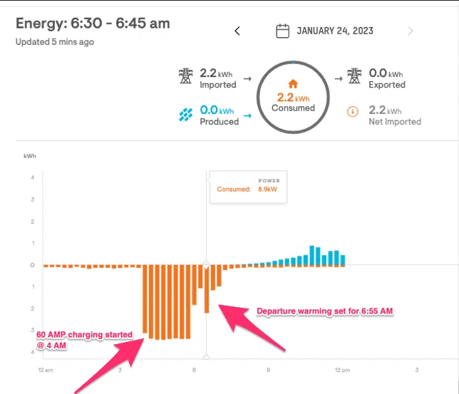

I've been doing some testing in the following thread...
https://www.f150lightningforum.com/forum/threads/ideal-charging-practices.14066/page-4#post-295063
...and my research so far completely validated my belief that the best of both worlds is to set up your "nightly charge" (if you are a charge every day person... I am.) to happen as close to your morning departure, with or without Departure times setup. Charging itself warms the battery to the same amount if not more than Departure times. So just use the charging time to kill both birds with one stone and not waste energy.
What you do not want to do is get home in the evening charge and warm battery, let battery cool overnight, and then spend more energy re-warming in the morning with Departure time.
I do my Charging starting at 4 AM for a targeted departure time of ~7 AM and have found that to be my sweet spot and it has definitely improved my efficiency and lessened my Departure and Comfort kWh usage. In the attached graph you can see how I am "blending" the 2 periods.
Also an additional benefit of morning charging is it prevents the battery from sitting at a potentially high state of charge for longer periods prior to .
Ford F-150 Lightning To Pre-Condition or not to?   Usage and analysis - 7kw @0C/32F Screenshot 2023-01-24 at 12.24.22 PM
you made some really good points. One clarification based on checking battery temps while charging. I found all the temp pid sensors and have monitored them during charge.
charging with FCSP does warm the battery the same as preconditioning because the heater engages and the two diverter valves send heat to the battery whenever it is charging with the FCSP in cold temperatures.
while using the ford mobile in 240v to charge the heater does not engage and the temperature increase in battery is minimal.
in 120v same as 240v no heat and minimal charging if you can even get it to charge. My 120v charger goes amber below 15F.
