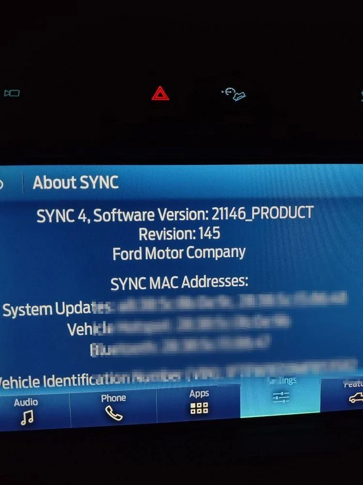

I checked my truck and I have 21146 Revision 145:
Ford F-150 Lightning Took truck in because it has never received an OTA update. Service was clueless IMG_20220101_172414973_HDR

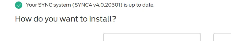

CHecked online and i see this
Ford F-150 Lightning Took truck in because it has never received an OTA update. Service was clueless 1641276786910
In the car it says something like 1.4... This sucks.
