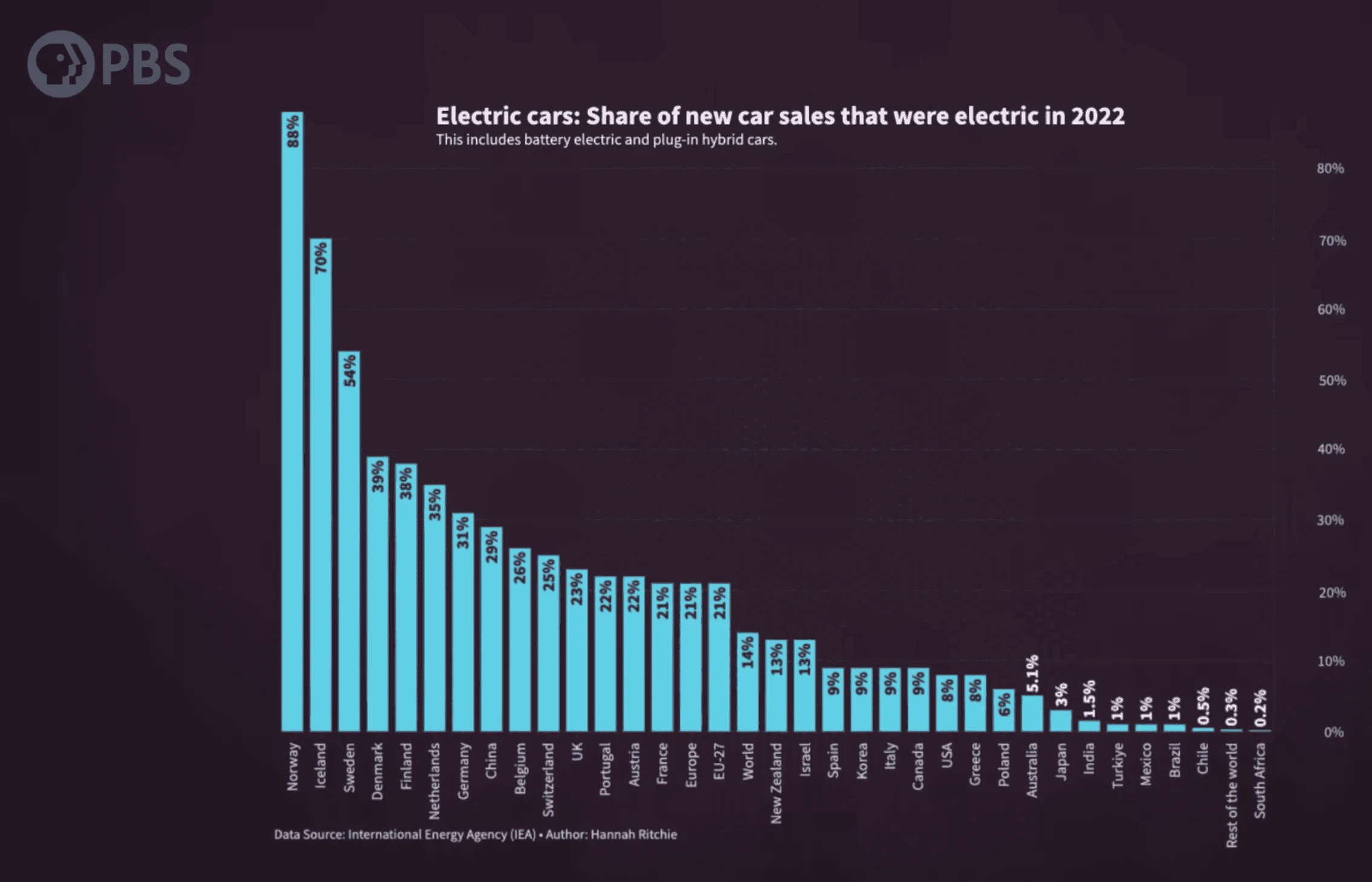

side note: I always thought people in cold climates would be buying less EVs because of battery performance in cold. So I was surprised when I saw this:
Ford F-150 Lightning Top battery off to 90% every day? 1703178759277
5,195
6,900
Thanks for sharing that.
Right. It is a great response when some says "EVs don't work in the cold".
Really? Top 5 countries....

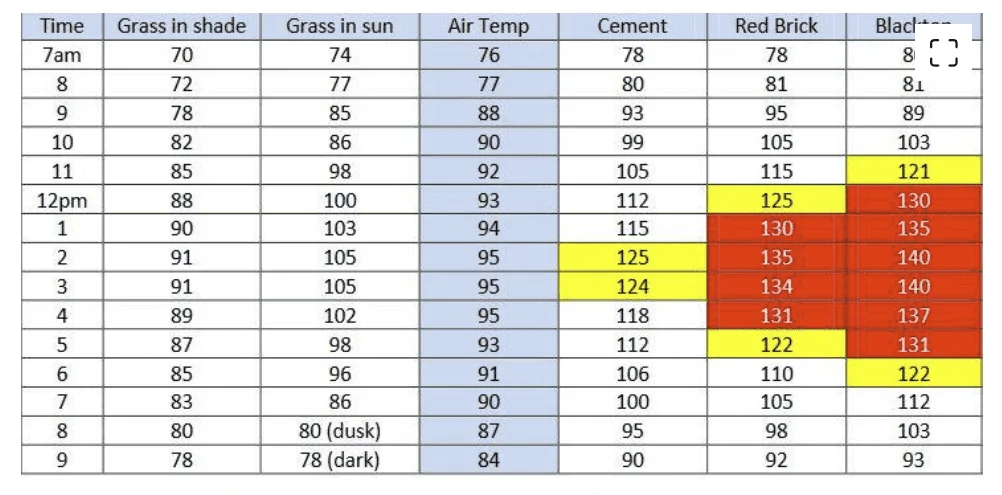

we don’t get those kinda temps in my state. My truck has been in shade for most of summer except one day that it was fully exposed in our vacation property driveway in a 90+ degree day. When I turned on the truck, the fan went bananas. Made me wonder if it is doing any battery cooling at all when it is off.
Jim Lewis
Jan 10, 2023
872
756
San Antonio, TX
See the following chart of air temperature vs. black asphalt temperature (with presumably the temperature of air right above the asphalt close to that if there is not much of a breeze):
Ford F-150 Lightning Top battery off to 90% every day? 1703198709853
Source: How hot does pavement get in summer? | Climate and Agriculture in the Southeast (uga.edu)
A Ford rep in a call I made to Ford.com specifically to ask at what temperature the BMS kicks in for a Lightning told me it was 100 deg F, whether the Lightning was plugged in or not: https://www.f150lightningforum.com/...weather-when-not-plugged-in.15313/post-327623
P.S. Besides the air temperature above the asphalt, you'll also get the very hot asphalt radiating heat directly at the battery, literally "black body radiation!"
