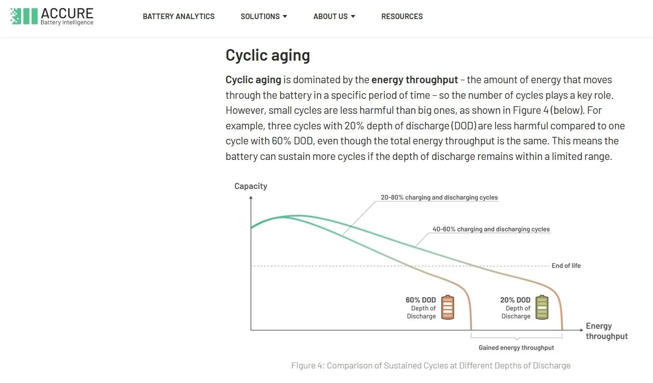

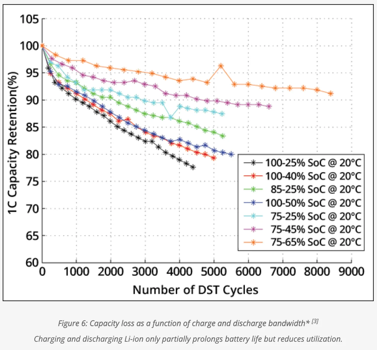

Some organizations talk about energy throughput rather than battery max cycles. Here are two plots supporting the statement above, shallower cycles centered on 50% is ideal, but may not work for everyone. Note how soon impact of those 100-25% cycles can be documented. Other plots can be found showing higher temperatures and/or higher current charging creates plots with quicker degradation.

So according to the graph above, if I start my car at 100% each day, drive it until I'm at 25% battery, and then recharge it back up to 100% overnight (i.e., one cycle each day), then after 10 years, my battery health will be at 80%.
Given that would be about 200 miles a day, during that same period I will have driven over 700,000 miles. I don't think battery health will be my biggest concern.
This is not one cycle each day. This is .75 cycles. A cycle is a measurements of the times you've charged and discharged the equivalent of the max capacity of the battery. So, 0-100 = one cycle but so does 30-80 twice count as a single cycle.
