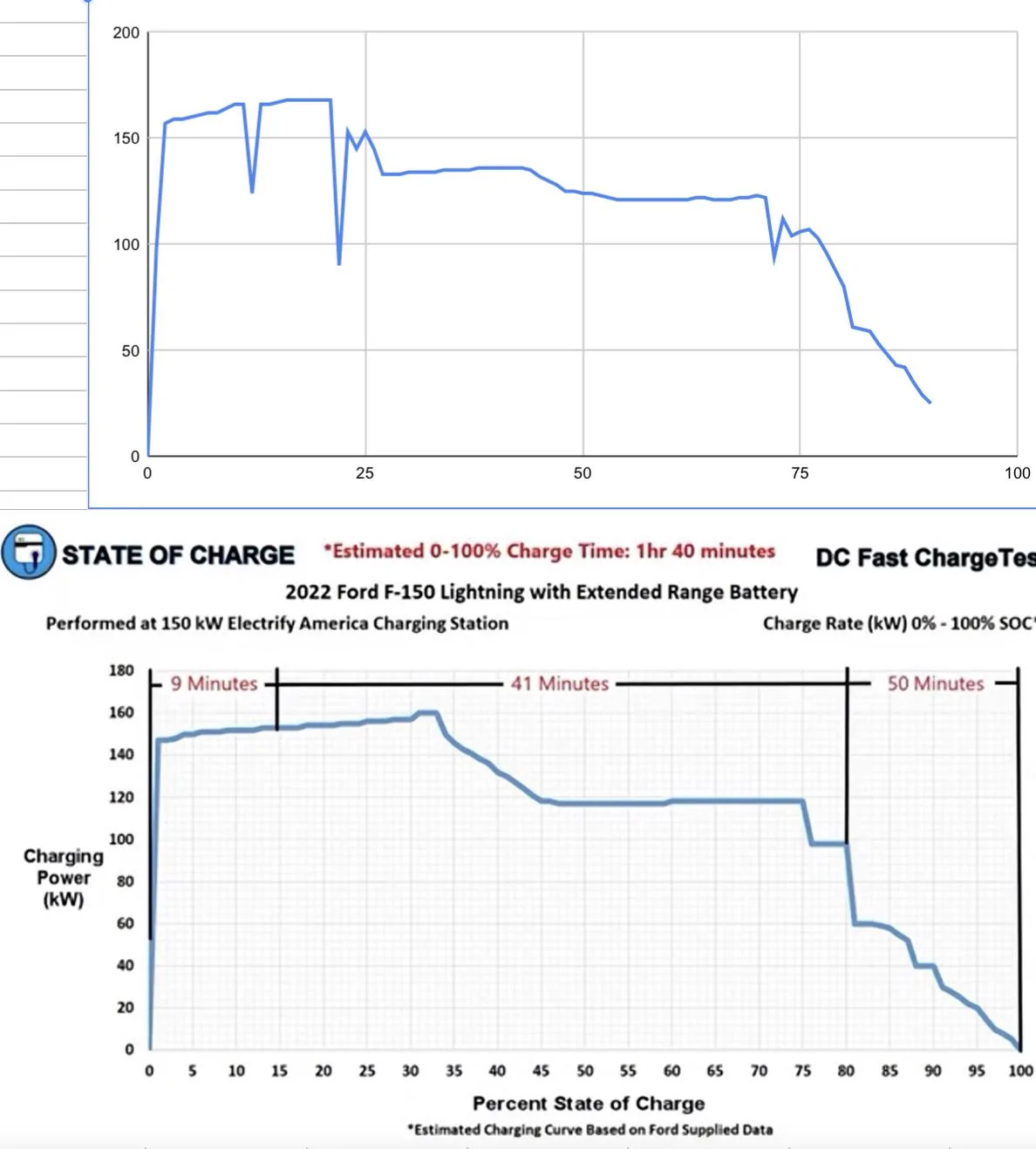

As to the origin of 80% charge limit, the only discussion backed by data I’m seeing so far is coming from Tom (extrapolated from Ford’s data supplied by them) and Kyle (from his 0-100 charge test). They have discussed recommendations for road charging within the 20-80% SoC based on time efficiency. Interesting that Tom’s theoretical extrapolation of Ford’s data is fairly close to Kyle’s actual experience.

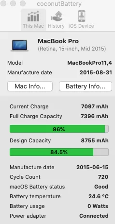

BTW: my laptop is 7 years old and has been on a charger since day 1 and still works like a champ. I am typing this reply on it - 84% charge remaining after 7 years is good for me.

Looks like your MacBook has either a 15% buffer, 15% degradation, or a mixture of the two after 720 cycles. Seems pretty normal either way.
My Model S has 5% degradation and about 8% buffer after 7 years and 474 charge cycles. I charge to 90% daily and 100% on trips.
My Galaxy S20 has 1% degradation and a 9% buffer after 2 years and 330 charge cycles. I charge to 80 or 85% daily and rarely go above that.
A BMS without a full/empty buffer will boast longer battery life initially and then take its toll on longevity, often conking the battery out much sooner. A lot of consumer electronics are now building buffers into their software regardless of what the manufacturer does. My laptop now offers an option in BIOS to limit the max charge, and Android does the same.
With a sizable buffer you can probably charge the truck to 100% daily with no issues, but why bother maxing it out for daily use?
