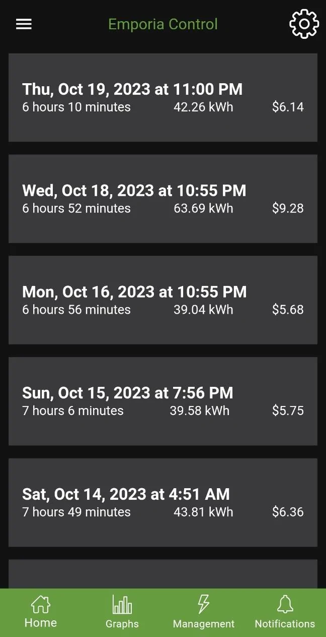

I know you say you don't want a different charger, but the Emporia EVSE will accomplish what you're trying to do.
Ford F-150 Lightning Towing costs - help with calculations Screenshot_20231025_140423_Emporia Energy

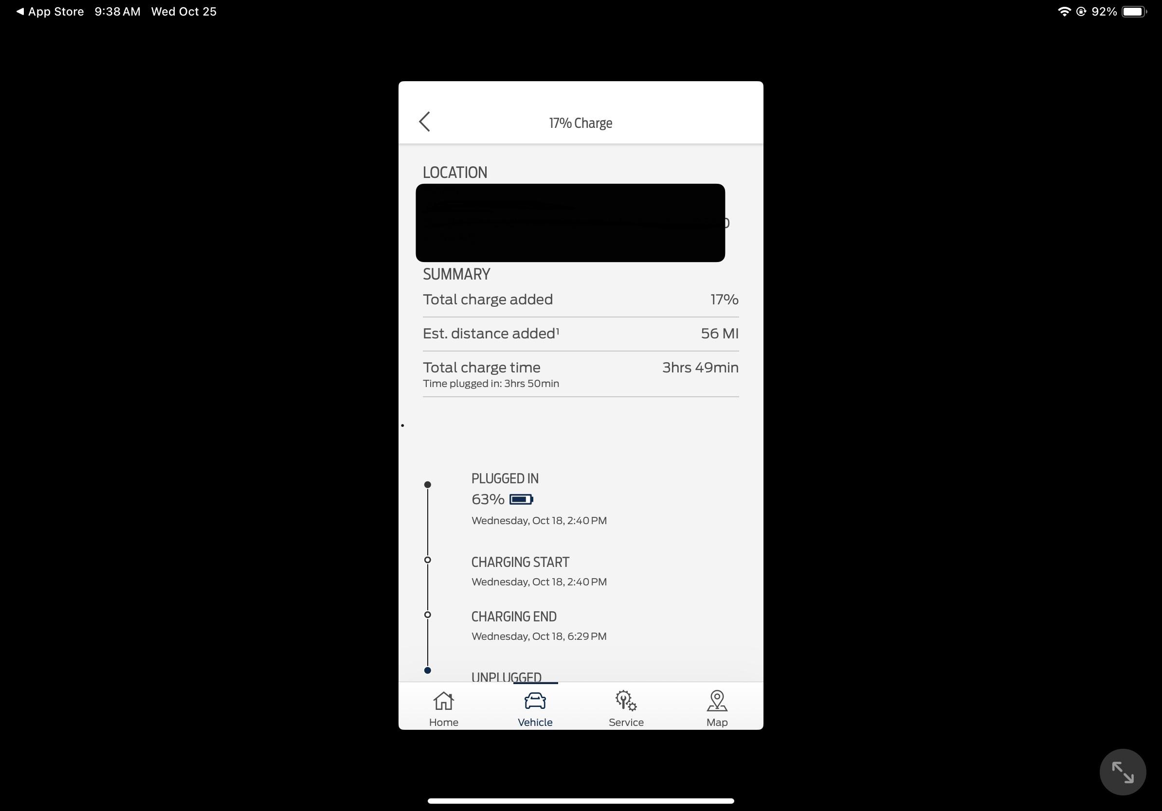

Boy I'm so embarrassed.The 17% charge log is not for my towing trips. I can't find the tow trip charge anywhere. Not showing up in the Ford Pass app, trip data gone from the truck when I reset the trip meter. I rarely delete my Ford Pass data and I'll have to wait for another tow opportunity to check that out.
So below is a two person trip to town and back.
If it takes 17% to charge back to 80% why can't I simply use that % change times the total battery size to calculate energy consumed? Is 17% of 131kWh = 22.27 kWh added correct or not?
I do not intend to add a faster home charger. Been fine using the mobile charger except for the lack of data. I just want to see how much cheaper it is to run my truck. I've always kept gas records on all our gas vehicles. I could clearly see my Tundra's mpg drop when I was towing or winter driving. I rarely let my EV's drop below 50% and never charge above 85%. So I'm typically adding 10-20% on a charge. Just want to know what it costs to add that % back to my truck.
Your math is right and the best way to do it if you're not going to install a charger that will track for you - there is typically (in my understanding) ~10% loss in energy used to energy stored in the battery, so you could safely add 10% to your cost and probably be a little more accurate. Rounding errors on the charge percentages could add up over time, too, though they likely would even out over time.
Did you actually drive 56 miles on the trip 10/18??
The reason i ask is that the charging record rarely computes the restored energy "Estimated Distance Added" value accurately for my truck.
I tend to burn electrons at a more aggressive rate, but some folks, possibly your's could be right on point.

Yes the milage is correct for 10/18
I ignore the distance added and only focus on the Total Charge added. In this case I used the 17%

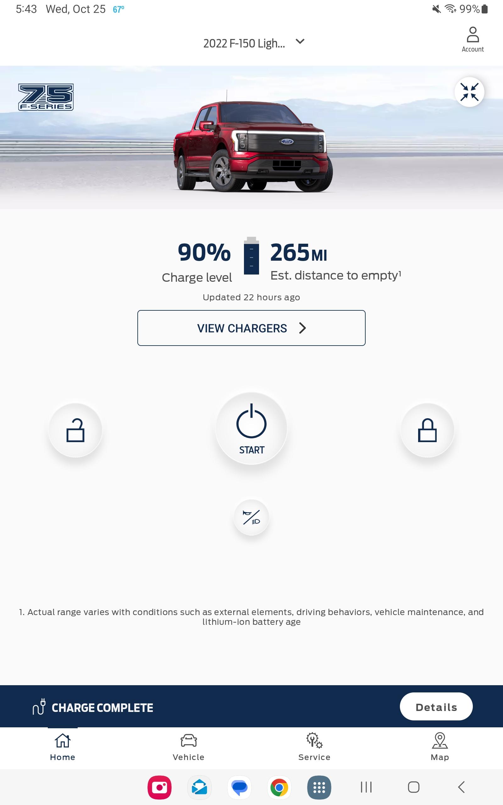

The most accurate way to see how much energy you put into the truck is to look at the Ford app WHILE THE TRUCK IS CHARGING. It will display the amount of energy, with a decimal point, that has been added. Click on the button while it's charging, THEN UNPLUG.
Divide that by 0.9, i.e. accounting for 10% loss from house to vehicle. It might be as much as 15%, so play with 0.85 too.
That's how much energy you used.
Also, remember that towing at low speed uses much less energy than towing on the highway.

Are you talking about the button in the charge port? Not sure how I'm going to get an accurate measurement if I'm unplugging before the charge finishes.
You missed the word "app" in my answer.
Cluck on the word DETAILS....

Got it. So let it finish but make sure I check the details on the app before I unplug.

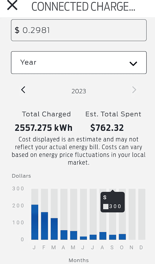

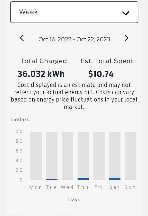

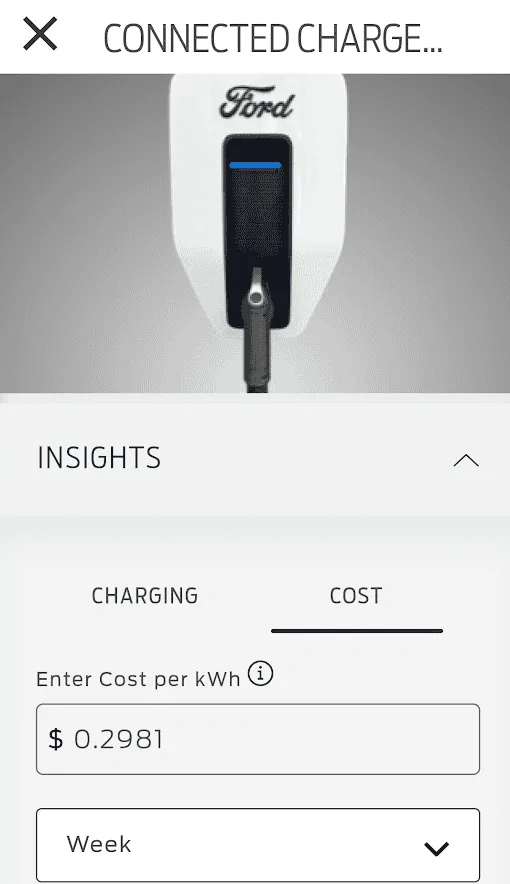

I do have the Ford Pro Power wall unit but haven't considered installing it. Does that give a an accurate measurement? I probably don't have a strong enough interest to pay a few hundred $ to install.
Yes, it's very accurate, and you can input the cost factor for your energy, it will show the cost of the charging by day, week, month & year.
Ford F-150 Lightning Towing costs - help with calculations 1698272640205
Ford F-150 Lightning Towing costs - help with calculations 1698272657118
BTW, my energy rate for Sept/Oct is now running 29.81 c/kwh and going up to 35 c/kwh in December
Ford F-150 Lightning Towing costs - help with calculations 1698272872372
