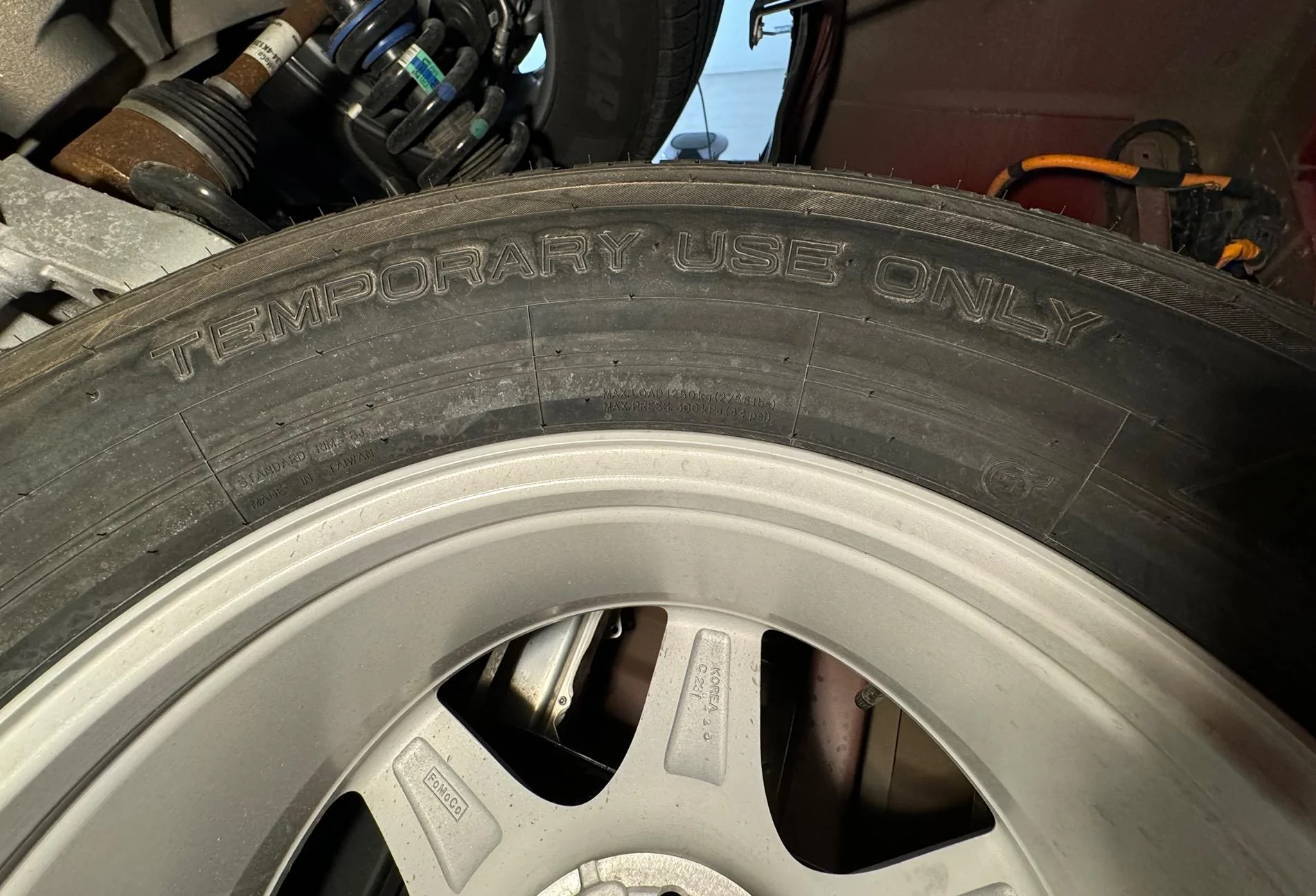

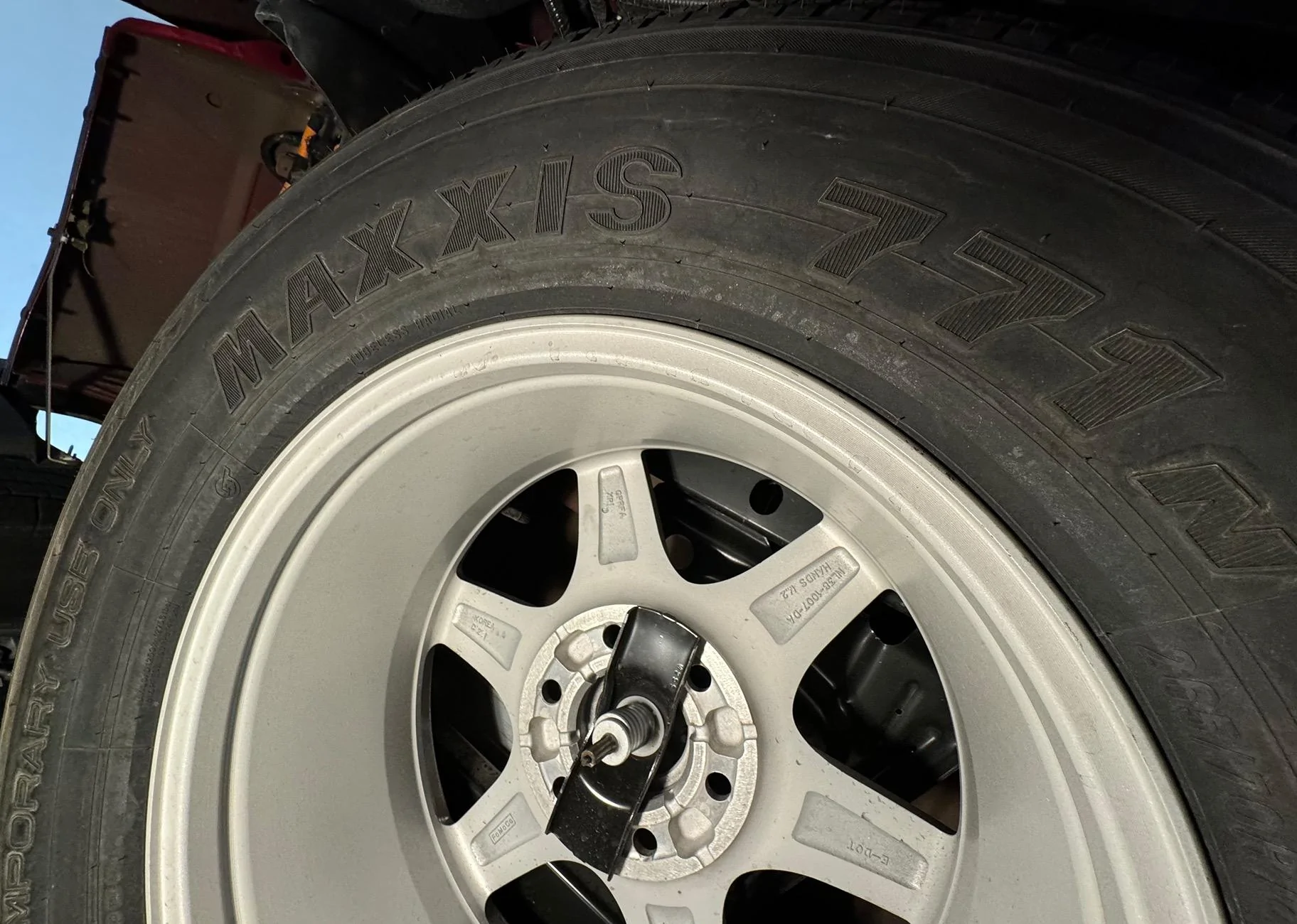

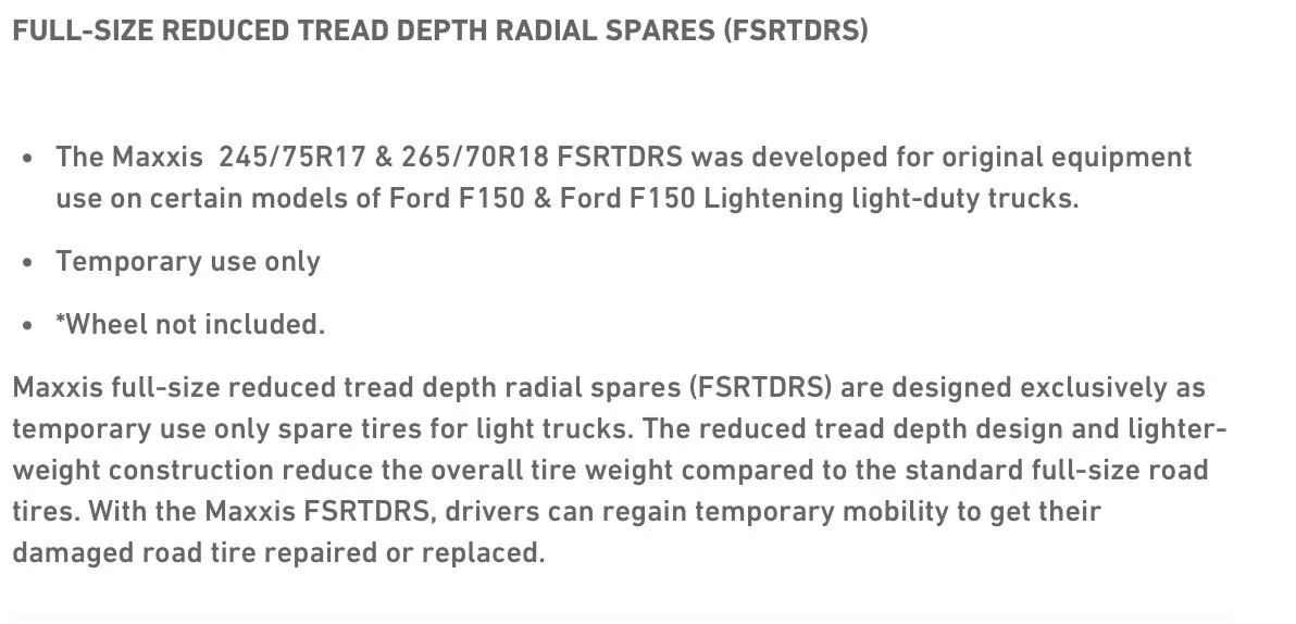

Checked my spare today. It is stamped Temporary Use Only. However I did not see any speed limitations. It is a Maxxis Bravo 771 N that was designed as a spare for F150 & Lightnings. No speed limit info on the Maxxis page either.
Also the valve stem is pointed up. Still easily accessible for checking tire pressure. (36 psi).
