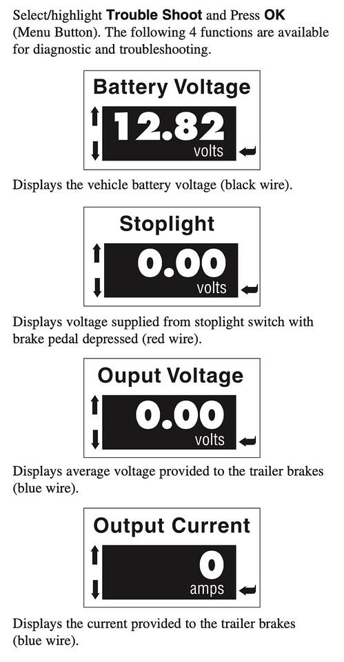

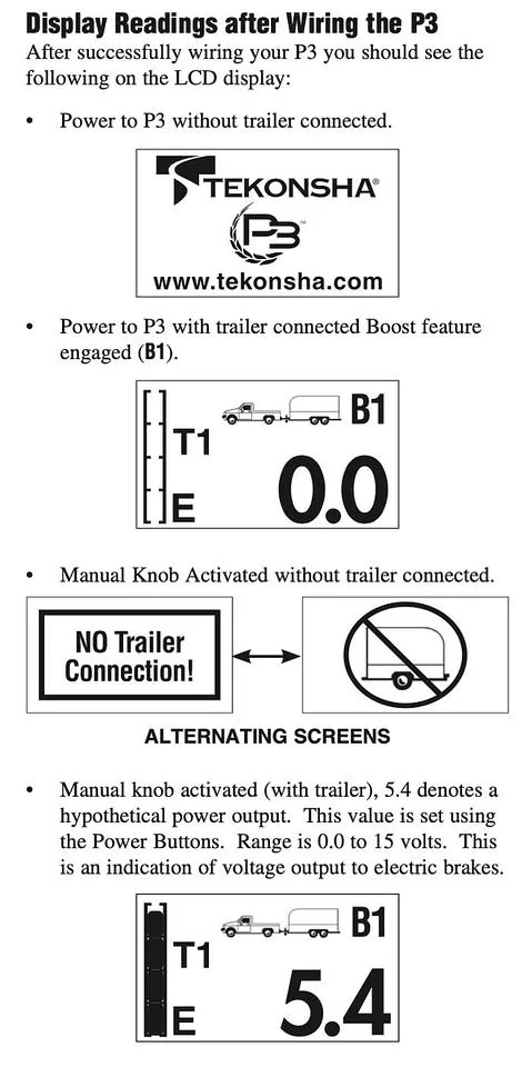

Are you angry about the time it took to fix or the fact that your workaround is now obsolete?
Neither, the whole thing worked to my advantage. I find the Tekonsha controller to be better than the Ford controller (when it works). I would have never tried it had the F-150 worked from the beginning. What I like best is real time feedback of the trailer brake activity. The Tekonsha display shows a constant real time value approximating the current voltage output to the trailer brakes. The troubleshooting menu allows you to see the real time output of system voltage (in my case trailer voltage), stoplight voltage, brake output voltage and brake output current. As I indicated above I installed the Tekonsha independent of the F-150 systems except brake sensing. So further bugs or software updates cannot impact the trailer brake control. All this for $139 and a few hours of installation.

There's always that ^ solution if you don't trust the Ford controller enough to head down a mountain. It wouldn't make me happy with Ford, of course, but it would make me feel safer.
Fair enough. As I said, I’ve used the P3 before and it’s a good controller. But I was never satisfied with its level of integration. I found a controller that uses an accelerometer to estimate datapoints like speed, tow vehicle brake force, lateral g’s etc. less accurate than a factory controller that calculates trailer brake force by reading these data directly from the ECU. But if you have it dialed in to your satisfaction, then you made the right choice. Indeed, the failure of the factory controller is not something to be lamented but celebrated. Otherwise, you never would have been compelled to find a better solution. So why complain about how long it took for Ford to fix its inferior product? What do you care?
