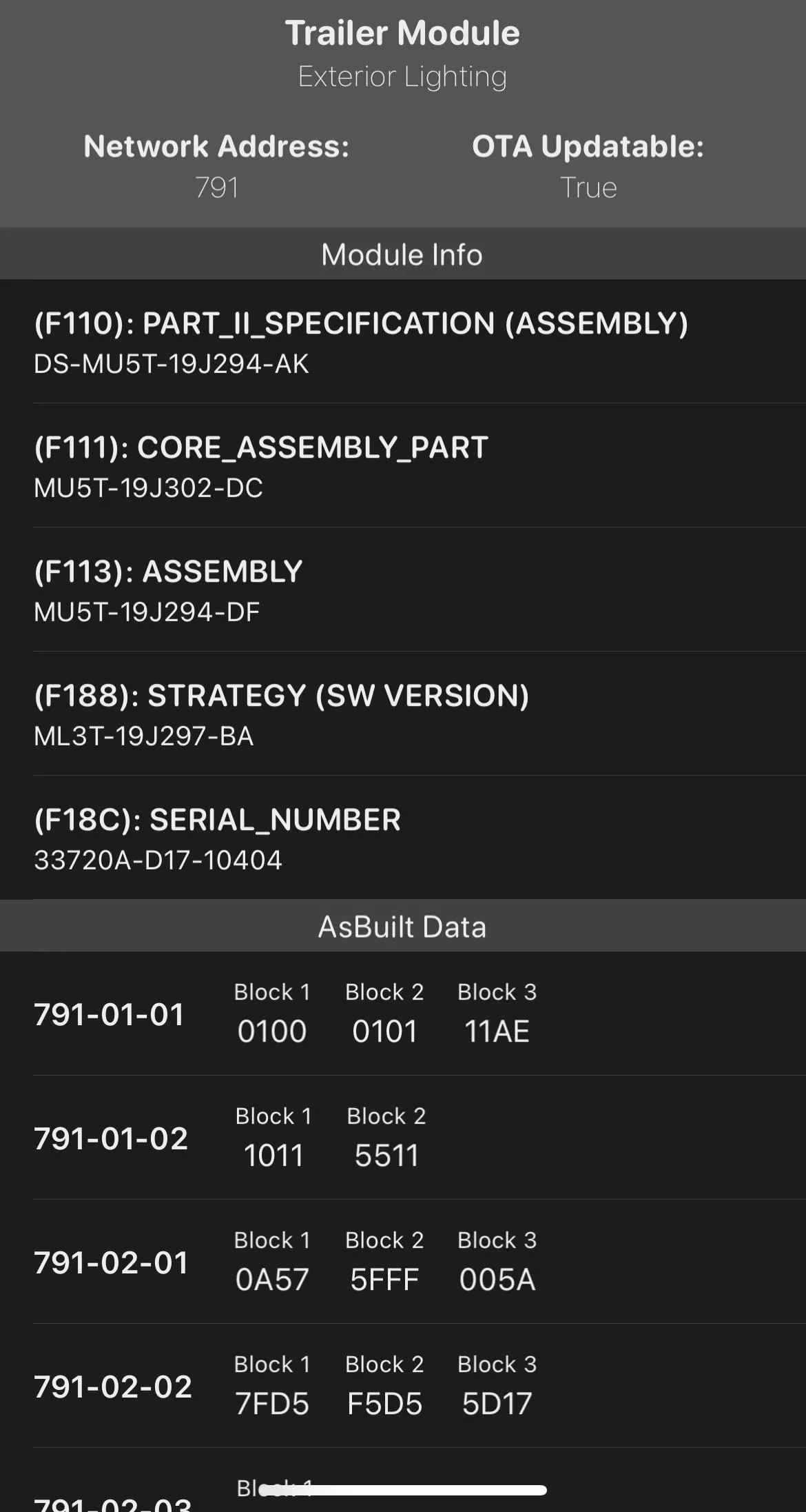

There's a way to check the software version that is installed from an iPhone, you can post it and we can compare the version to what I installed last week before the recall was released. The version I have was released in Feb. If its a later version, it could tell us that you have a newer one.
to get the module info, the Ford Pass Widget would need to be installed in an iPhone.

Here is mine, updated when the TRM came out in February timeframe.
Ford F-150 Lightning Trailer brake not working BE2C91D5-3B23-4D1F-ABE4-89ED7B3B82EE
JEB
Aug 15, 2021
576
393
Northern Illinois
2021 F-150 Lariat Powerboost
What's concerning to me is that my service order from the other day shows that Recall 22S17 is completed now. I just happened to be there for something else and they did it on their own. I wonder how/if I'll find out that I don't have the correct version? I guess I'll keep a close eye on this thread...
Yeah, it’s just a waiting game at this point and watching here and the ECU thread is probably a good idea..
If those of us who already have the February update see another update within the next few weeks, then it’s pretty clear that the second update is the recall. By contrast, if nothing shows up for us by the time the recall letters start going out, that’s pretty good confirmation that the February updates were more of an omnibus that covered both some earlier issues and the recall. We are the canaries in the coal mine.
