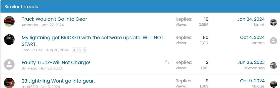

Lots of similar problems. If you scroll down to the bottom of this page (assuming you're on a PC), you will see lots of Similar Threads. Find one that has your exact symptoms.
