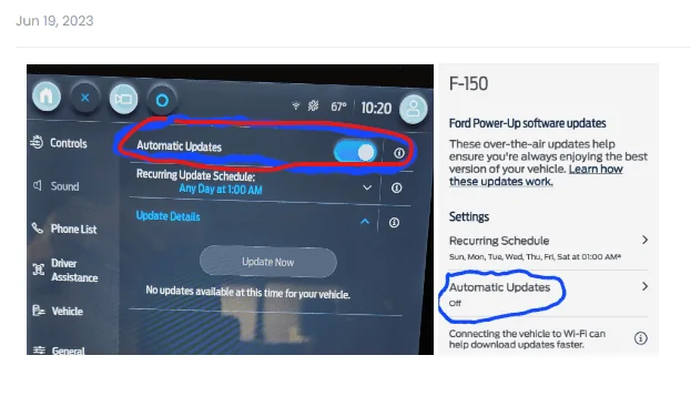

This is unacceptable, anything automatically pushed must be able to be reverted. This could literally kill somebody in inclement weather. A young woman had a minor disabling crash in the rural area that I live during the winter, wandered off to get help and died of hypothermia. If this happens to me on the ferry I could trap 50 cars for an hour (I have seen it happen.)
How do you turn off automatic updates?
Saw this on one of the post from one of the forum members (This is an awesome forum-hats off to the one that is running this):
Ford F-150 Lightning My lightning got BRICKED with the software update. WILL NOT START. 1725121002863-kb
