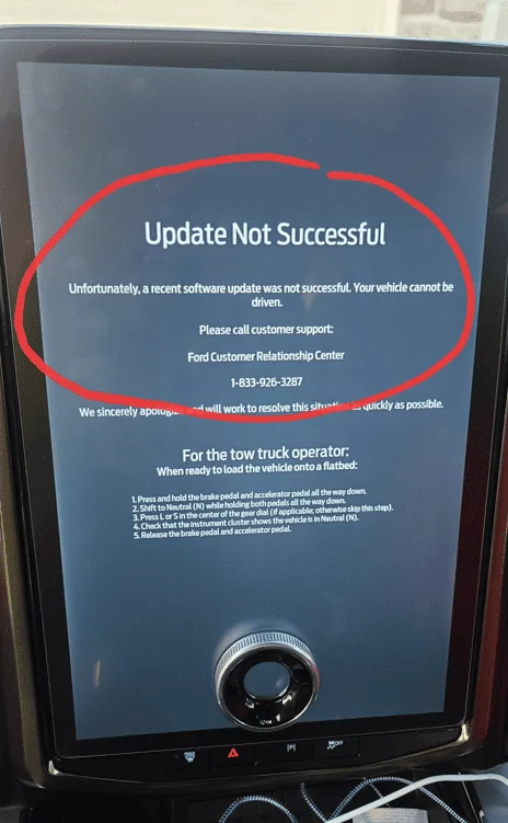

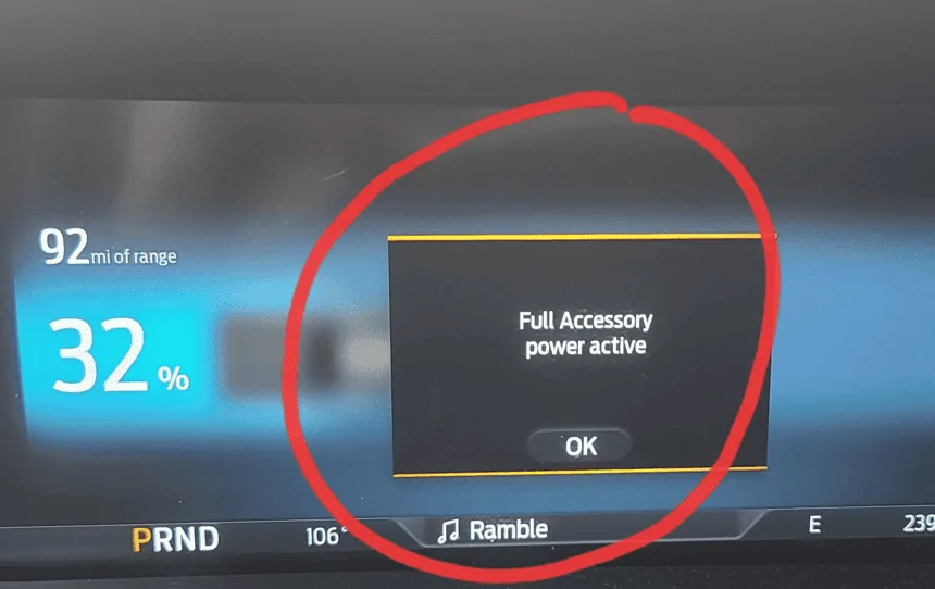

Hi Lightning owners,
I was on my way to work this past Tuesday 8/27/24 so I got to my driveway and entered my Truck. I then started it the usual way when initially I saw a "Full Accessory power active" sign on the screen. I pressed "OK" then started the truck, but it won't start. I tried about 5 times and still won't start. I googled the issue with Accessory power active and tried the tricks that people used to start their vehicle: I placed a new battery on my key fab, tried the push start only without brake then do break and start together, tested my 12 v battery (was fine), let the truck cool down for 30 mins then tried to start it again, tried to use my ford app to start it and still won't start. Needless to say, my wife had to drive me to work that day. When I came back from work around 8 pm, I tried to start it again and truck still won't start. After cooling it for another 20 minutes, I went back to try to start it again and now the main screen is showing "Update not successful. Unfortunately, a recent software update was not successful. Your vehicle cannot be driven. Please call customer support......". To make the long story short, I called Ford Roadside Assistance, and they towed the vehicle (mind you, took them over 40 minutes to figure out how to get it to neutral because even with the instruction on the screen, it would not do it) to the nearest ford dealership.
Has this happened to anyone else before? My truck is a 2023 Ford F150 Lightning Lariat with 23,000 miles on it. Today is 8/30/24 and per the dealership yesterday, the truck could be with them for another week as they have been having issues trying to update it with the new module. Per the dealership, the truck still won't start.
Thanks for any input you guys may have. I loved my truck. No other truck compares to this in my opinion, but this issue has been devastating.

I did finally get a call back from the dealership yesterday afternoon (8/30/24) saying that they were able to now turn on the engine after doing an "inhibitor procedure". I will have to leave the truck with them because I have other thing that need work on like the ACTIVE AIR DAM SYSTEM FAULT etc. They said I could get the truck back next week possibly Tuesday.
So wait….. they got your truck driveable? they told you sorry we need to keep it to fix another code “air dam “ over a 3 day where it will not be touched till Tuesday and you left it there. You’re a better person than me. I would have went and got my truck and be like I’ll drop it back off Tuesday morning 😂✌

The only time my software updates have failed is when my charge is low. If I am at 70% or higher they have always succeeded. To help with this I only allow auto updates on 3 days of the week which are the days I have it plugged in.
I noticed your screenshot shows 32% battery and so it’s just a thought. Not sure if others would agree or not.

Crazy how this can happen. It looks like a handful of us now had this issue. Mine had to be towed on 8/27/24 🤣 . By Friday8/30/27, Dealership said that the truck will start now but I had to leave it there for other issues like the Active Air Dam System Fault, the Full Accessory Power Active Issue (wonder if that is related to the 12 volt battery?) and other stuff. I now feel like I need an extended warranty on this truck as I have no confidence on ford after what happened.

It was a really bad experience for me. I don't blame you for being paranoid at all. If it makes you feel better, there were not that many of us that got bricked. I wonder if they just reverted me to an older update. I have to check.
