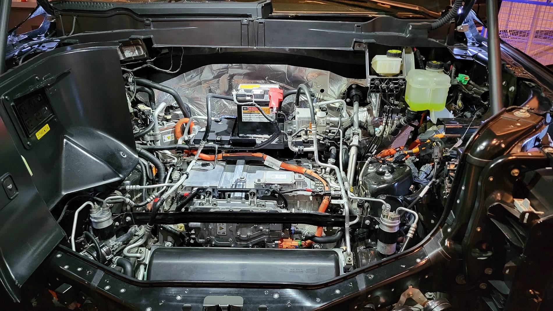

I agree with @Ricks Lightning. The transmission fluid in the Lightning is red. The spray pattern suggests the oil was released at high pressure. There's a bunch of suspects in front of the motor. My bet is a leaking line replaced or reattached plus an oil change fixes it.

If I understand the motor design, the motor oil is self contained to the motor, there are no eternal lines like you might see in an ICE application, ie. transmission cooler connections to & from the radiator.
Our motors oil is pumped internally through a few gallys and then to machined ports which interface with a oil/glycol heat exchanger, only glycol flows through the connected hoses.
Potential oil leak points are the external pump, oil filter, heat exchanger, output shafts & case mating surfaces.

Although it would be unusual for the oil to get on your own front bumper - like you point out it is possible via pin-hole and spraying under pressure.
On the other hand if this came from a vechicle in front of you, I would expect the oil to go up all over your windshield as much as below coating the undercarrige area.
Best to get it checked before worse things happen, from low fluid level somewhere.
Hope you report back what the shop finds out. Interested to know.

To me this looks like you got behind something that really letting loose. Maybe a trash truck that lost a hydraulic line, because yes, a high-pressure line could spray stuff but I am doubtful it would come out through the grill and around and back onto the front of the truck, especially at speed.
Good idea to get it checked out, but I am cautiously optimistic that your truck is OK and it just need a good degreasing

Morning guys. Thanks for all the interest. Yes i take the comma out every time. I don't need the drama. But it was in until yesterday taking care of a bunch of items and updates. Turns out the consensus was correct. I guess it was from someone i was following. Im still astonished at the amount of fluid under my truck! Better safe than sorry.
Thanks for all the input and interest on my thread. I guess this truck is still kicking strong at 2.5 years and 67k miles. Im pleasantly surprised. ..
