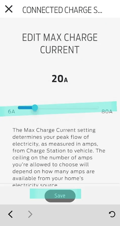

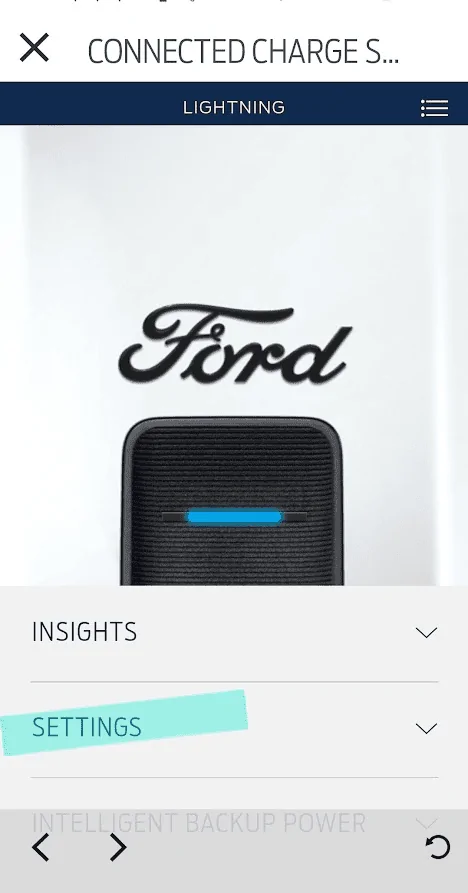

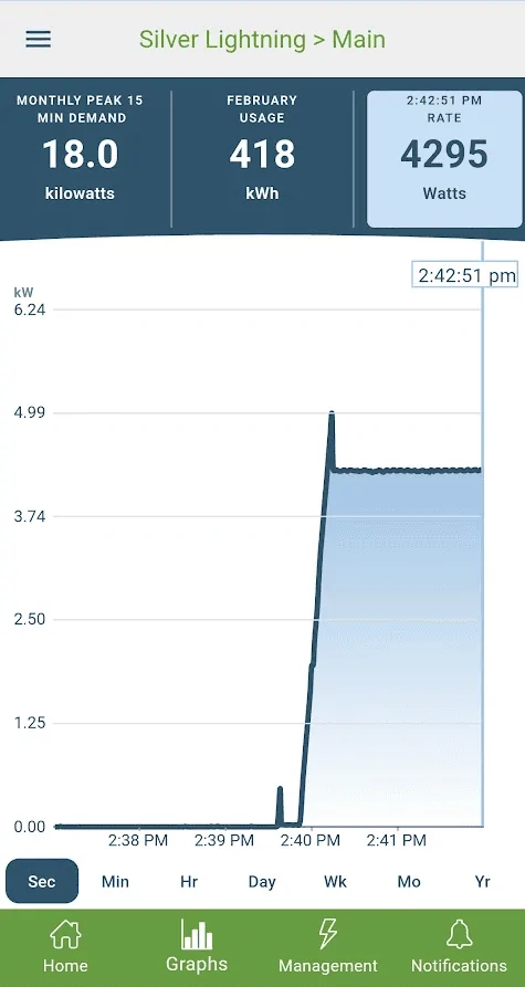

Another technique not mentioned here that we cannot do with Ford’s charging system is to set the rate of charge at a lower speed when charging at home - this comports with Mickey’s advice to charge slower and with less heat. I charged my former Teslas at 20 amps overnight, even though our home chargers were both Gen 1 Tesla wall charges and could put out 80 amps. At the higher amps, 60 or above, the cables would get very hot, almost seem ready to melt, and it was clear that the car preferred slower charging, so if doing so overnight, why not do so more gently? Perhaps Ford will give us the ability to throttle charging speed at some point without having to open up the wall charger?
Actually, if you're using the FCSP, it is possible to derate the current flow without opening the cabinet
Below are Ford Pass steps, and my emporia vue2 readout to confirm that derating is possible.
Account--------------------Charge Station-------Settings--------------4295w / 240v ~18 amps
