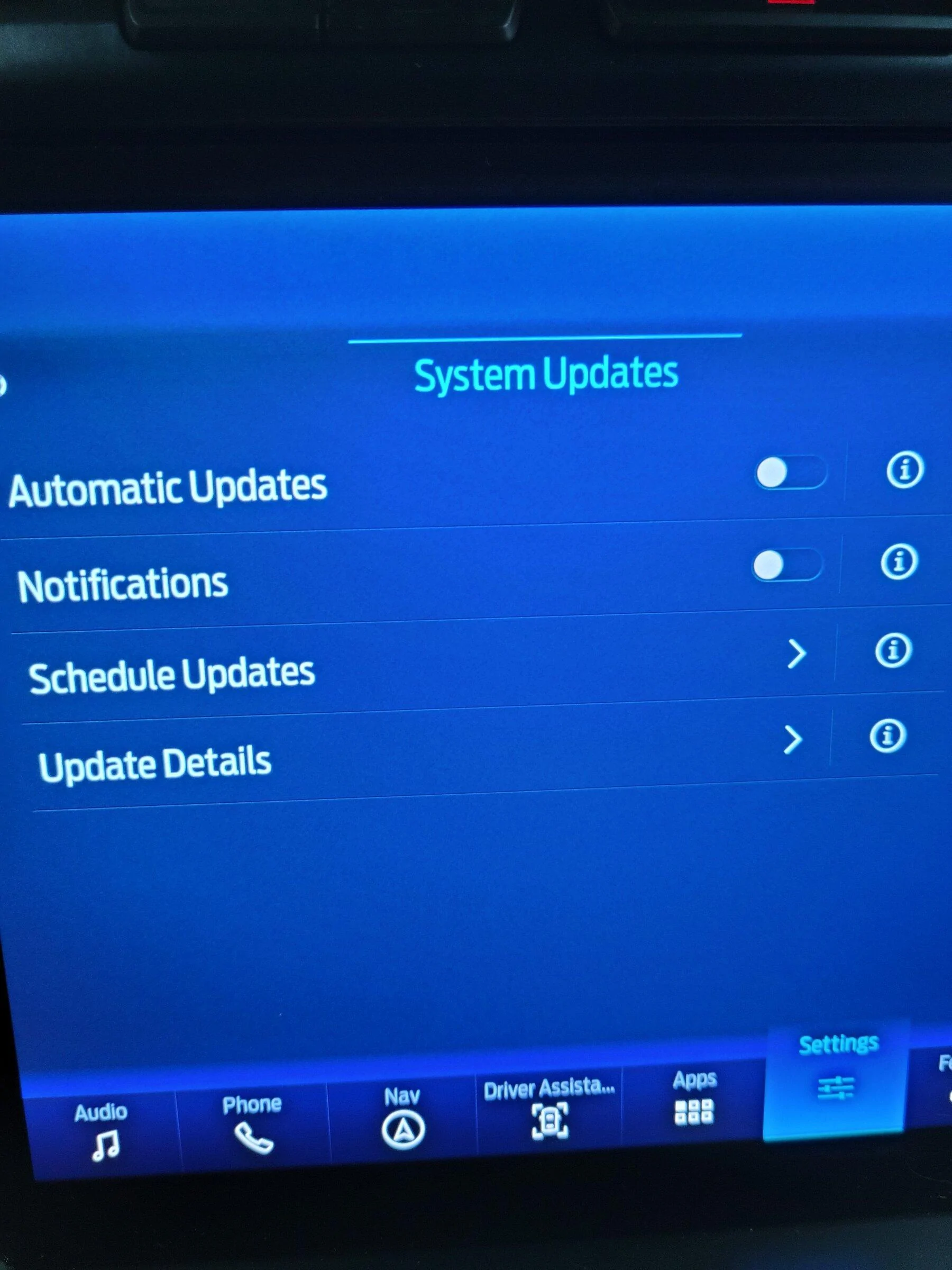

Automatic Updates and Notifications sliders will not turn on. Reading the manual did not help. Must be some simple setting I have missed. Ideas, thoughts?

Just a guess but it could be related to all the information gathering / sharing settings in some other menu. I know when I've tried disabling all of them, something else I did want got disabled.

There are a bunch of threads about this in the sync/OTA section etc.

After 6 days of checking before going to work.
Still,, dead slides, no version and no revision numbers.
Has the status on your truck changed?

Hi there! Will you send us a private message with your VIN and dealership info? I can look into things on my end. Thanks!

Mines the same. Its been like that for a few months. I took mine to my dealer for them to look at and they were clueless. So frustrating.

I saw the same thing on my screen a couple of days ago - auto updates = off, notifications = off, and I could not turn them on again.
I tried setting up a schedule to receive updates every Tuesday night - it seemed to work. I'll need to check and see if that schedule is still in place

I to have the identical problem with my F-150, as well as many others on this forum and other F-150 forums. There's 100's of people out there with this identical problem, and that translates to 1000's of expensive trucks having the same problem, whether realized or unrealized by the customer.
Ford's corporate website offers only simplistic help at best. I spent over an hour on Ford chat trying to resolve this issue with no elevation in technical support and to no avial, Only to be asked in the end "I can help you locate a dealer if you would like" this only brought further frustration.
I stopped at my dealership this past Saturday to see if I could get some help or maybe an answer. The service writer looked at me like I had two heads when I asked about over the air updates, and told me "you'll have to make an appointment he doesn't know anything about it, we'll need to look at the truck". Leaving me with zero confidence they would have the ability to fix it. This appears to be an issue created by Ford and ota.
Why doesn't Ford message it's customers through Ford Pass or email and say "We recognize there's a problem with ota and we're working on it". Instead they leave all there customers frustrated and in the dark.
Please help all of us.

Same problem here. I’ll have the dealer take a look next time I’m due for an oil change. Hopefully by then they will have dealt with it on another truck.

2021 F150 Lariat: No automatic updates: Just spend hour with Ford technical support, who were amazingly helpful. After resetting everything possible 2nd tech found an internal memo that Ford is aware of the problem and is working on a solution that will have to come through the dealer programing. It is not published anywhere according to the tech. If one looks on the Sync 4, Software Version: Revision: should be followed by a number. (no number on mine) She referred to Revision "1.71" but obviously was not authorized to give out more information. Hopefully in a couple of weeks........ check with dealer.....
