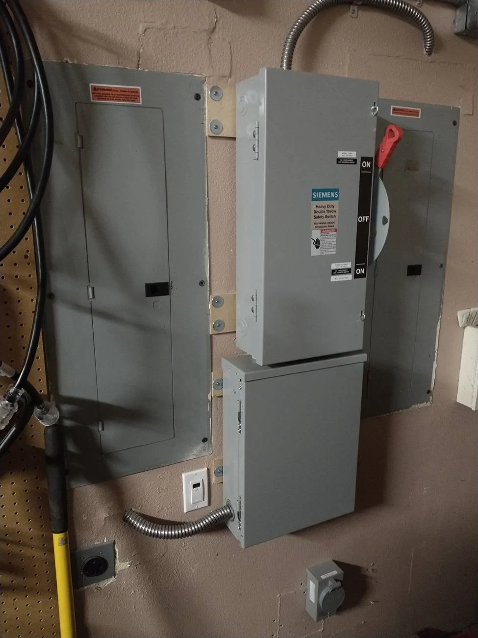

You did not say whether the truck ground wire is connected to the house.
I have a neutral switching transfer switch, I am able to power the rest of the house with the truck currently.
So much simpler and cheaper to spend $400 on a Generac 6853 transfer switch, inlet and some generator cord to avoid the GFCI tripping.
Indeed but this number ignores the time, either your own experienced time or an expensive electrician, to route circuits from the main breaker to the transfer switch breaker. I had thought the isolation transformer was a good solution, if it does whole house, because it would skip that re-wiring and be cheaper than more expensive transfer switch after you added man-hours.
But all of this is moot for me, I already have the transfer switch, yet it doesn't handle the pump, so I shall get the transformer installed and be happy with everything working.
I think my electrician was a little scared of this new idea and went a little overboard on the hardware but it worked out in the end (minus the well pump).
So it is not the Neutral grounded in 2 places problem.
It must be the well pump has an actual ground fault and that is being detected by the Lightning GFCI.
In that case a small transformer between the power and the pump is a solution, as Maquis said earlier in the thread.
