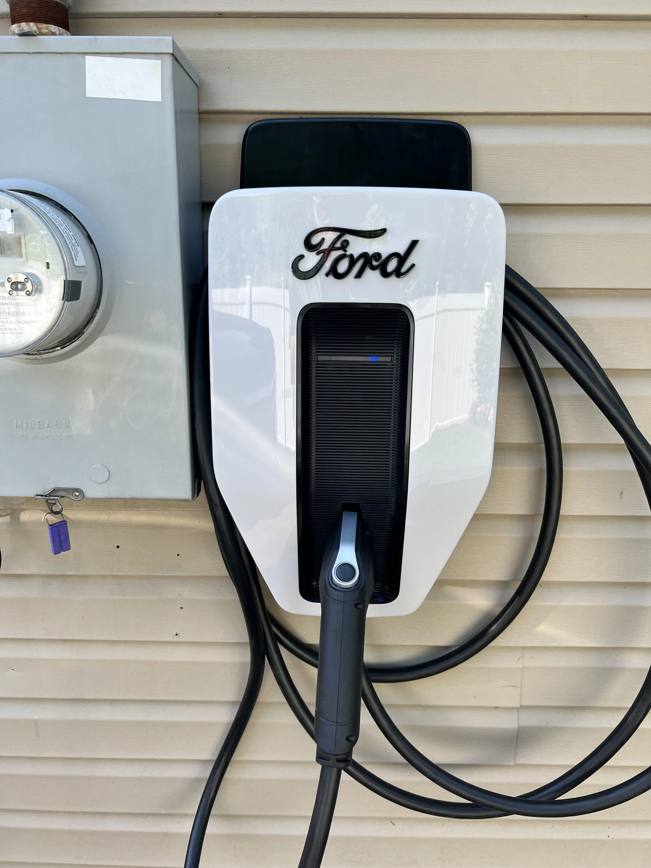

I ended up going outside because during the month of December , I do a very intricate Christmas light setup that precludes me from opening the garage doors. Took my local electrician 1.5 hours.
Now we'd like to see the intricate Christmas light setup though...
