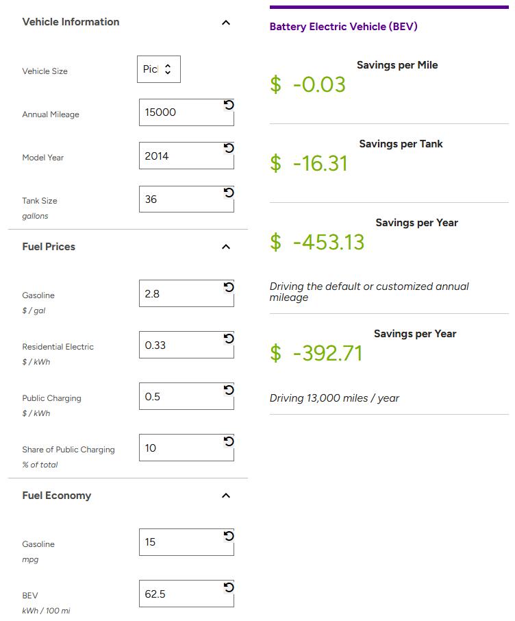

Just found this.. Drive-Electric Fuel Savings Calculator | Department of Energy
Which (when I plug in the MA prices for gasoline and electric) shows that an EV will save us -453.13 per year.
Ford F-150 Lightning Where’s the savings!!!! 1738867438472-5q
Helpful for others in expensive electric states to see what their actual cost of EV ownership will look like.
