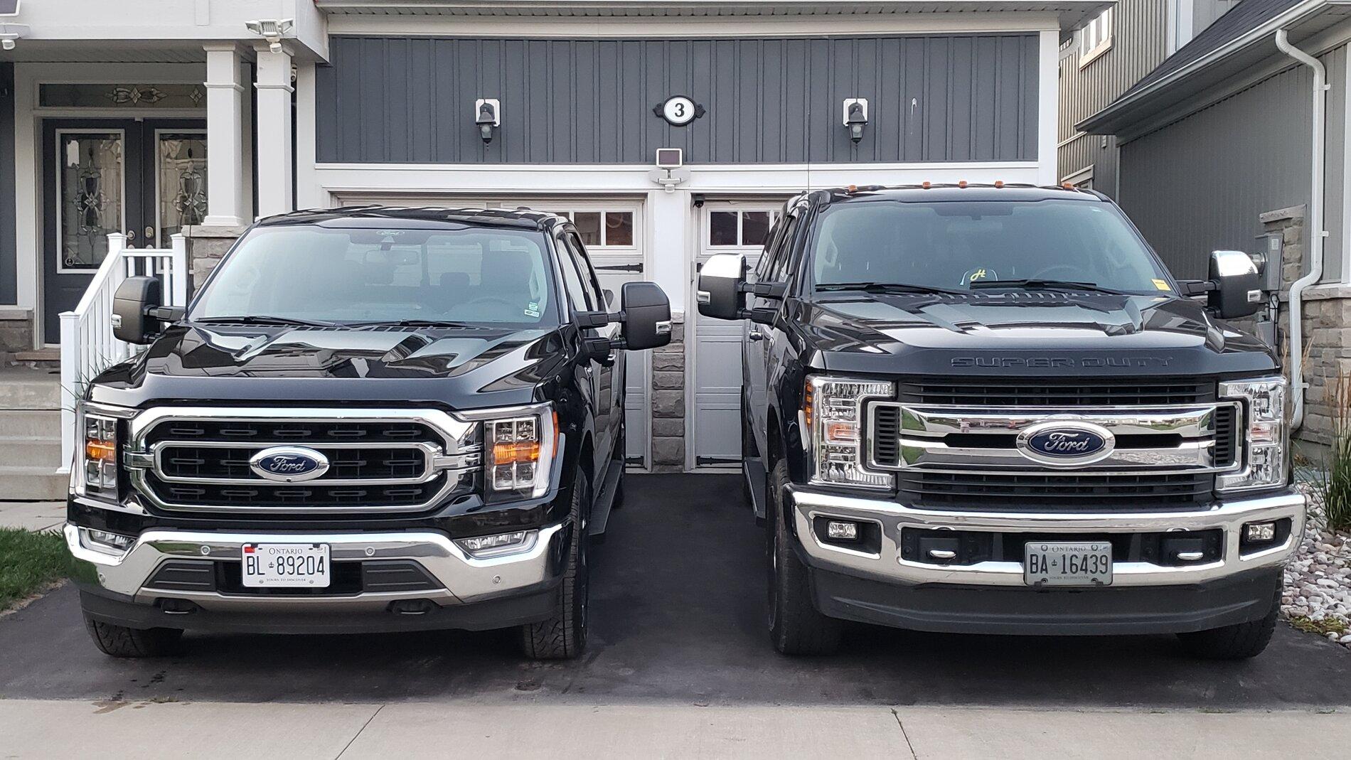

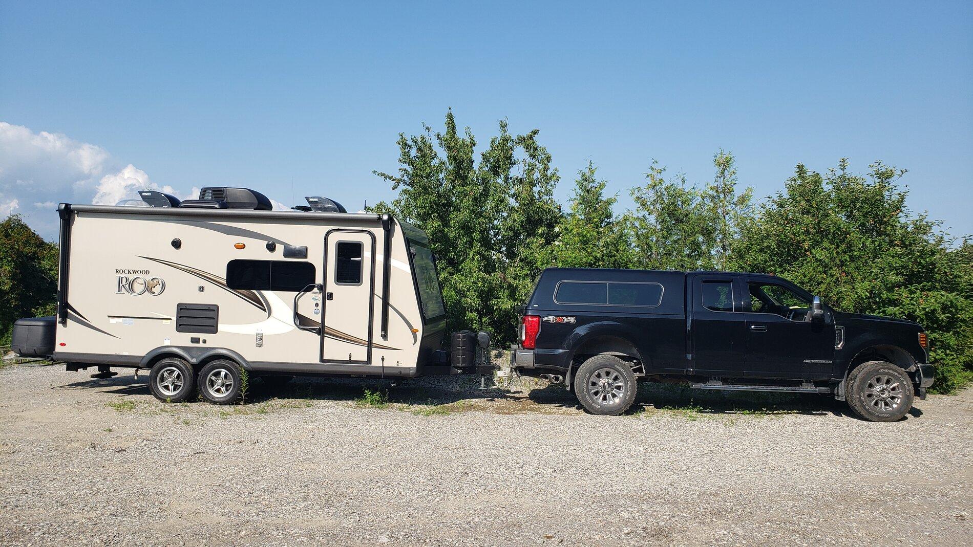

I typically look at trailers up to 70% of the vehicles advertised, at almost 14k lbs capacity that puts you right around the 10k mark. Payload does become an issue but also the length of trailer must be a consideration. I have never used a WD hitch on any of our boats, but with the travel trailer, yes, I use the equal-i-zer. Towing with the super duty has been nice, but now ready to hit the road in the F150 (time to return the F250 to parents after borrowing it for the last year). We are also looking at upgrading our Roo 183 to a bunkhouse with 1 slide out (dinette & sofa). Looking at keeping the trailer under 32ft and under 7000lbs. Reason for keeping it somewhat smaller is we like the long road trips, we are not just into camping in a small radius from our home. This year, our big trip was canceled, but hoping next year it is a go. 3-4wks, Ontario to BC and return thru Northern Canada or back thru the US.
Ford F-150 Lightning Who actually uses a weight distributing hitch? 20210803_203827
Yes I know this is just a standard hitch in below pic, this was only to move the trailer to front yard.?
