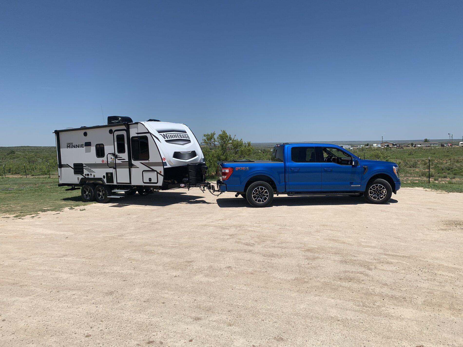

This is my very limited experience with a WDH, and my Lariat Powerboost. I have previously towed a variety of trailers, rented travel trailers, horse trailers, limited amounts of hay and some other miscellaneous small trailers with other TVs. We picked up our first travel trailer, a Winnebago 2100BH in Amarillo last Saturday. I had the dealer install an EAZ WDH.
We then towed it 390 miles back home across the panhandle through NM over Raton pass to Colorado Springs.
The trip started out good enough, only some normal west Texas wind and dust devils. Traveled at 65mph, some in tow haul mode some in normal. Went up the pass easily. No issues with acceleration at all. The uphill and downhill curves posed no problems at all. Didn’t really notice a big difference on those long relatively flat stretches, but tow haul mode was great going down the pass as it appears to use the engine to prevent unwanted excessive acceleration The real fun started near Walsenburg on I-25 when the winds picked up and we drove through driving rain, lighting, and thunderstorm. A small car ahead of us hydroplaned into the median. I admit that made me pucker some, even though I had already slowed to a safer speed, then just south of CS we got a high wind warning and had gusts of 55 mph. I could feel the gusts hit the truck and trailer but the WDH did it’s job. While I did slow down a bit from my 65mph. I got no sway at all, just a little side bump. All in all it seems like an obstacle course for a newbie like me, but it went well and I got a nice range of driving experiences for a short trip.
To say I am happy with the performance of the truck, trailer and especially the WDH, is an understatement. I’m also happy with my decision to go with the F150 Hybrid and the 2100bh and to not push the limits of the truck with a bigger trailer. The truck and trailer makes a great combo for our outdoor recreation plans and based on my first experience towing with a WDH, I doubt I would ever tow this trailer or something similar without one.
Here’s a pic of our set up.

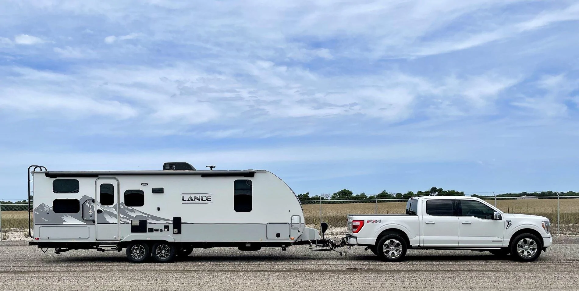

I went with a Pro Pride 3P hitch.
Very expensive I know, but my particular trailer is bad about sway. It has rear storage, tends to be light on tongue weight and the axles are very close together (I think the axle distance makes it ride more like a single axle).
Ford F-150 Lightning Who actually uses a weight distributing hitch? 61B7C42F-43E5-457D-88A3-9736D7EA12F6
And to be fair to the F150, this trailer had sway problems for me behind an (arguably old, but still…) ‘02 F250 Powerstroke.

Don, I can agree with you. I have the same brand of trailer as you do. It is by far the worst trailer I have ever towed. It likes to wonder, especially when a semi goes past you. I have found that some trailers don't have enough tongue weight to stop them from swaying. The more you raise the bars on the WD hitch the worse it gets. I have even tried two sway bars. I believe the manufactures keep the tongue weight down so they can be towed with a smaller vehicle. My water tank is behind the trailer axels, It is defiantly worse when it is full [40 gal.]. I have been towing it with a 2016 1/2 ton Silverado with 10 ply tires and tow pk. . I have not towed it yet with my new f-150. I hope it will be better.
The 3P has made a world of difference for me. I went from only being able to get to 60MPH in perfect conditions to being able to cruise @ 70MPH if I wanted or needed to.
Now I have to use the cruise to keep the speed from absent mindedly creeping up.
If you can pull it off, the 3P is an awesome investment!
