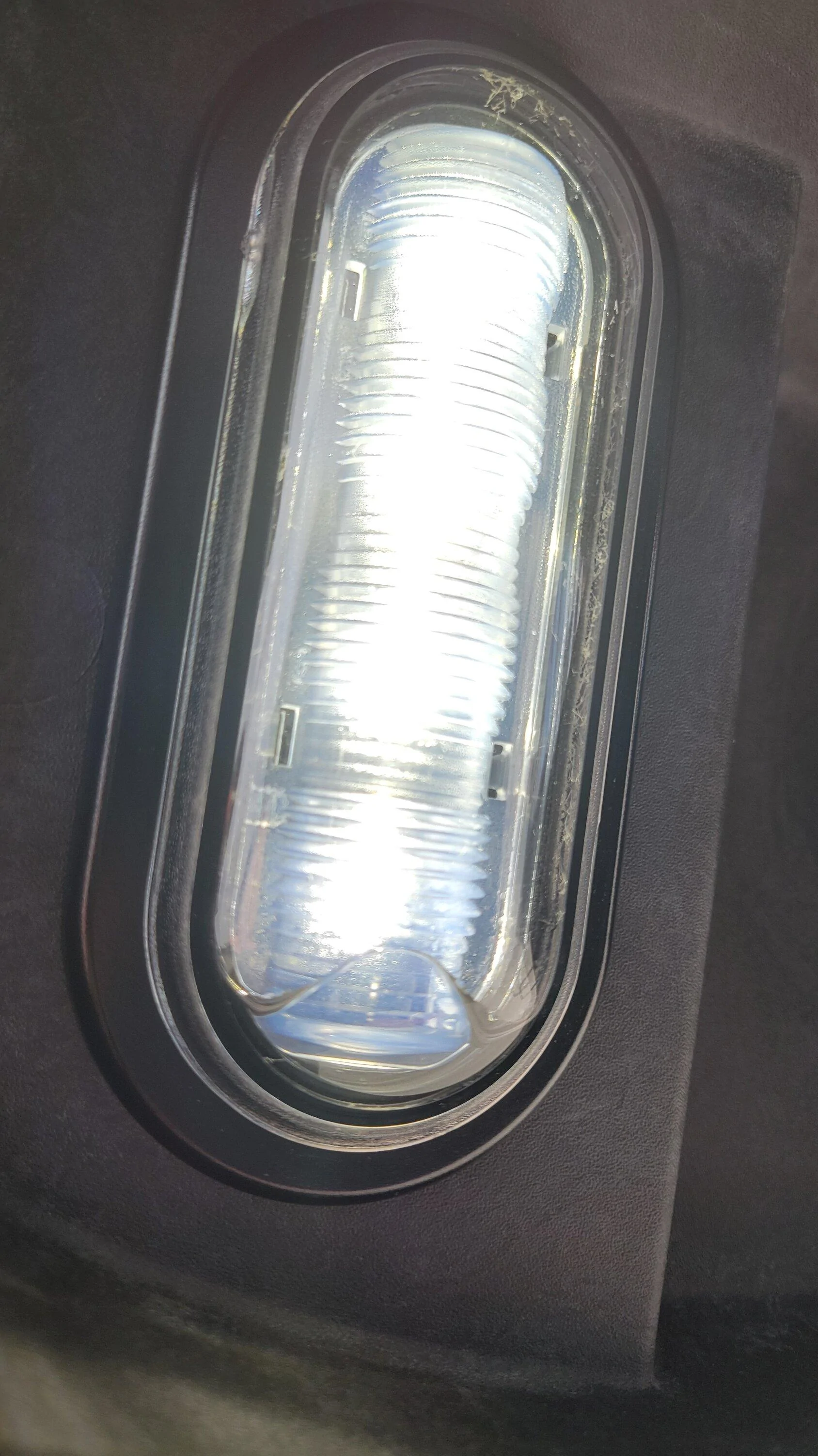

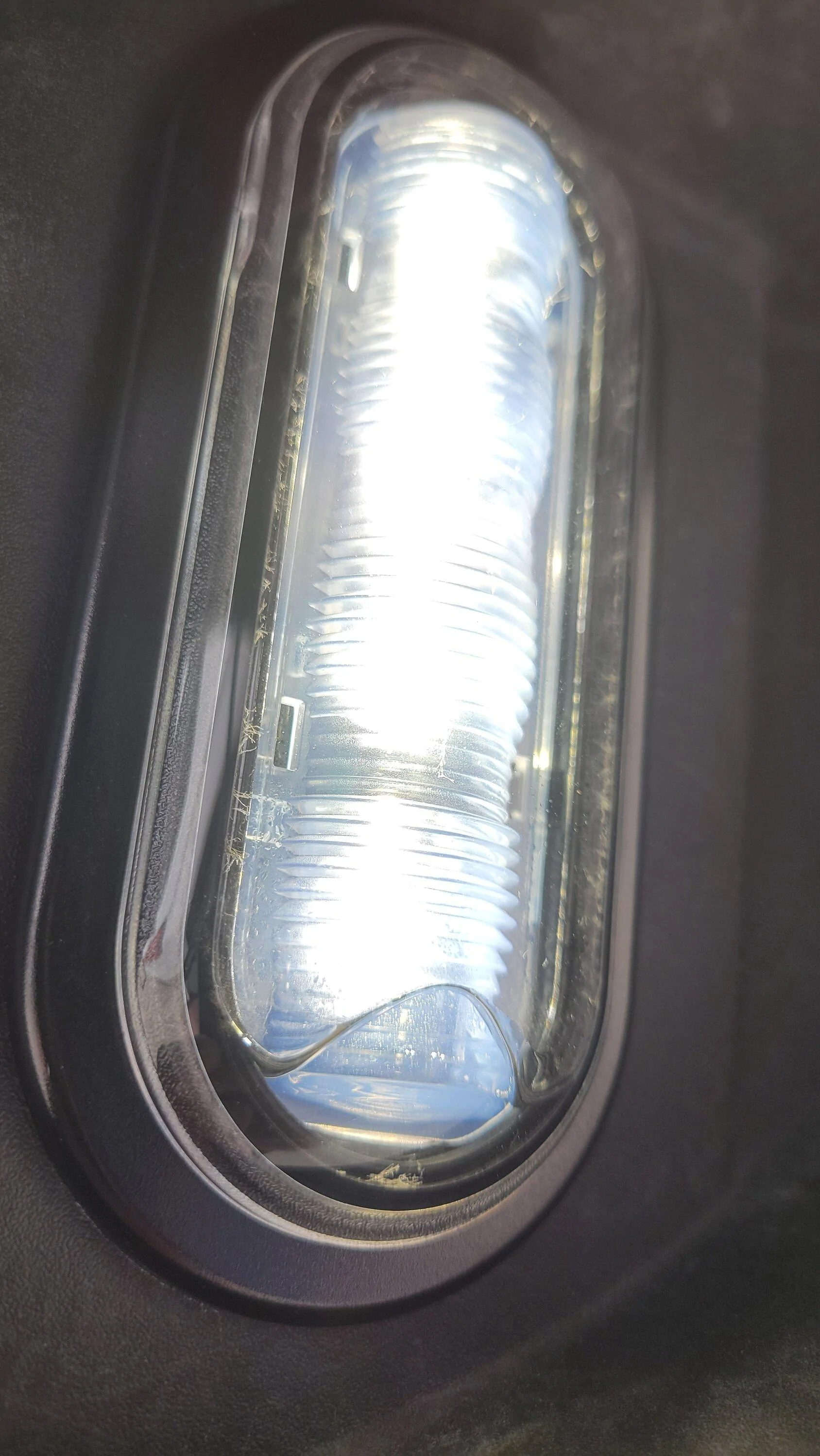

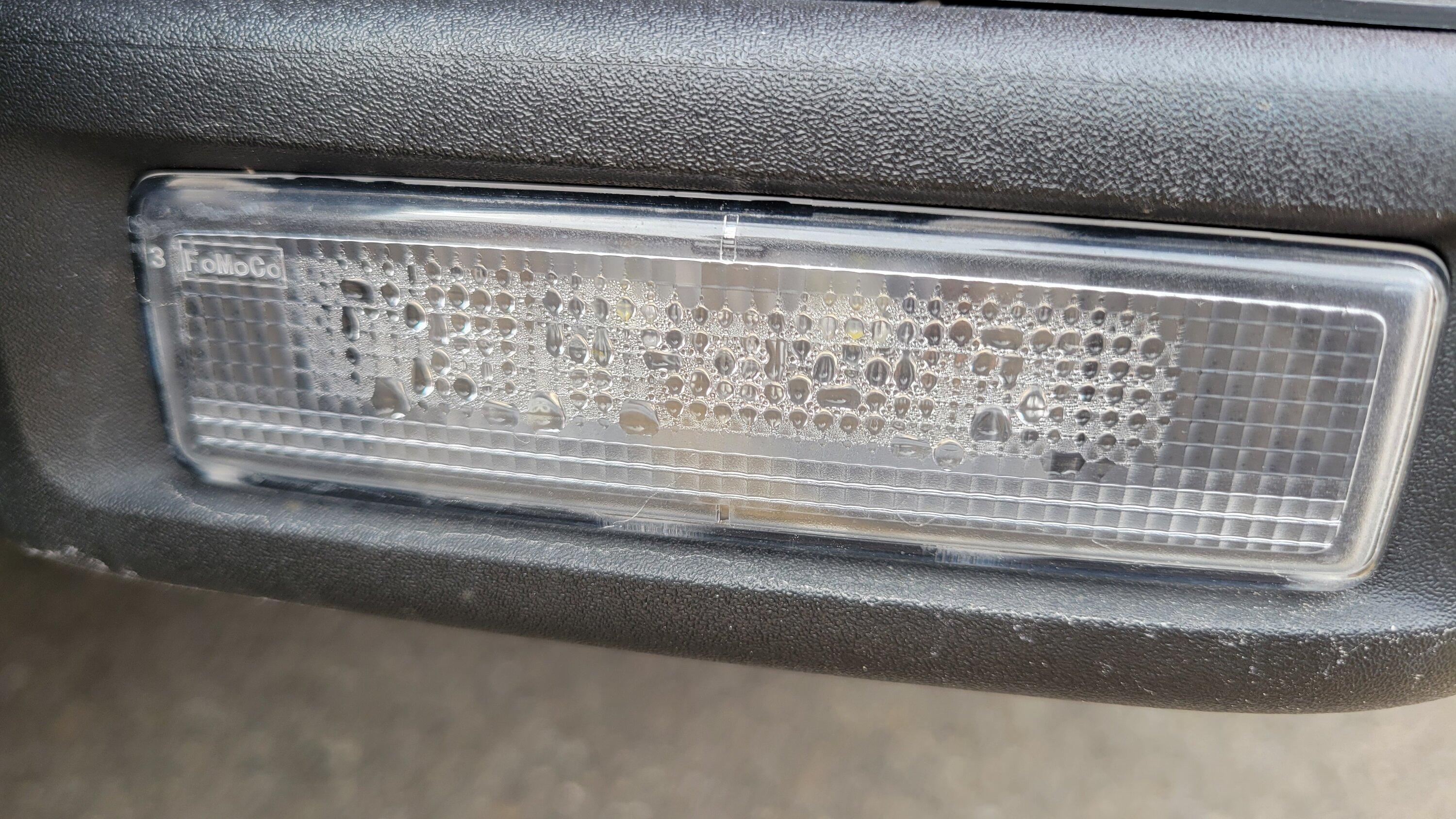

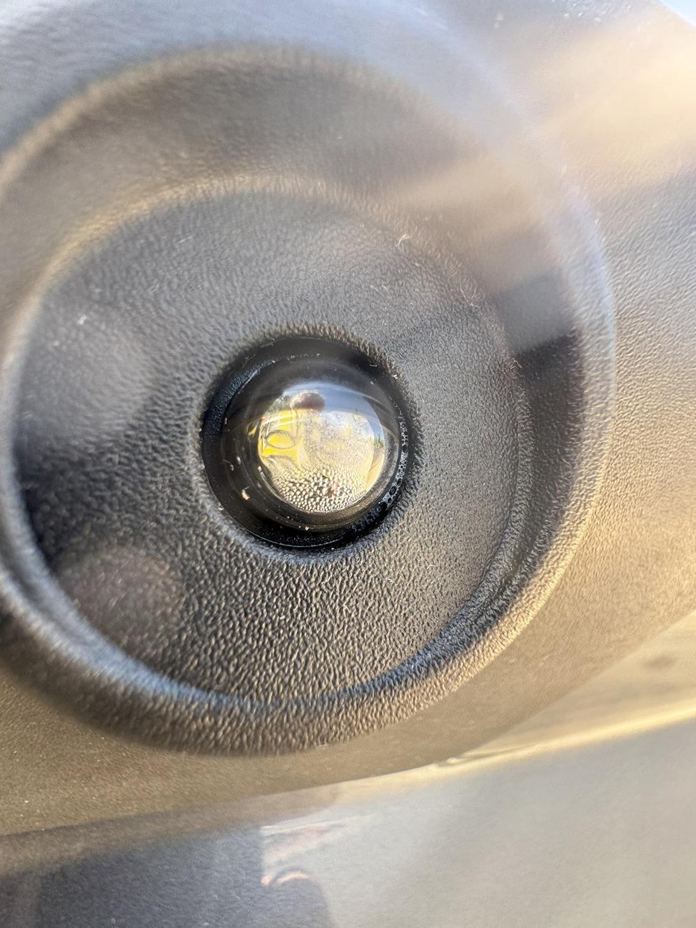

I have water in three lights and I'm guessing I'm not alone. My plan is to have them replaced when I take care of the LVB CSP.
Is anyone aware of a TSB for water in lights?
Water in interior frunk light.
Ford F-150 Lightning Who has Water in Lights? 1000003951
Water in other interior frunk light.
Ford F-150 Lightning Who has Water in Lights? 1000003952
Water in right running board light.
Ford F-150 Lightning Who has Water in Lights? 1000003953

I posted about this over the summer. I had it in my Frunk lights. Was told there's a drain path behind there and the seals on the lights were bad so took in moisture. Make sure they check the Frunk push button switch when they replace them. Mine had gotten corroded from the water going through there and stopped working immediately after they fixed the lights. I thought they pinched a wire but they showed me the back of the switch which was in bad shape from the water. Had to splice in a new harness and switch. Good luck, was a pretty quick job overall.

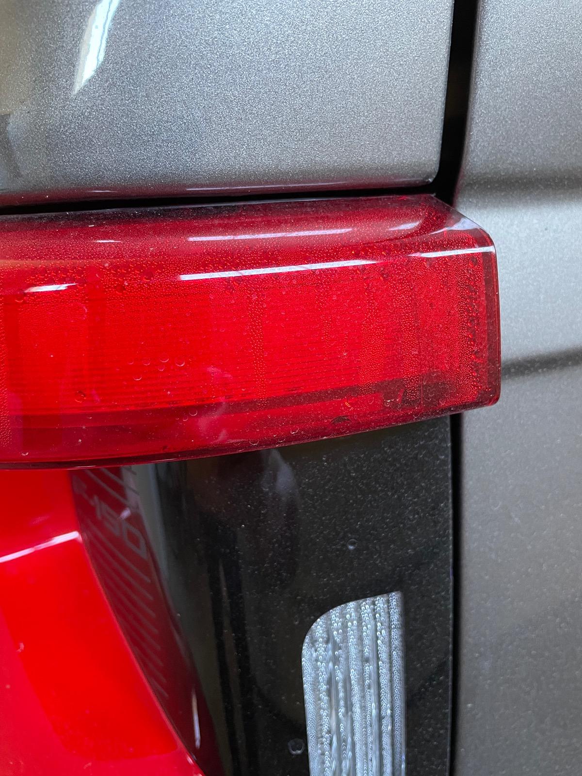

Here’s a photo of what I posted about in the other thread.
Ford F-150 Lightning Who has Water in Lights? IMG_1436
Ford F-150 Lightning Who has Water in Lights? IMG_1437
Thanks! Your thread is probably where I got the idea to look at the frunk lights. I've been actively ignoring the problem but the thread yesterday made me think of it again.
I have the EXACT same issue in my tail lights- condensation. Thought it was just me.

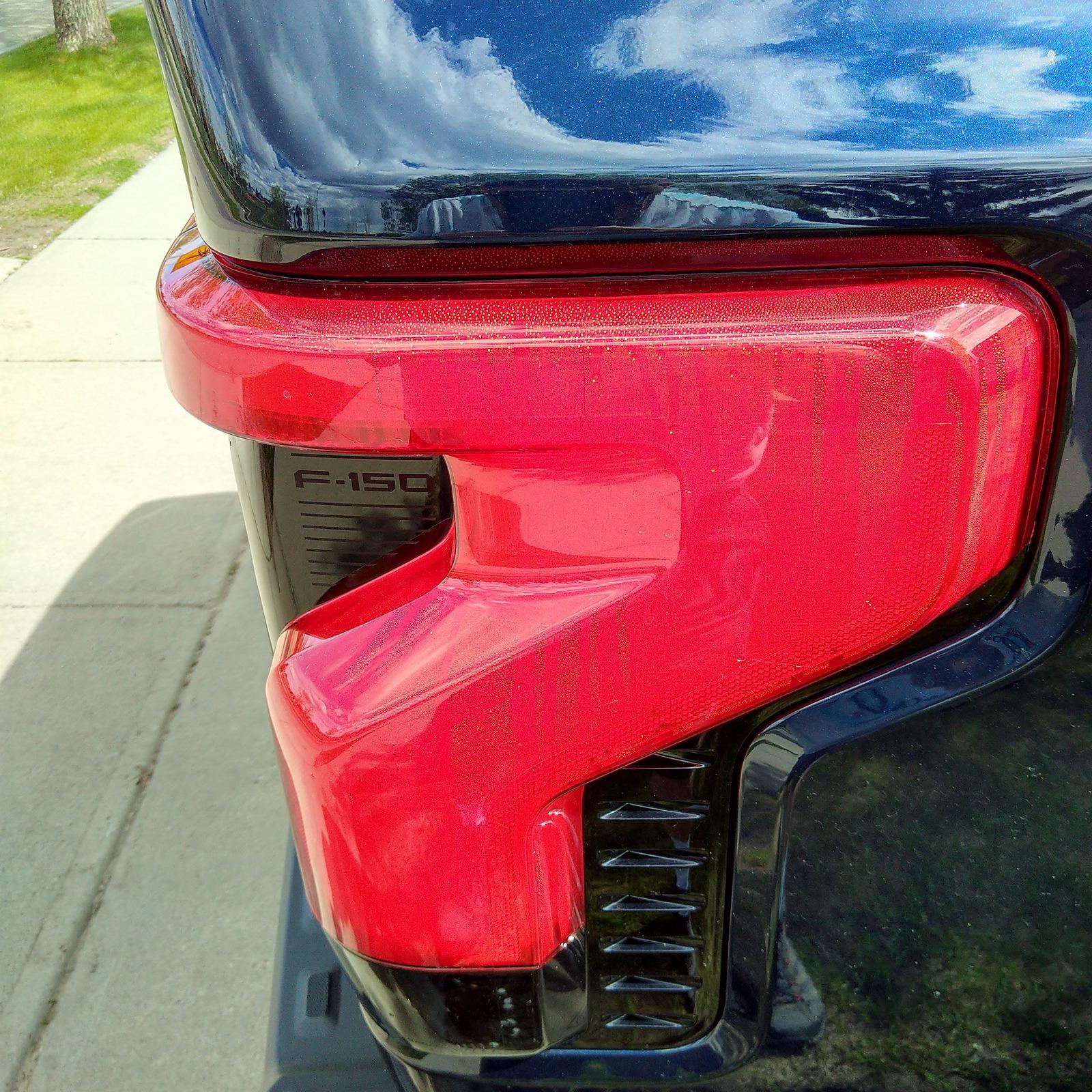

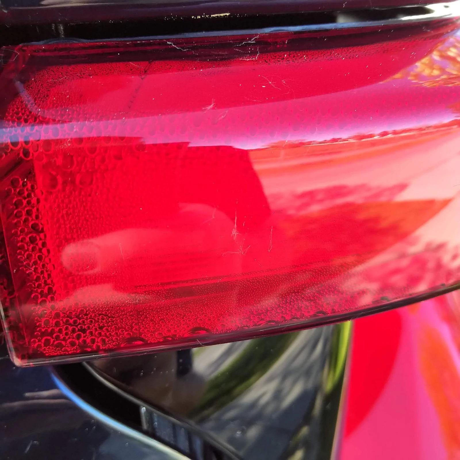

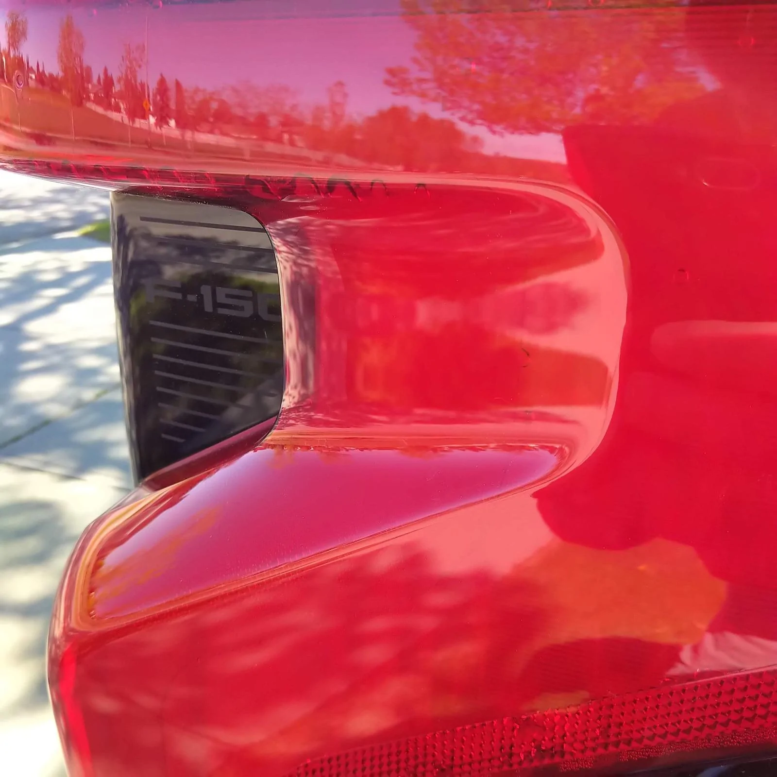

I have moisture in the RH taillight. i had my dealer inspect it on friday and they have ordered a replacement tail light assembly, which should be here by the end of June.
Ford F-150 Lightning Who has Water in Lights? IMG_20240604_1025596
Ford F-150 Lightning Who has Water in Lights? IMG_20240603_1525480
Ford F-150 Lightning Who has Water in Lights? IMG_20240604_1026169

I can't believe how much of a problem this appears to be.
As much as I am against frivolous recalls, I'm all for one for the tail-lights. I mean, compared to the light-bar recall( which was considered a safety issue) recalling tail-lights is justifiable under the safety flag too if they fail(and mine did) to blink as a result of the moisture.
The funny thing is, I bought a FORD because, well, FORD's been making trucks for quite some time now - you'd think they know how to make a turn signal waterproof by now :)
In any event, glad warranty covered it, but a little sad to see others with the same issue.

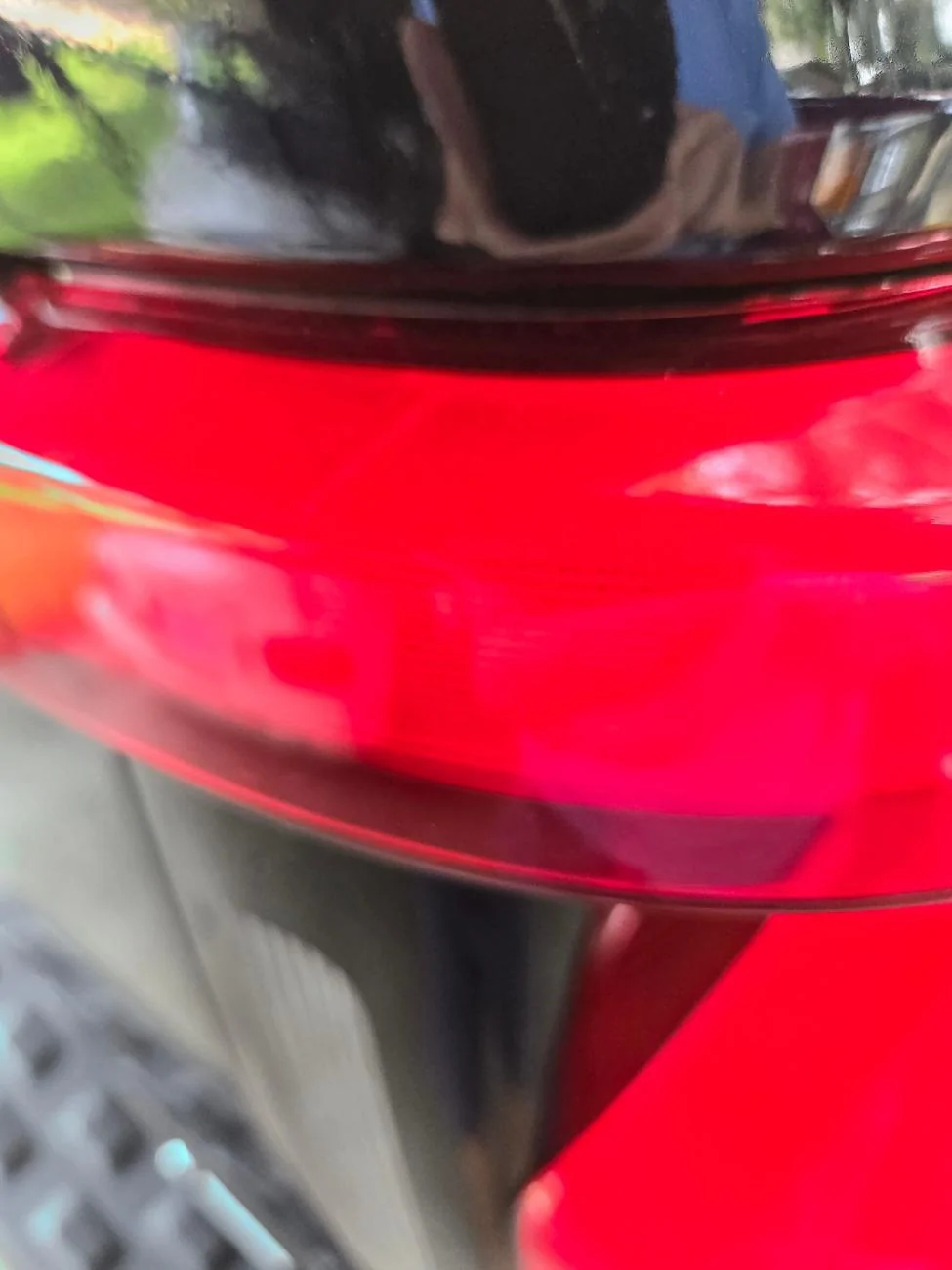

I have condensation in the left twilight and backup light. I just got the truck on Friday, and will see what Ford has to say about it tomorrow.
Ford F-150 Lightning Who has Water in Lights? 20240712_170313

Update: I finally got around to taking my truck to the dealership but when I checked the lights they were all dry and functional. No big deal, I guess.
My original post was in March. My guess is any water intrusion wasn't able to evaporate out over the cold winter months but the warm summer did the trick. My truck lives outside.
