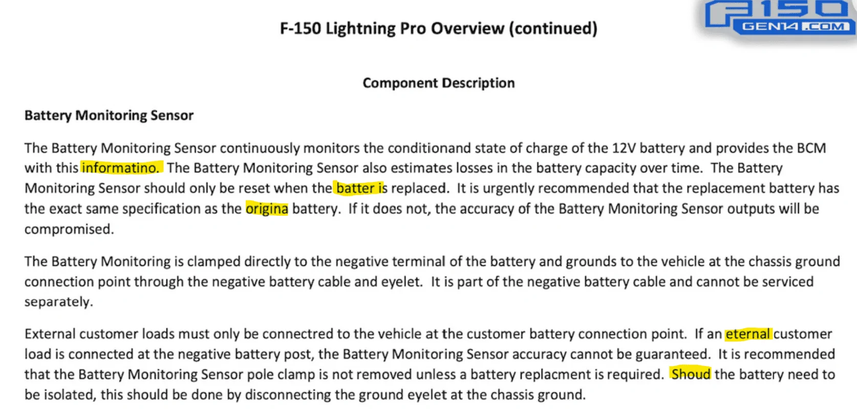

https://www.f150lightningforum.com/forum/threads/f-150-lightning-electrical-system-overview-–-w-12v-battery-power-and-ground-points.7461/
Check out the PDF in this post and page 6 in particular, it lists the conditions where the onboard DC/DC ( HVB to LVB) charger kicks in.
Some good info here, seems like OTA updates should interrupt the normal automatic 48 hour 12v check/charge and force it to charge up the 12v battery. It also seems that an extremely low battery will also interrupt that check and force a top-off as well.

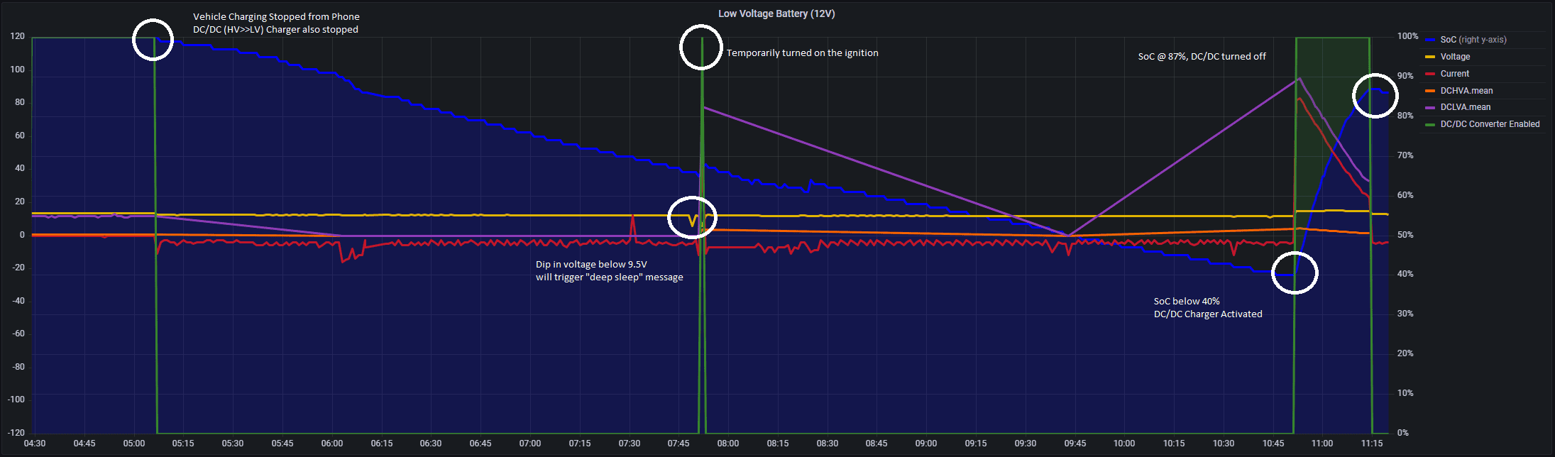

Thought you might find this interesting, it's from a logging session I did this morning with the vehicle turned off.
Couple of things worth noting...
1. When plugged in / charging, the 12V battery is "trickle charged" by the DC/DC converter
and all load on the 12V system is coming from the DC/DC converter rather than the battery.
At the first point I stopped the charging from my phone, plug still in the car and at that point the DC/DC converter is also disabled. (not sure if this is also the case if the set charge limit is reached or only if/when you stop the charge completely)
2. Even a short dip in voltage (orange line) will trigger a "Deep sleep" message. In my case it was twice in a 5min window (I only log every minute). So the warnings people get can be false positives.
3. Once mine got under 40% SoC the onboard DC/DC converter kicked in, charged the battery to 87% and then shut off again.
4. The current draw on a vehicle that's supposedly turned off is quite high (bounces between 4-6A) Granted - I'm scanning the OBD every minute and I'm not sure what that does in terms of not letting modules go to sleep, so I'm not sure if 4-6A is normal for a vehicle that's shut off (I'll verify that later) But, if it is, that means that the 35Ah battery we got will last just about as long as you can see in the graph below (6hrs between "fill-ups") if this is normal, it means the battery will go through 3-4 drain / recharge cycles per day.
5. If this is "normal" then what is the expected life of the 12V battery ?
AGM batteries have relatively short lifespan (from what I can read up on), the deeper the discharge the shorter the life. According to some sources if you discharge to 40% (like in my case) you can expect around 800-900 cycles. 900/4 = 225 days or 7-8 Months life expectancy.
Granted, it all depends, if you drive a lot and charge a lot (so that the 12V is handled by the charger / DC/DC converter most of the time) you'll get a lot more. But if you, like my self, don't drive that much the 12V battery might be a thing you'll have to change every year.

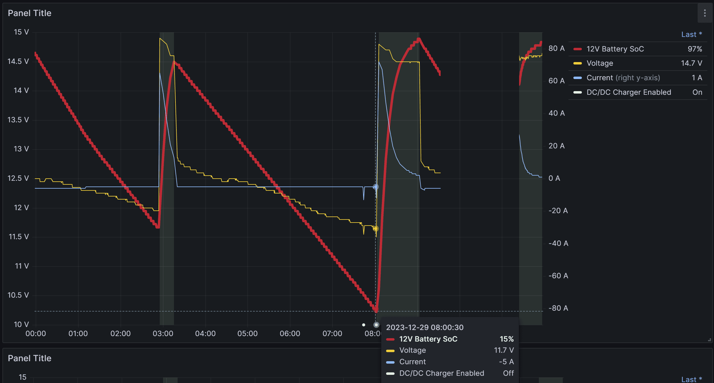

I noticed something really interesting / concerning this morning after running another "all-nighter".
This time the onboard DCDC charger kicked in around 3am and @ 40% SoC on the LVB (as it should).
But then 3hrs later when the battery, for the 2nd time, reached 40% the onboard charger never kicked in !?
If I understand it correctly the 40% is somewhat conditional and subject to a 48hr "grace period" where it may or may not kick in, but supposedly, at 30% it's an unconditional charge/activation of the DCDC charger.
Well, as you can see, in my case it never activated again.
I let it go as low as 15% before I "chickened out" and started the truck and that's when the onboard DCDC charger started as well (around 8am).
In the past (it was a few software updates ago) it would do the 40% re-charge several times in a row, so it's a bit concerning to see that even a super low (15%) SoC won't trigger the onboard DCDC charger.
