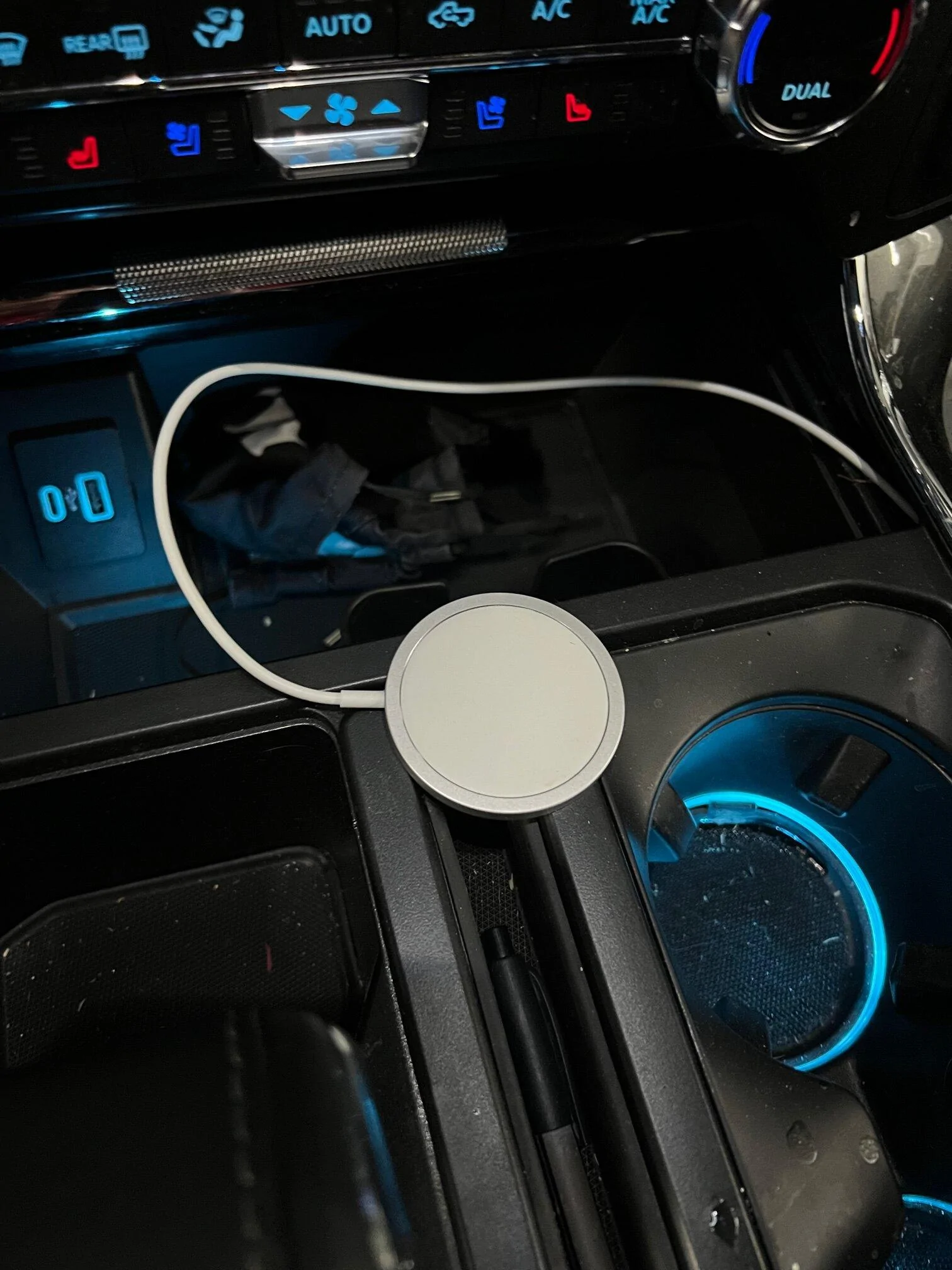

I used a standard MagSafe charger. Ordered a 2.5inch flush mount from Etsy. Removed the cubby which is a pain because you have to first remove dash parts around the radio and the AC controls. I found a YouTube video on that. Removed the cubby. There are for screws holding it in 2 in front and 2 behind the sliding door. Those are hard to see. The sliding door comes out after those 4 screws are out then the cubby is held in by clips. Drilled a 2.5 inch hole in the cubby and installed the MagSafe and flush mount. For power I installed a usb socket in the back of the console. The one I got enabled quick charge.I debated wiring it to the back 12 volt outlet but ended up running power from the fuse box in the passenger kick panel. The magsafe wire is run through the console and plugged into the socket. Had to drill a small hole in the Console storage to get the MagSafe wire inside to plug it in. The attached picture shows where the socket is installed. You can see the MagSafe charger plugged into it. You could really put it anywhere, I just thought the back would be easy to access for another usb accessory if needed. Below are the parts I used.

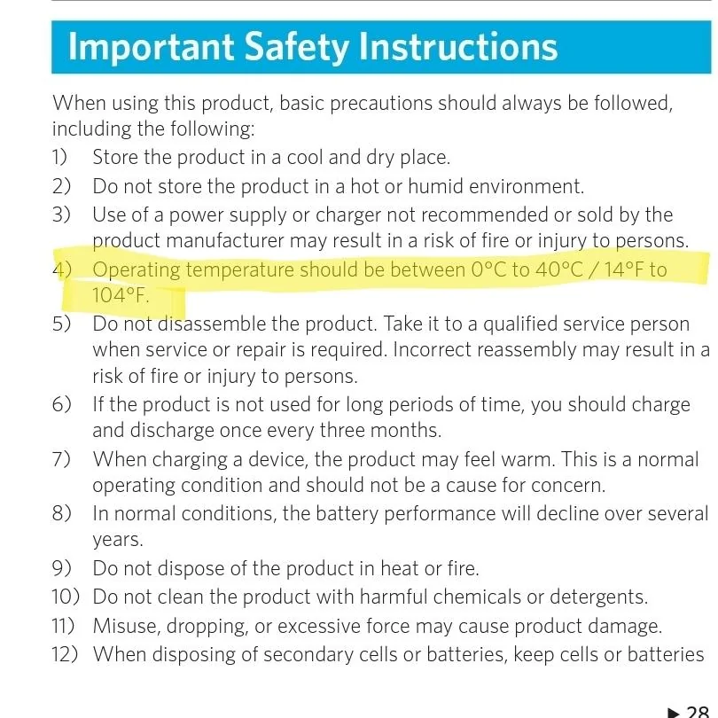

I thought about installing this "mod" in my truck but when I read the manufacturer manual, I was a little worried about the temperature range that is recommended.
Ford F-150 Lightning Wireless Phone Charging for Lariat and Below Models Screenshot_20211224-160851_Adobe Acrobat
I'm pretty sure it will get hotter the 104F at least down here in SC during the summer.
At least in the past there were histories about power banks/batteries catching fire.

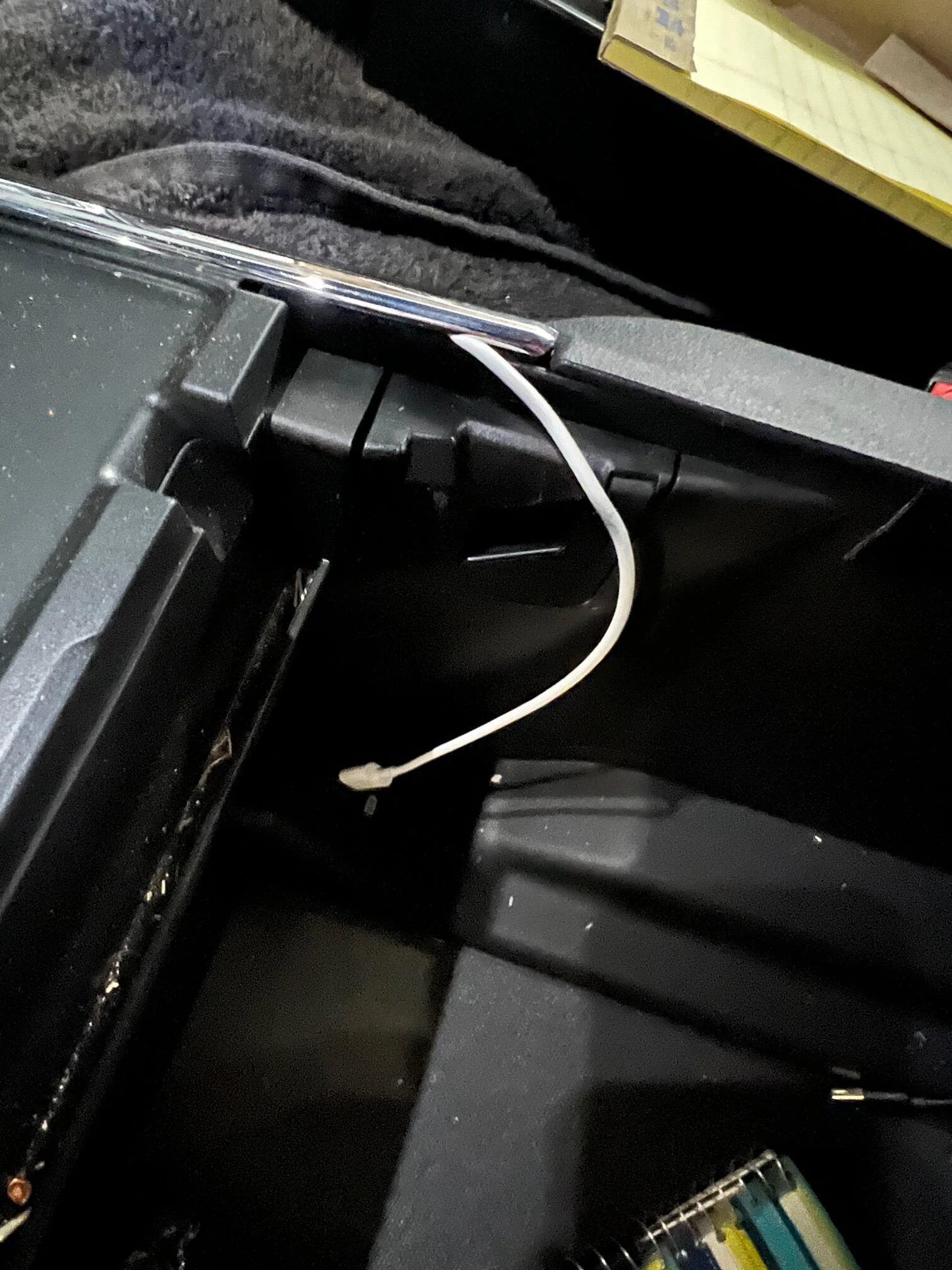

When I plugged an Apple Wireless Charger into that USB-C port, I got an error, saying to unplug it, I guess it was drawing too much power. I ran the cord from the charger down the passenger side of the shift console in the the center console and plugged it into the USB-C port in there, it works great.
