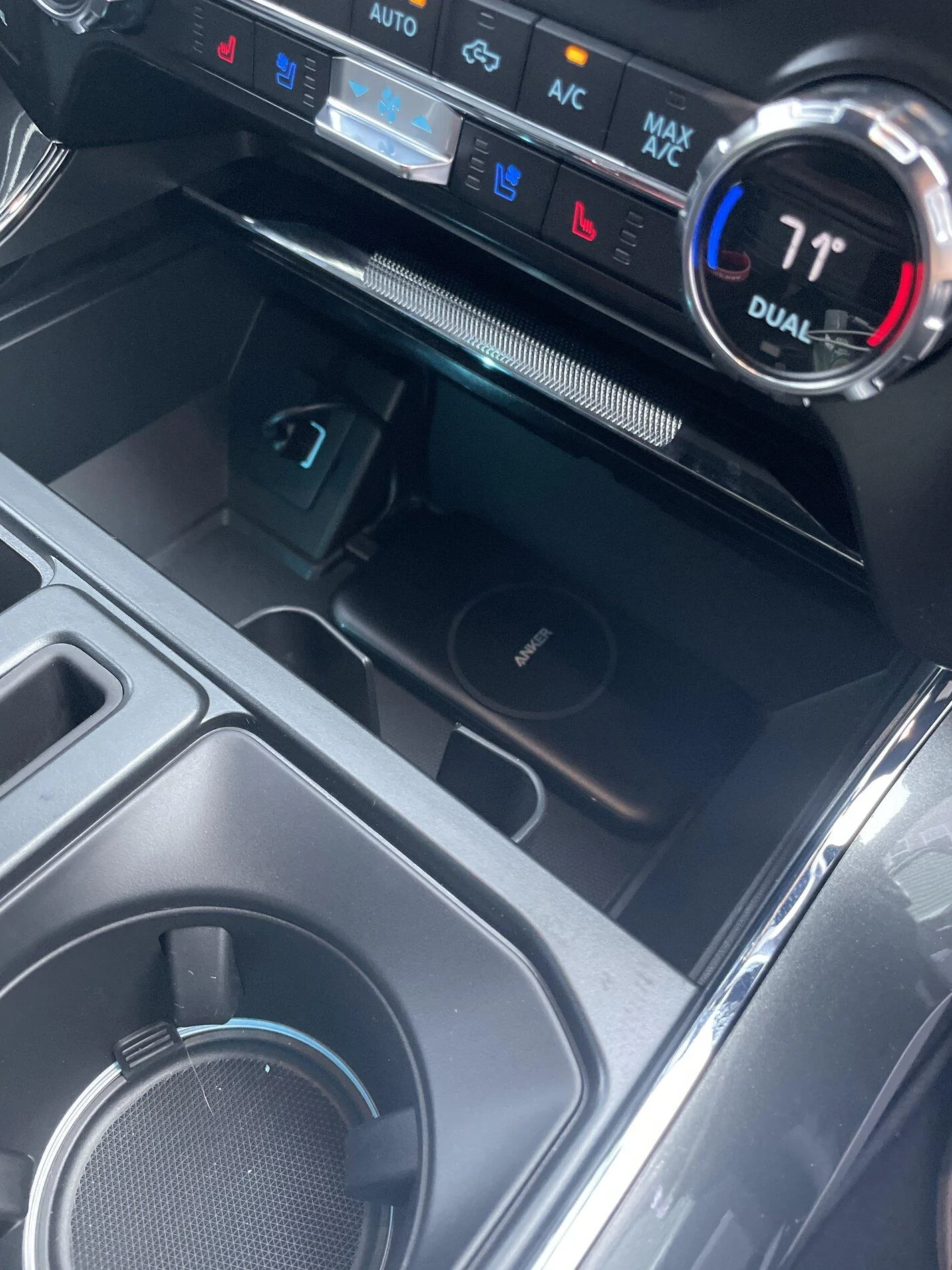

Thank you again @Knickell for posting. Received my truck on Friday and just added this setup. Works perfect with wireless CarPlay and lets me close the lid to satisfy the OCD.

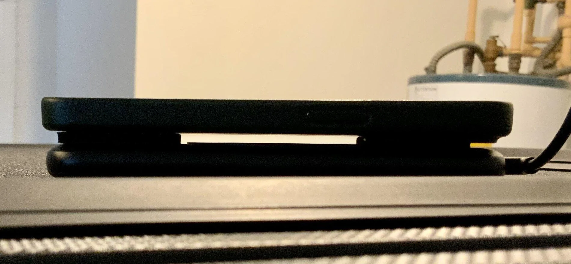

I just got a new iPhone 13 Pro with an Apple leather case. The new case has a bigger lip around the camera. It lifts the phone just enough that it the rubber bits on this charger don't touch the case enough to hold it.
When I turn or accelerate my phone just slides off.

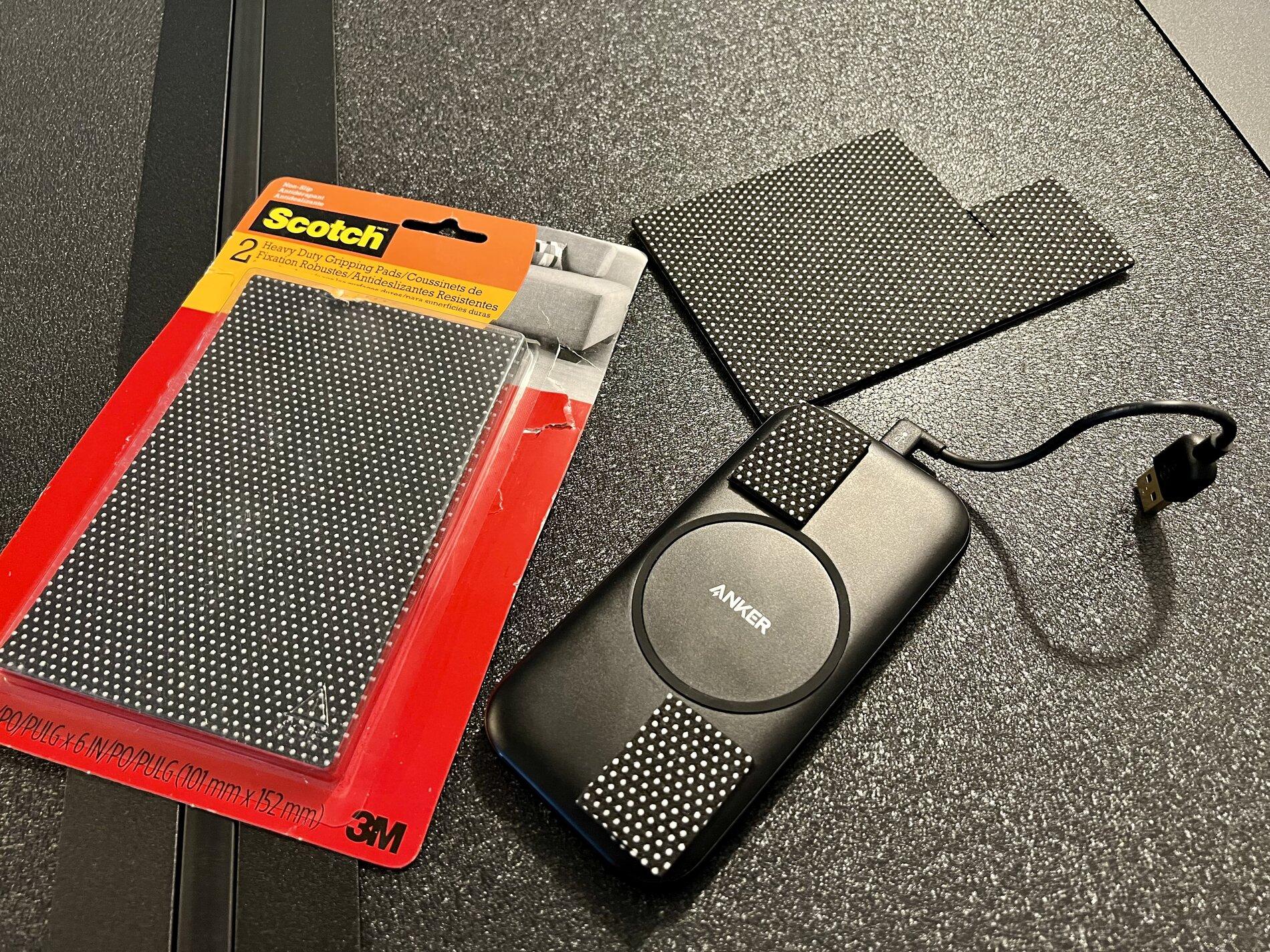

Update on the issue with the iPhone 13 Pro camera bump and Apple leather case. I tried out some different solutions and ended up with this which works pretty well:
I bought these Scotch Heavy Duty Gripping Pads for about $4 at Lowes.
Ford F-150 Lightning Wireless Phone Charging for Lariat and Below Models C1CBC2BC-3111-4DF3-B861-EBBEF6AF4B5B

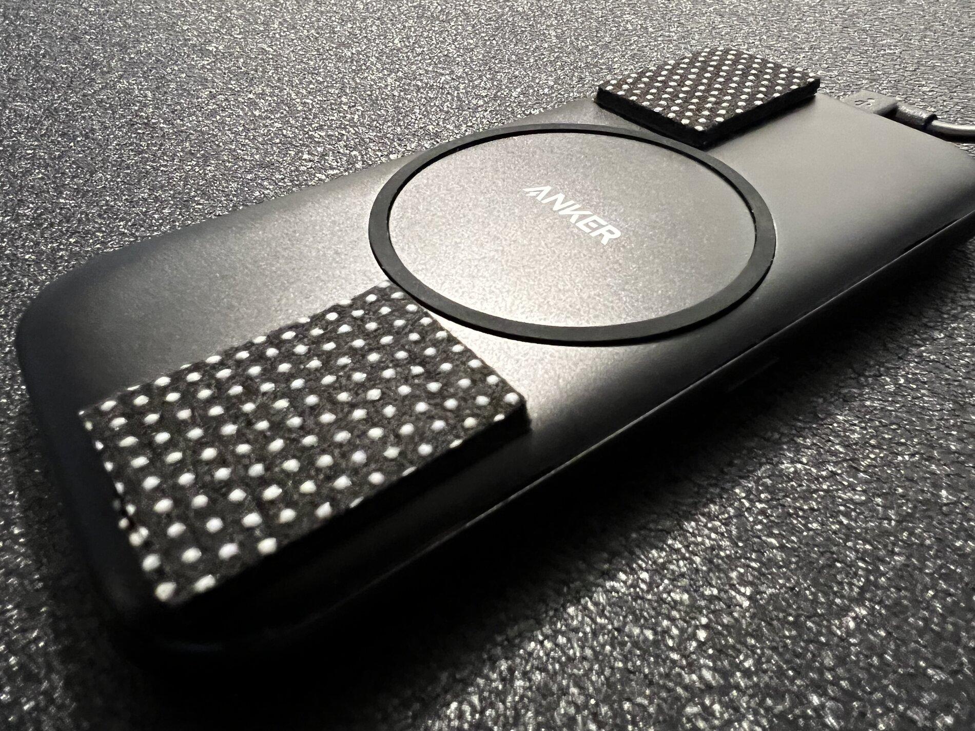

I cut some small squares for each side of the charger which leave room for the camera bump to not be touching the pads. This allows the full surface of the pad to grip the phone instead of just edges if the camera raises the phone.
Ford F-150 Lightning Wireless Phone Charging for Lariat and Below Models 7ABEEACE-39F1-47CF-9DF5-ED45C0AE6352
The material is soft (no way it could scratch) but grips well. It's not glue or tape... it doesn't leave any residue on the phone. The back is a peel off sticker to hold the pads to the charger.

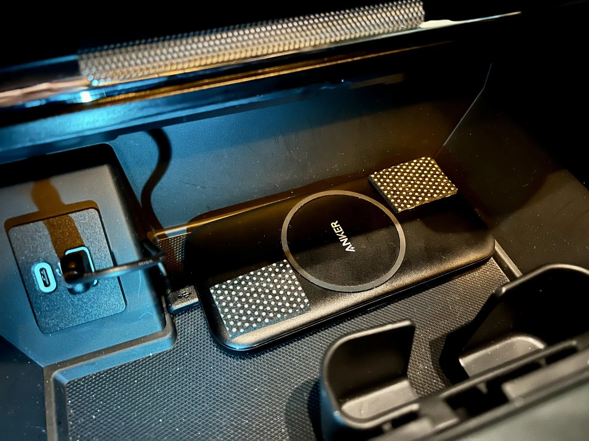

Ford F-150 Lightning Wireless Phone Charging for Lariat and Below Models FDCCA790-390F-4E53-8541-ED6BC914D89E
The charging area is raised but it is still close enough to charge. However I don't know if charge power is lower at that range. Update: I drove around for an hour streaming music and using Waze and the battery charge increased from 72% to 84% so no issues there.
Ford F-150 Lightning Wireless Phone Charging for Lariat and Below Models CD8CF1E9-A8E9-429B-B281-04A4A051D312
Just these little square pads are enough to hold the phone in place during normal driving conditions. Again this is with the Apple leather case but I think it would work with other cases too.
Very nice! Looking good! ? ⚡

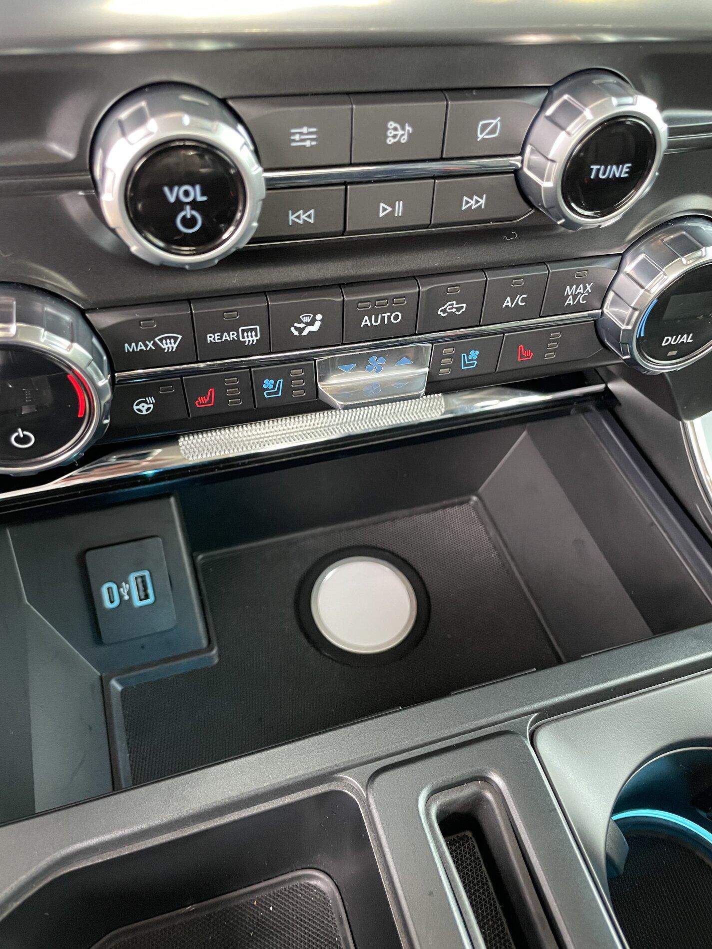

Well I took it one step further and installed the MagSafe charger in the little cubby. Turned out good. Now I just throw my phone up there and it charges
Do you have links to the parts list? Where did you tap in for power as I see both USBs are still open. This looks very clean. Would love to do this to my truck.

Wait.... how did you run your power? This is exactly what I want to do.
Agreed!!! I attempted something similar, but always got an error when the MagSafe charger was plugged into the USB-C in that cubby. So, love the placement, but curious how the power is run as I don’t see any of the cords (which is a plus)!

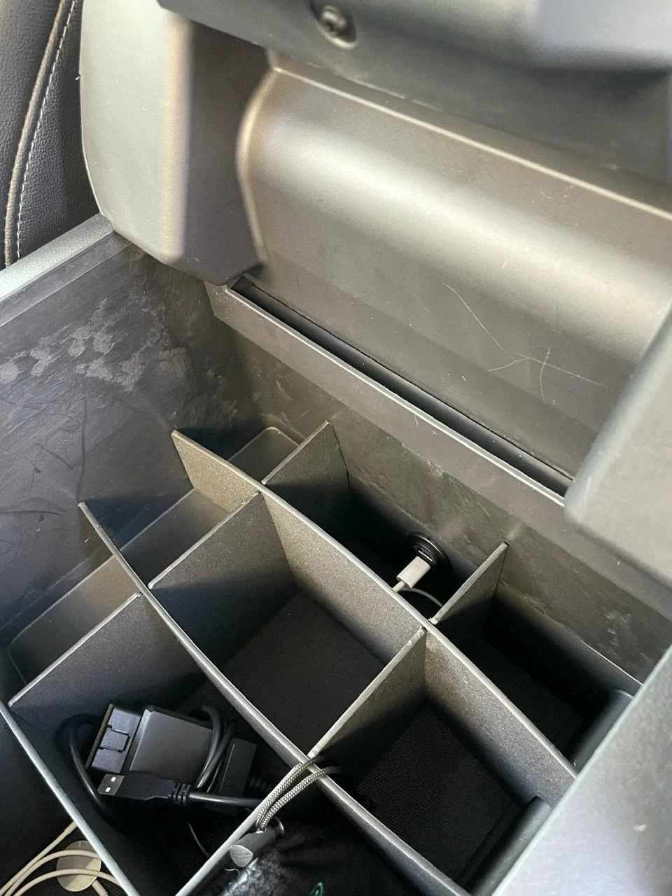

I used a standard MagSafe charger. Ordered a 2.5inch flush mount from Etsy. Removed the cubby which is a pain because you have to first remove dash parts around the radio and the AC controls. I found a YouTube video on that. Removed the cubby. There are for screws holding it in 2 in front and 2 behind the sliding door. Those are hard to see. The sliding door comes out after those 4 screws are out then the cubby is held in by clips. Drilled a 2.5 inch hole in the cubby and installed the MagSafe and flush mount. For power I installed a usb socket in the back of the console. The one I got enabled quick charge.I debated wiring it to the back 12 volt outlet but ended up running power from the fuse box in the passenger kick panel. The magsafe wire is run through the console and plugged into the socket. Had to drill a small hole in the Console storage to get the MagSafe wire inside to plug it in. The attached picture shows where the socket is installed. You can see the MagSafe charger plugged into it. You could really put it anywhere, I just thought the back would be easy to access for another usb accessory if needed. Below are the parts I used.
