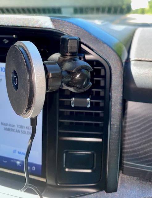

I remedied that...

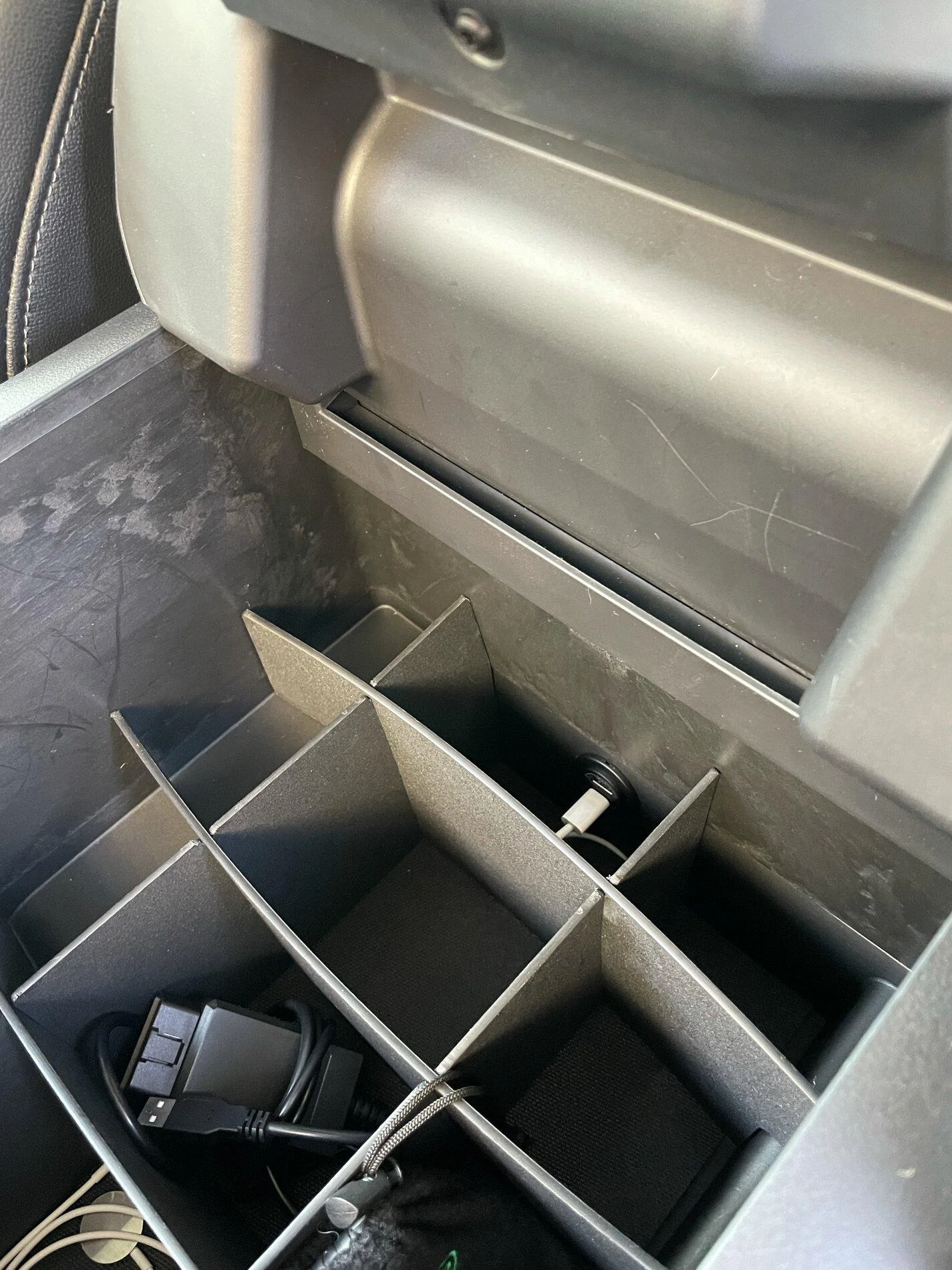

I added a dedicated USB A and C socket to the back of the Center console storage under the arm rest. Ran the Magsafe cable back to that. This way I get the full 15 watts Magsafe Charging. This is the charging socket I used. Connected it using fuse taps in the panel at the passenger side. Amazon.com: 【2021 Lastest】 Quick Charge 4.0 PD Type C and Quick Charge 3.0 USB Charger Socket, AlfredDireck 12V USB Outlet Car Power Outlet Waterproof Socket with Dual Ports for Marine Boat Motorcycle Truck Golf : Automotive
Great work! Thanks for the info. Now I've got my next little project queued up.

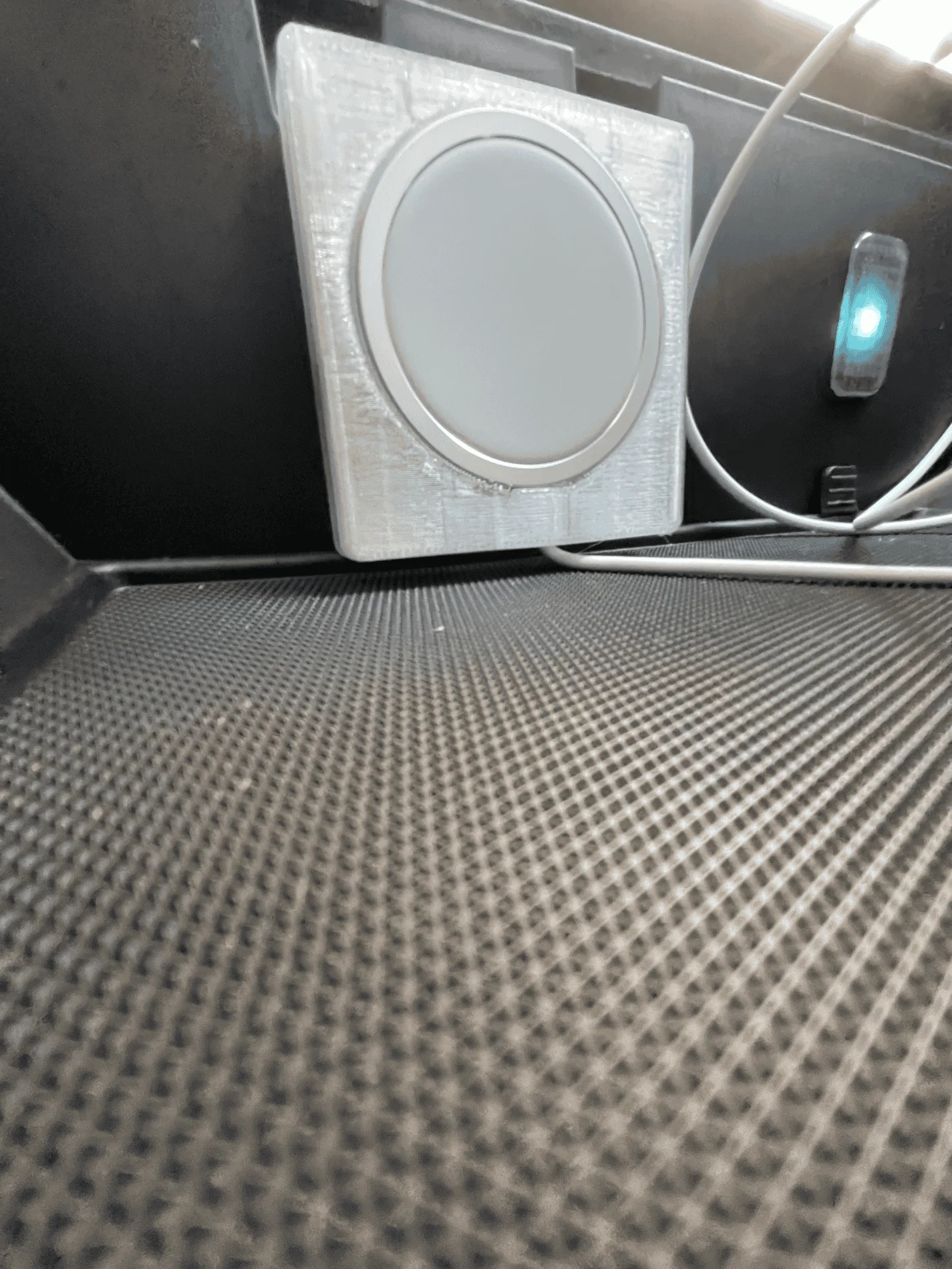

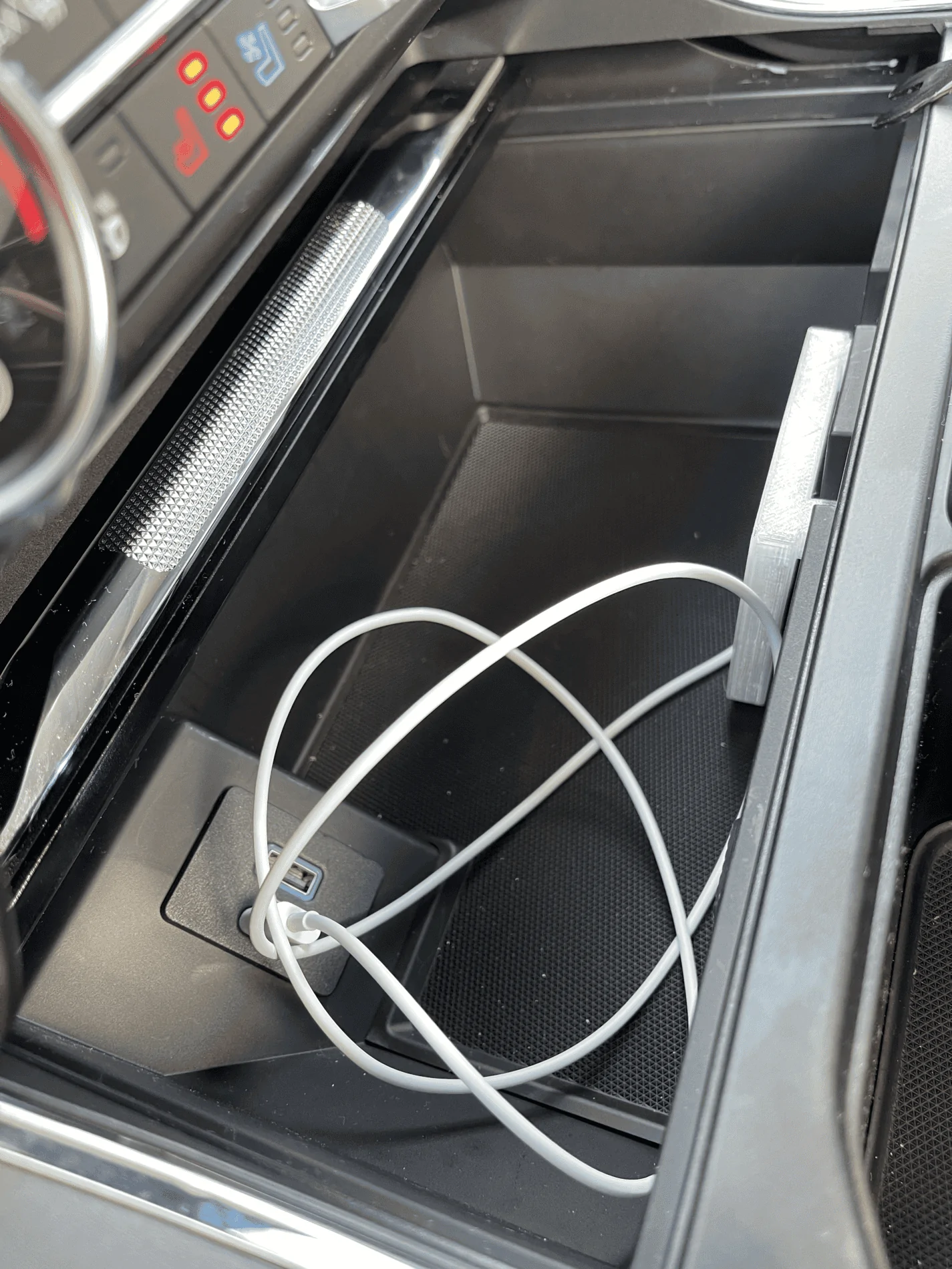

Posted this in another thread, but I took the dove tail slots for the weird phone holder slots in the center console and 3d printed a holder to put a magsafe charger there. Don't have any pictures right now of the current one, I prototyped in this clear one. Ended up changing the cable to come out the side, cleaned up the cable, and made it black, but general idea below:
