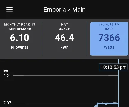

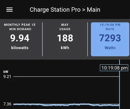

I'm charging both my vehicles tonight. I usually calculate what I need to get to 90% and do the math to what charge rate I need to set to get to that level during my "super off peak" rate time. I adjusted my Emporia level up to 32 amps to match my FCSP. They are very close to each other.
Ford F-150 Lightning With reduced amperage setting, does Charge Station Pro still charge faster than equivalent amperage chargers (Chargepoint/Flo/Emporia etc)? Screenshot_20230423_221856_Emporia Energy
Ford F-150 Lightning With reduced amperage setting, does Charge Station Pro still charge faster than equivalent amperage chargers (Chargepoint/Flo/Emporia etc)? Screenshot_20230423_221911_Emporia Energy

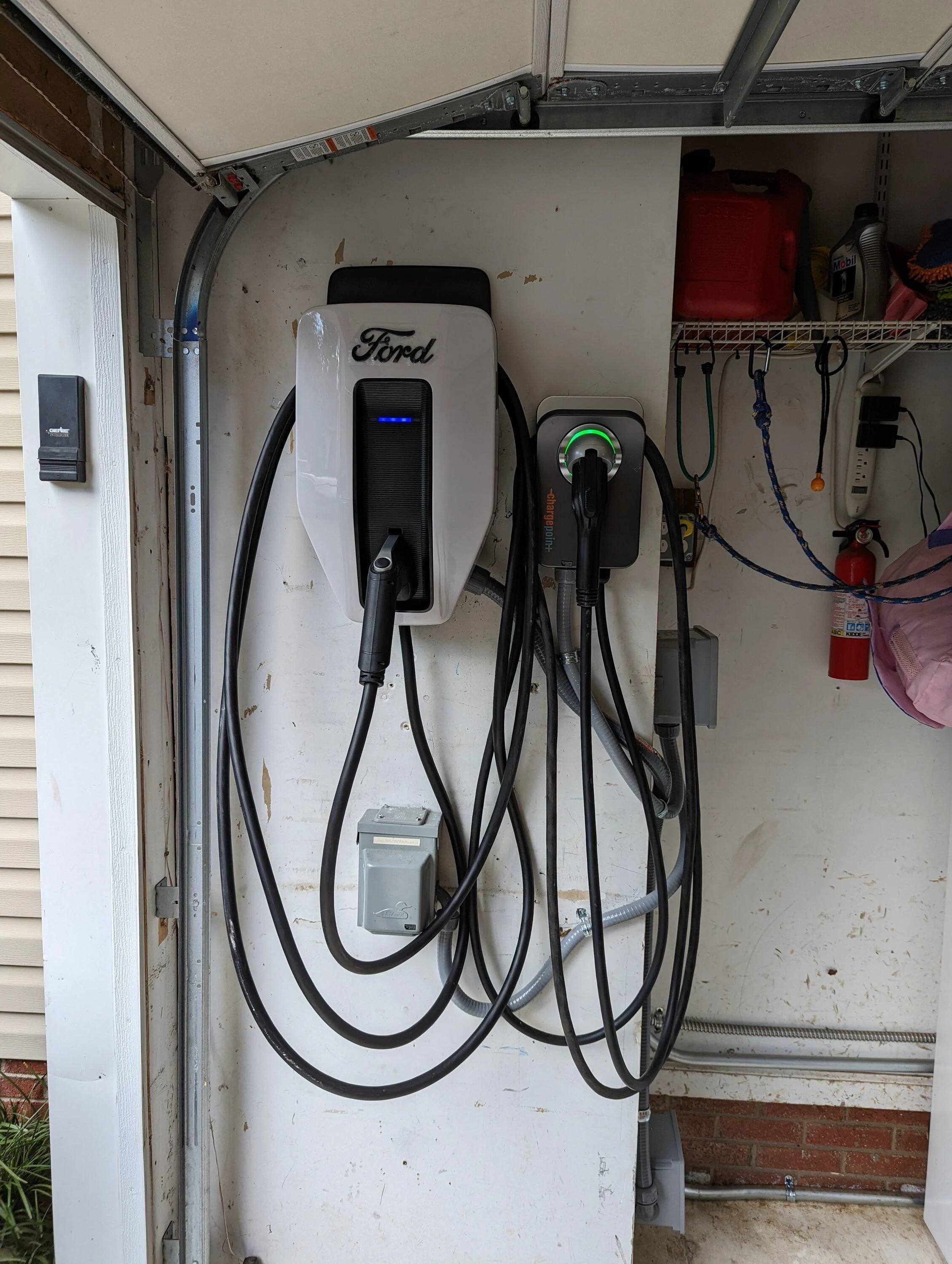

I am the owner of two(2) charging wall boxes. First came the Mach E with a ChargePoint Flex 48amp box. The max the Flex can do on a 60 amp C/B is 35 mph equivalent charge. A year later came the Lightning with the Charge Pro wallbox. Factory setup is 80 amps. Once that Siemens wallbox started operating correctly, it will charge the max rating until it overheats and goes into a cool down mode. Charge Pro will charge at 45-50 mph equivalent charge.
Big battery, bigger Charger but if I want the Mach E charged quickly at home, I will use the Charge Pro wallbox. I am happy with both of them. Also, my Charge Pro came with the truck, part of the Lariat package and Intelligent Back Up option. So it is used constantly. It is preference and the option to do Intelligent Back Up Power.
Ford needs to work on their Power Pro app.
Sometimes it works and sometimes it just an empty app(useless).
