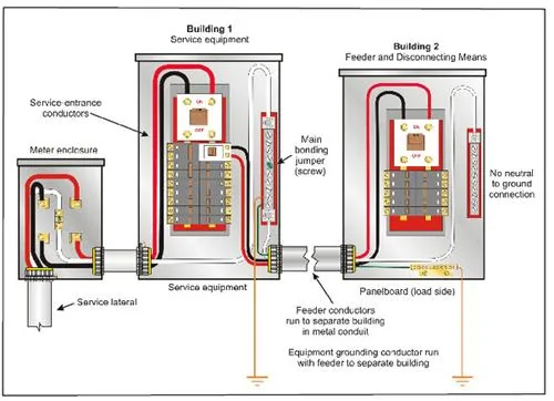

Wiring a sub-panel in an out-building is equivalent to what you should be doing through the transfer switch, where the "out building sub-panel" is your circuits in the transfer switch being powered in the house by the Lightning. The neutrals should not be grounded in the sub-panel since they are already grounded at the main panel, in your case, the Lightning, but you still want to have a continuous ground between the Lightning and the sub-panel.
Ford F-150 Lightning Working Pro Power using Generator Lockout Kit to Feed the Whole Panel 04ajohnstonf3_948901718-ground outbuildings
The above illustrates this.
The sub-panel circuits have their neutrals going to the neutral terminals on the neutral bar (right side of sub-panel) but the sub-panel neutral bar is NOT ground at the sub-panel.
Unfortunately many licensed electricians may not be familiar with wiring a generator to a dwelling through a transfer switch, and will not do it correctly. But if they understand it as being like wiring a sub-panel, then they should get it.

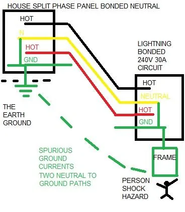

There is another path from the neutral to ground via your body if you touch the truck frame. You will feel a shock and if it is working, the GFCI will open. This is not theory this happened to someone whose electrical installer wired a dwelling under construction and disconnected the ground wire from the truck to the house.
Not having the ground from the generator (truck) to the load (house) panel is a no-no according the code if the house is a dwelling.
For $400 and a little time you could do it right using a Generac 6853 Transfer Switch.
The circuits being transfered have their hot and neutrals connected through the transfer switch so they are not bonded (grounded) to the panel ground when being powered by the generator (truck).
As per your drawing, the ground and neutral are bonded in the house panel and the same at the truck receptacle.
I don't see where is the potential for a shock hazard when touching the truck frame, if it is bonded to the ground and the neutral and it shouldn't have any electrical potential to ground since it's bonded at the house panel.
Think of it this way.
The neutral is a current carrying conductor carrying return current supply by a hot (phase) conductor.
Some of the current will see a path through the ground if the neutral is grounded at both ends.
That is just the way it is, I am not making it up or theorizing about it.
Someone with some understanding of split-phase systems might note that if the load is balanced there is no current in the supplied neutral from the Lightning. Yes, but...the chances that the house panel is a balanced load is practically zero. So there will undoubtedly be some current on the neutral conductor.
A balanced load in a house is a ideal goal - it minimized the resistance losses when no net current travels in the neutral - but it is practically unobtainable in a normal household.

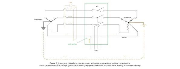

Here is some more info, FYI, which relates to the Lightning as a generator with a GFCI circuit:
Article 230.95 of the National Electrical Code® (NEC®) states:
“Ground-fault protection of equipment shall be provided for solidly grounded wye electric services of more than 150 volts to ground but not exceeding 1000 volts phase-to-phase for each service disconnect rated 1000 amperes or more.”
A common scheme for detecting ground faults is to use a current transformer(s) to monitor current flow through a circuit’s phase and neutral conductors, as shown in Figure 1. If the sum of current flow is other than zero, a ground fault is indicated. In that event, the ground fault sensing equipment signals a device to open the circuit to mitigate hazards.
[figure 1 omitted see the link if interested. chl]
Controlling Current Pathways
Accurate ground fault sensing requires that the current pathways are known. For instance, if a power system used two grounding electrodes simultaneously without other provisions, some current could return through earth without passing through ground fault sensing equipment, as shown in Figure 2. This would cause sensing equipment to falsely detect faults, causing nuisance tripping and affecting system reliability and availability.
Ford F-150 Lightning Working Pro Power using Generator Lockout Kit to Feed the Whole Panel 1722524621279-t8
For this reason, a switched neutral can be used in the ATS [automatic transfer switch. chl] to isolate the neutral of the unconnected power source.
For separately derived systems, manufacturers also offer transfer switches that switch the neutral conductor together with the phase conductors. Using a switched neutral isolates the ground conductor of the unconnected power source to avoid ground current pathway problems.
  • If the generator is located far from a service entrance, it may be desirable to install a dedicated grounding electrode near the genset to avoid energizing a long conductor during a fault. In addition, a cable cut along the length of the grounding conductor could leave a running generator ungrounded, resulting in unsafe conditions. Designers might consider using a dedicated grounding electrode near the generator to avoid these conditions. Again, a separately derived system may be warranted and a switched neutral transfer switch may be used.
    [NOTE: That is why shed or detached garages etc. have their sub-panels grounded with one or more additional ground rods, per the code. chl]
