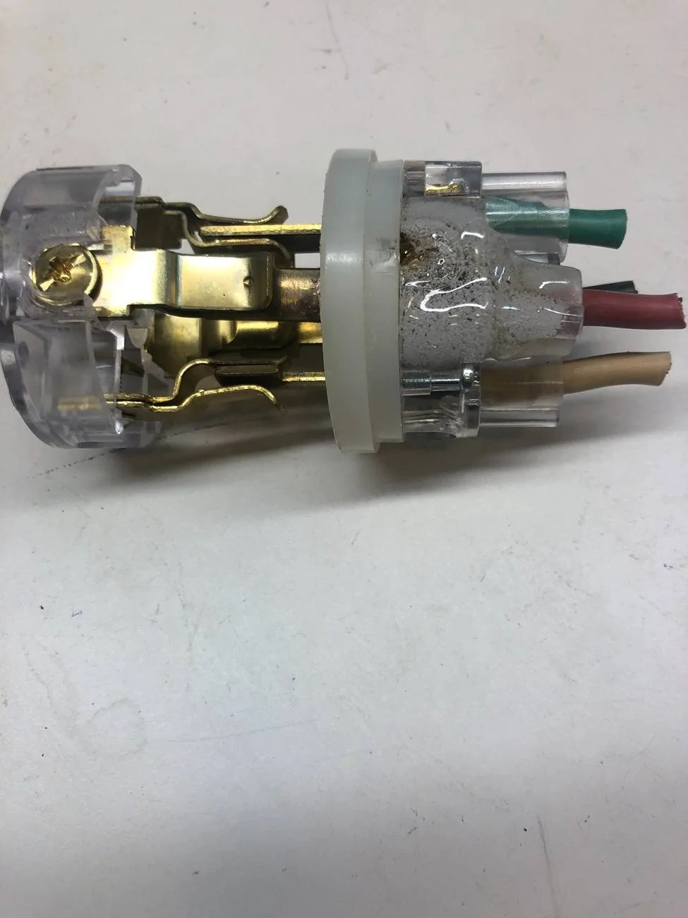

I posted the drawing in post #101 to show the shock hazard should the neutral connection become disconnected (failed) from an ungrounded power source.
The attached photo shows an L14-30 plug which went open due to rough handling. Although this failure was on a line connection, the open circuit could have just as easily been on the neutral pin. Prior work experience, and this failure prompted my "Show some love to your L-14 Plugs" post on this forum.
