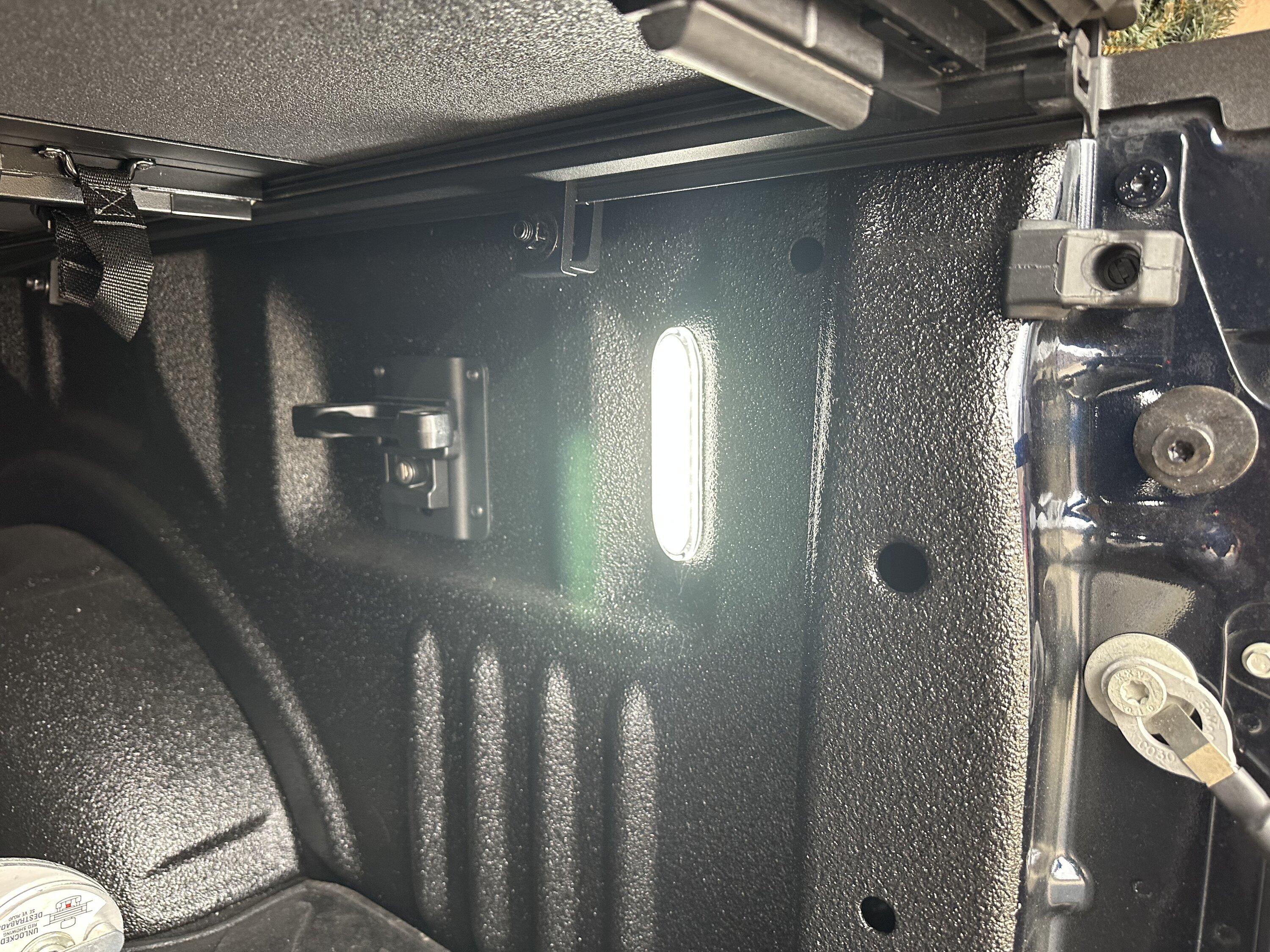

The lights seem to overlap slightly more the covers. But even without a bed coating they were a pain to pry out. I had a couple pry marks that lights covered up.
Well, I guess if I mar the lining while popping them out, the Line-X is covered by a lifetime warranty, right? I would hope Line-X would make it right if it came to that.
But, like I said, I have no particular itch to add the bed lighting at this point in time.

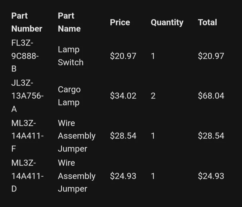

I world highly recommend the OEM parts. The LED color matches the rest of the truck perfectly. You are not saving much money by trying to go generic, below was my invoice.
Not to mention Zone Lighting integration, built in switch.
