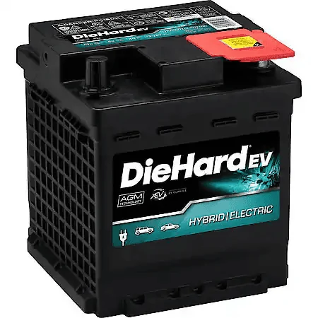

Once I'm off warranty or at least a few years out, I will consider switching to a deep cycle battery. Hybrid (at least toyota version) and all BEV really don't use 12v for "CCA". Think if their use more like a marine (trolling motor) or mobility (wheel chair, forklift etc). A BEV never needs lots of amps, but it is nice to have a tough battery that can handle time and discharges.
A Prius has some fancy AGM battery. Years ago, people figured out how to fit a cheap wheel chair battery in there. Its AGM too, but since the size is not proprietary like Toyota did, the mobility battery costs $65 and a proper Toyota $200. Both AGM......
My wife's Prius needed a new battery and we were shocked by the price tag - didn't know about the wheelchair battery at the time so we got soaked.
